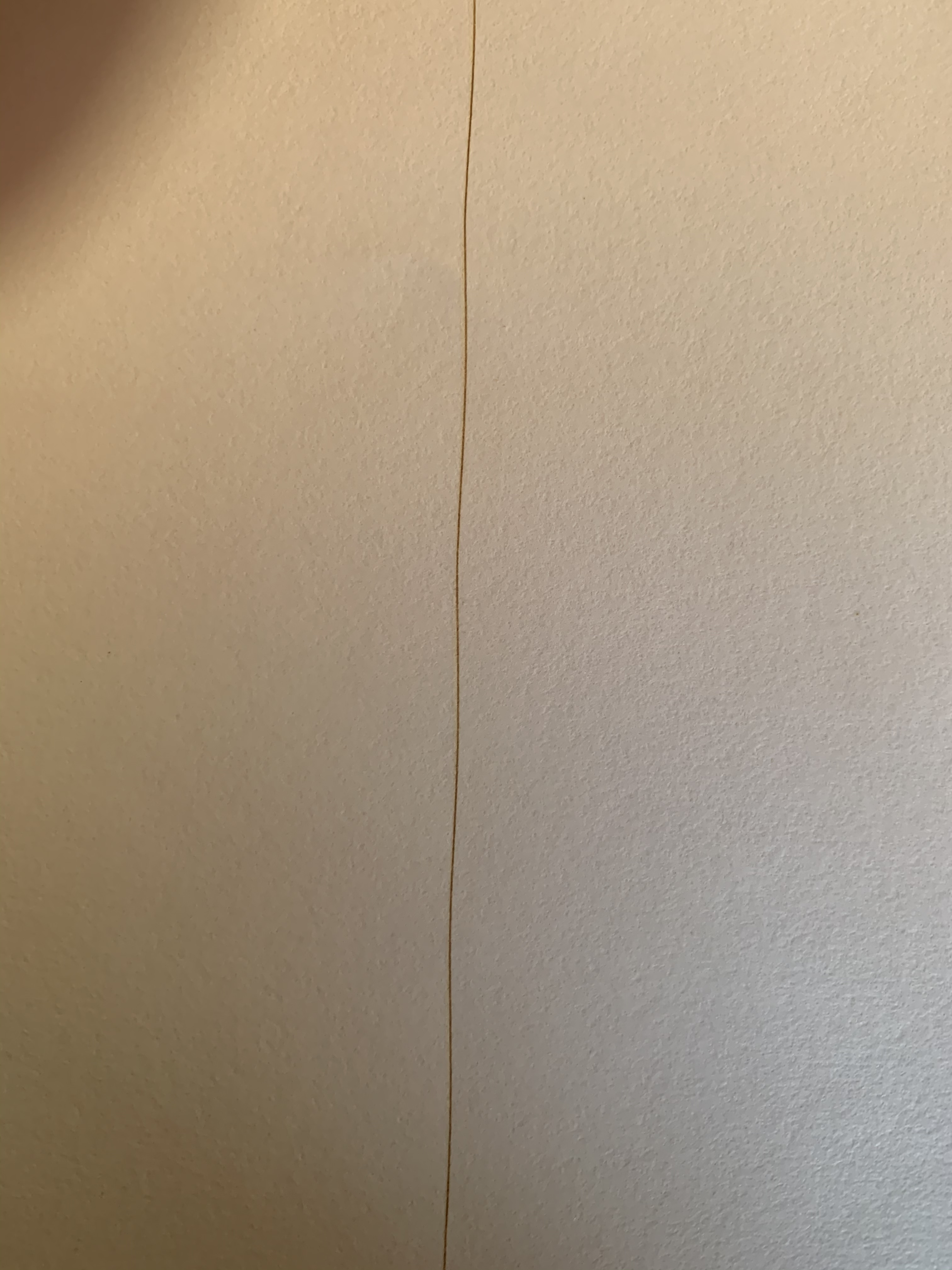

hi everyone, sorry to barge in on this thread but the above image is of great interest to me as it appears to back up my belief in what is causing a similar problem. I am getting wriggly lines being printed on my new K40, even when I print a straight line. I have cleaned and tightened everything I could find and believe the problem is that the lens carrier is too loose on the X axis rail. The assembly moves quite considerably, particularly at the rear (right hand side) rollers. I couldn’t find a way to tighten the rollers against the rail and the above pic seems to show that. The hex screws only hold the rollers to a fixed spot on the assembly and the assembly being cast doesn’t look like it is something I can bend in for a better fit.
Anyone had a similar issue with the K40 and a fix?

Pic of wriggly line (if I can post it) but looks like I have the answer thanks to next response
Thanks so much Ned, so simple but easily missed. Now to test it,
