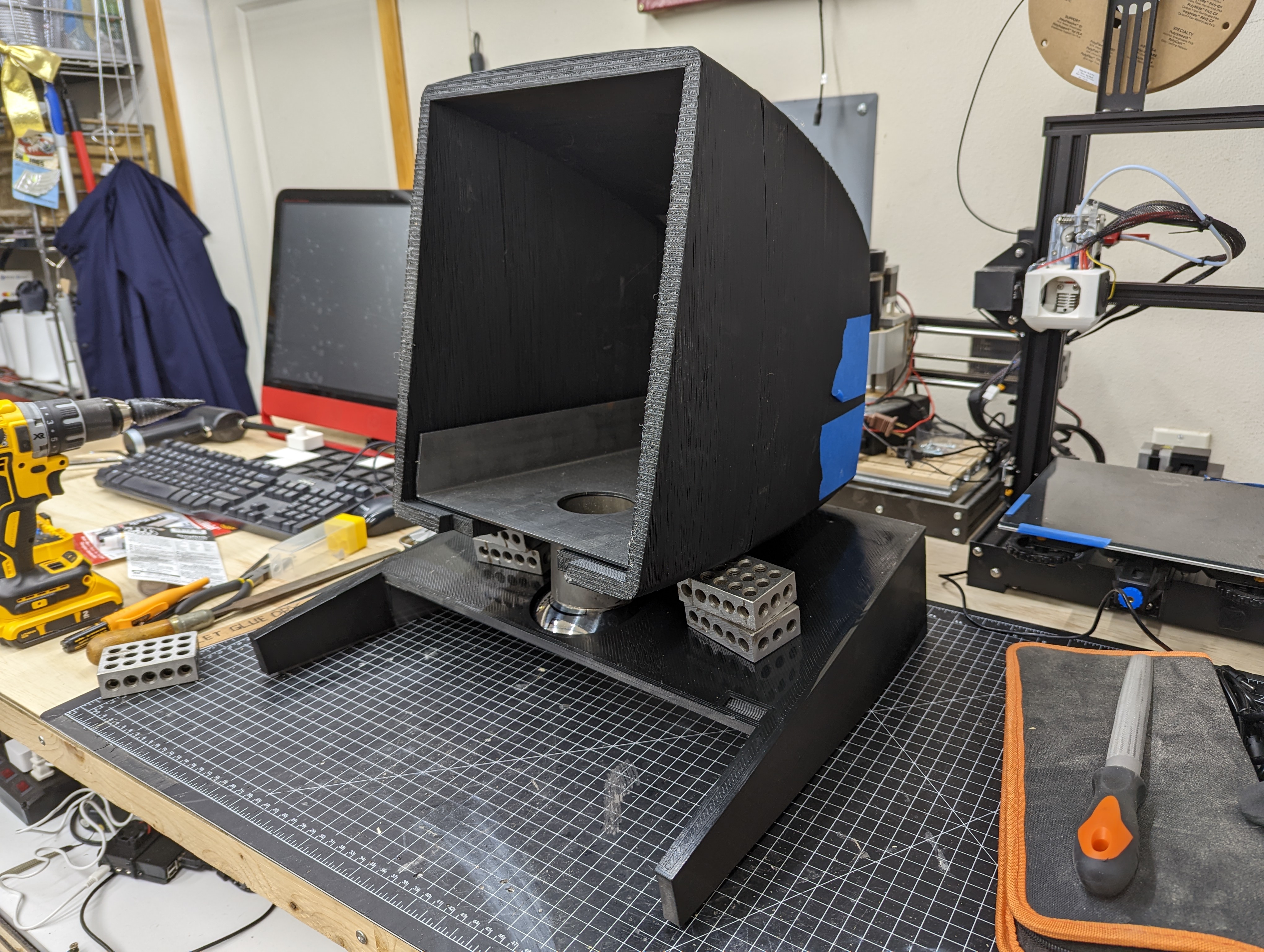

Anyway, yesterday I had my first dry fit of roughly printed test parts with the laser cut and bent metal frame parts.
Much work remains but it’s fun to directly see the overall shape of something from the early 70s that I’ve only ever seen behind glass or in photos.

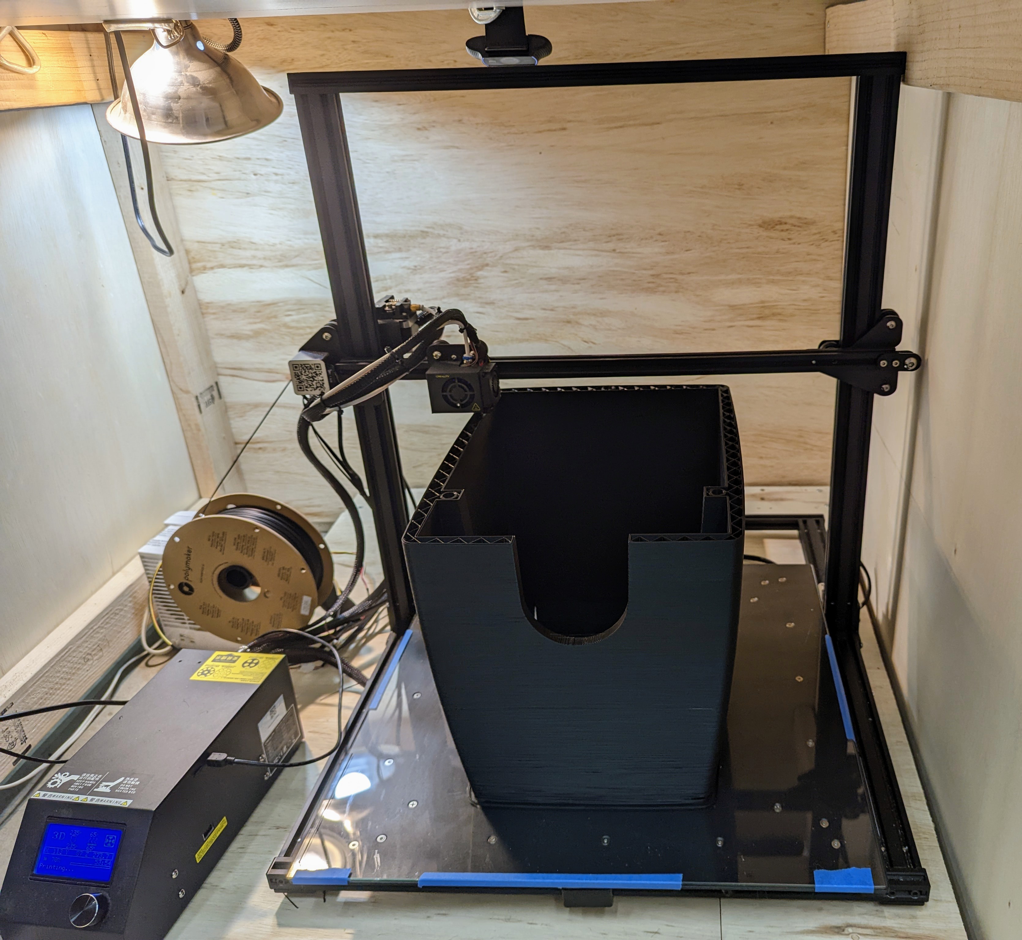

This display case print is the first multi-day test of my new heated enclosure for the CR-10s5 so the bottom few inches show layer adhesion problems. But, it’s now pretty well dialed in and seems to handle cold nights. I can still use this print to improve my finishing techniques.
I’m using a 1mm nozzle so there will be filler and a lot of sanding.

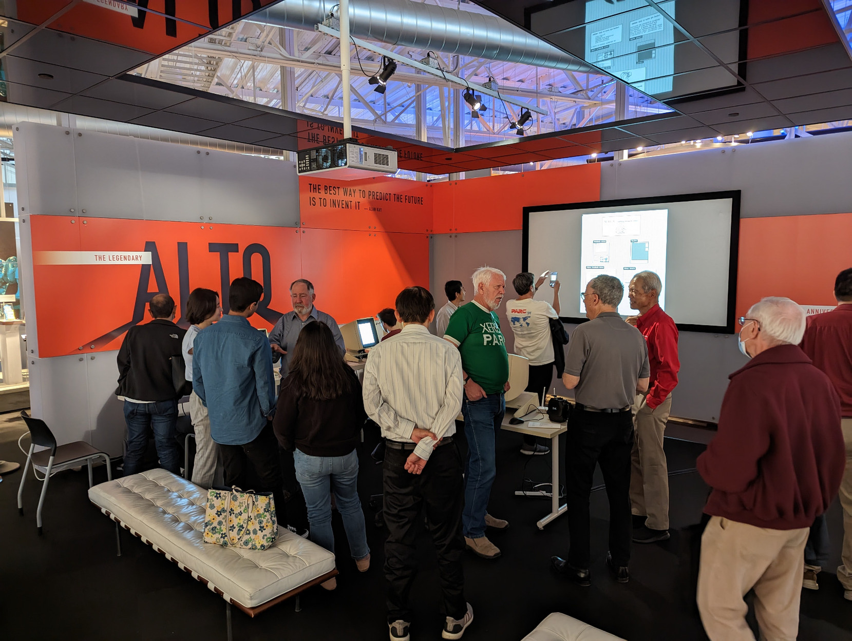

In the meantime I built six replicas, took them all to the Computer History Museum for a celebration of the 50th anniversary of the Alto, and now two of them live at the museum.
Here are a few photos of the event:

Dan Ingalls demoing Smalltalk:
Alto replicas waiting for the events to start:
Some of the original PARC folks trying to hack Contralto and the Alto Executive to see if their code is still in there: :smile:
