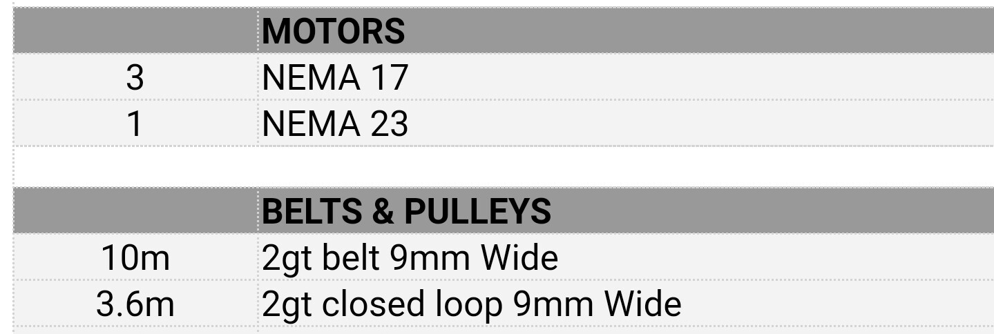

If it makes you feel any better we are going to build a Y-1200 next. Look at these requirements for belts…

I should probably be using 9mm belt in mine. But 6mm for proof of concept. I can buy 9mm pulleys and real Gates belt from Filastruder to upgrade. I’ll have to redesign a couple parts if I do that, though.
Does 3 NEMA17 and one NEMA23 mean that it includes a rotary?
No, two NEMA 17 on the y-axis, one on x-axis, and the NEMA 23 on z-axis. On this design, the y-axis is significantly longer than the x-axis.
