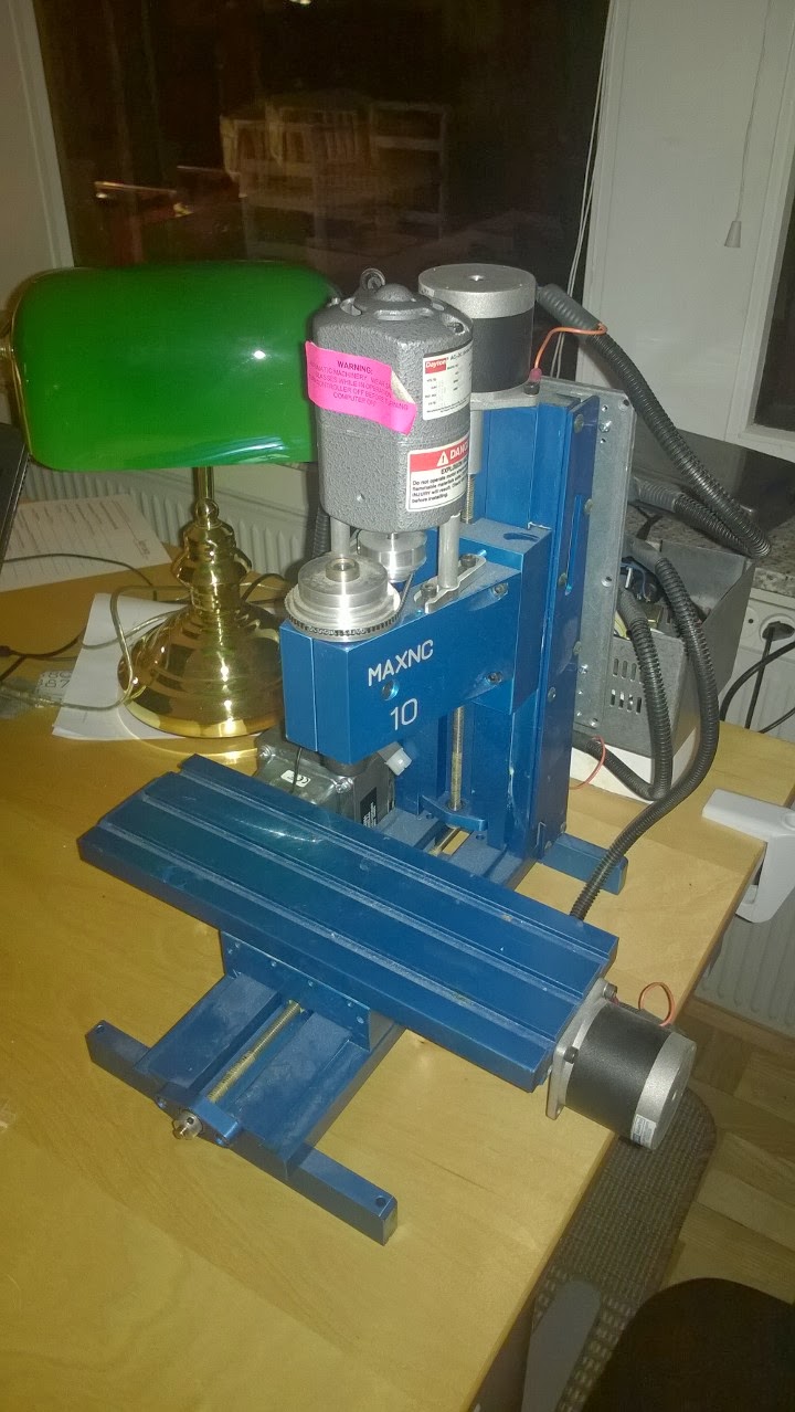

Yesterday I got my Max NC 10 to run a demo for me.
I first had to build it from 115V/60Hz into a 230V/50Hz. That was easy.
Then I had to find a PC with a parallel port. That was hard, because I first took a wrong path trying a PCMCIA pluggable parallel port on a laptop. That just didn’t Work, although I really tried. A week later, a friend came by with a laptop with a built in parallel port, and my Max jumped in action almost immediately.
Now Mach3 has been set up for initial runs and I saw the first run without a tool in the spindle.
Success…
But the Max is without limit switches, so i should really fix that first. Everything will be so much easier if Mach 3 knows the machine limits and some well known reference position. That is my next goal.
