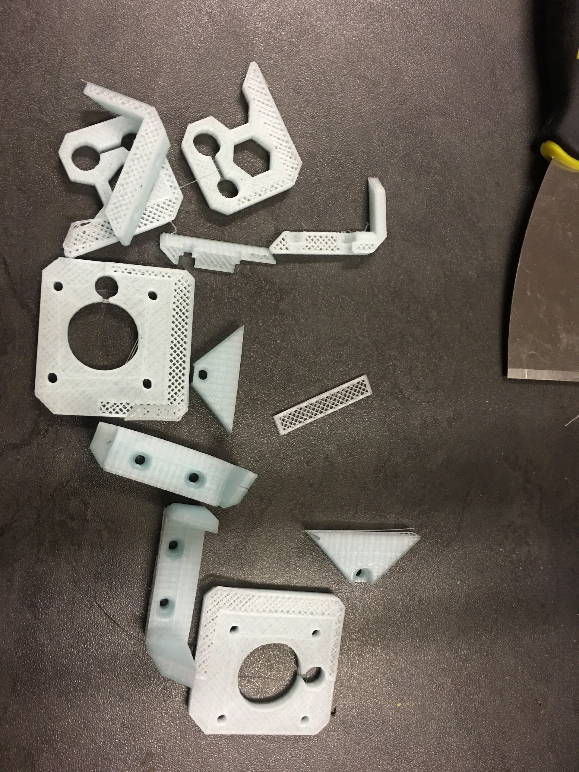

Yup still hate abs, 3 hours looked great till it came off and it’s rubbish.
What temp? Looks like your hot end was too cold.
Yup redoing it now hotter also hotter bed
Was 215 /70 will do 225/80

It’s hard to tell from the pic; but, it looks underextruded as well.
