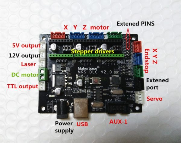

I downloaded this photo of the board from the internet as it is easier to see than any photo I can get. Toward the bottom of the left side is a two pin connector labeled “TTL output”. It cannot be seen here but the board itself labels the upper pin as “G” and the lower pin as “S”.
The yellow wire connected to “S” is connected to a terminal block that is mounted on another small circuit board. The blue wire connected to “G” is my problem. I first assumed that G was for Ground but I’m too chicken to just connect it and see what happens. When I first noticed that the wire was loose was just after disconnecting all the wires to the power supply so I could get to the micro sd card in the raspberry pi, hence there is a good possibility it was connected to ground.
Finally, this may all fall under the heading of “tape the end and leave it loose”. I say this because these two wires are yellow and blue and the only matching pair I can find in the build instructions are the PWM pair on the accessories connector. I assume these are for a laser, which I do not have, so it does not matter if the wire is loose (as long as it is not bare).
You can use a multimeter to find out whether G is ground. Seems likely.
https://github.com/makerbase-mks/MKS-DLC is… rather lacking in useful content here, as is https://github.com/makerbase-mks/Datasheet/tree/master/English%20datasheet and https://github.com/makerbase-mks/Marlin/issues/2
Connect the blue wire to ground. Trying to remember but seems this controlled spindle speed and laser. Yellow/blue
There was a white/black pair that goes to A3 this was for z ground/touch plate.
The rest are straight forward connections.

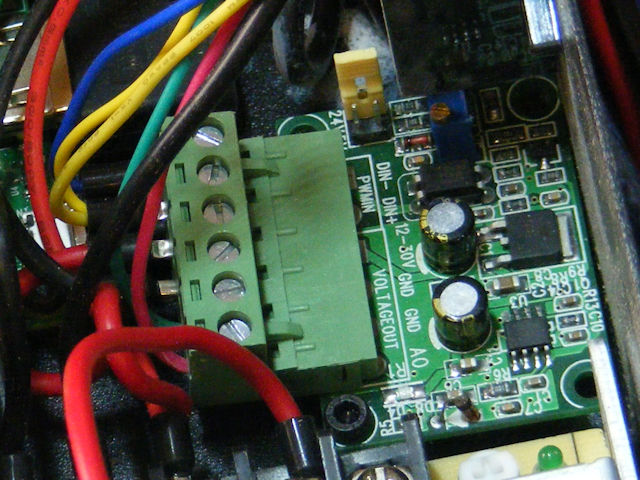

The photo below shows the board I believe you refer to as a voltage converter board. Here the two yellow wires are (1) from the TTL/S pin on the MKS board and (2) to the accessory connector external to the control box. The blue wire in the photo goes to the accessory connector as well.
Are you suggesting that my loose blue wire from the TTL/G pin on the MKS board should be paired with the other blue wire in the connection to the voltage converter board?

That board looks like one that converts a PWM (pulse width modulation) signal from the controller board to a voltage that varies based on the PWM signal, and that output voltage is an input to the spindle controller. A low voltage asks for slow spindle speed, and a higher voltage for a higher spindle speed.
Incidentally: VFD means Variable Frequency Drive and is used with AC or three-phase brushless DC motors; in your case, if there are three wires between the motor and the controller it’s a VFD; if there are two wires (typically red and black) it’s a DC controller that provides a variable voltage to the spindle.
I would expect to run the two lines from the spindle PWM port on the controller board to the converter board. The yellow wire should go from PWM+ on the controller to the DIN+ port in the PWM IN section, second from the left; the blue from PWM- on the controller to the DIN- port in the PWM IN section.
The OUTPUT part of the converter board looks like it has a reference voltage, two ground (separate from DIN-), and ouput control voltage.
