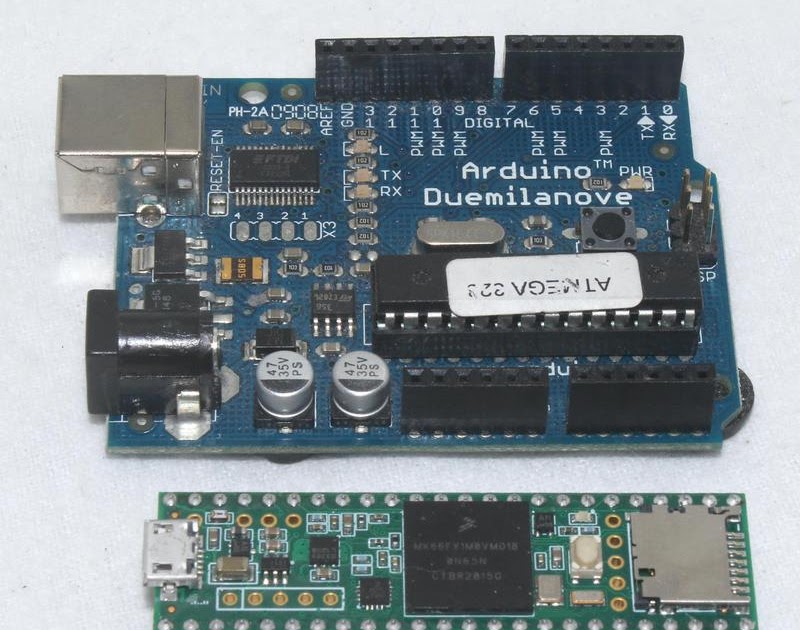

I got my teensies in the mail today, one 4.1 and one LC.
Looking at the pin diagram for the teensy LC, it looks like with serial tx and rx on pins 0 and 1, I have 25 pins remaining, numbers 1-26. It looks like all the pins support digital in, and more than 8 support PWM. Each motor requires 2 digital and one PWM connection. So could I run 8 motors from this one board? Are there other limitations or connections needed that I’m not aware of?

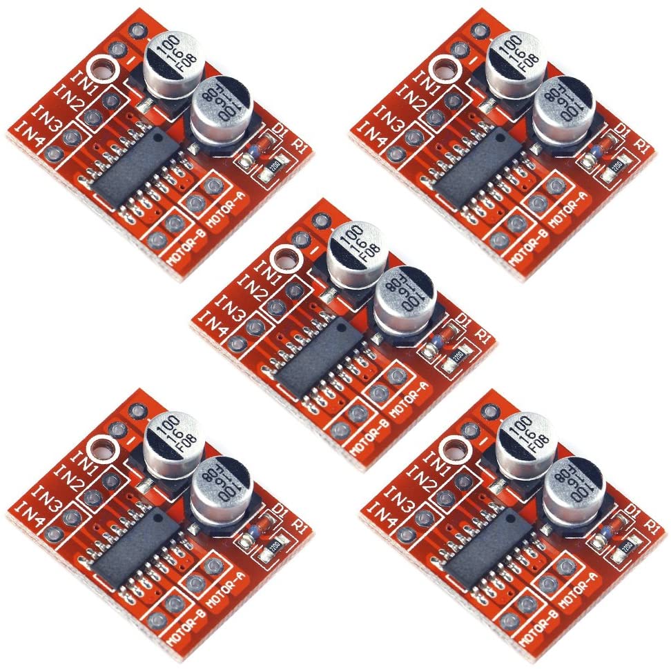

got the H-bridge in. Boy that heatsink is TALL. May look for another option when it comes time to build the instrument. But this will be fine for testing. Just need the motor now. Impatient!
I’ve used these little ones with the yellow geared motors and wheels… have a max1508 chip on them.
I recall somewhere these are limited to 10v. But they are also limited to 2.5A between the two motors. That would work with the motor I ordered, but the more powerful pololu motors are 1.5A at 6 volts. That said, they are probably around 2.5A between two of them at 10 volts… so maybe just fine. Pololu’s driver board above would also work, though pricier, maybe…

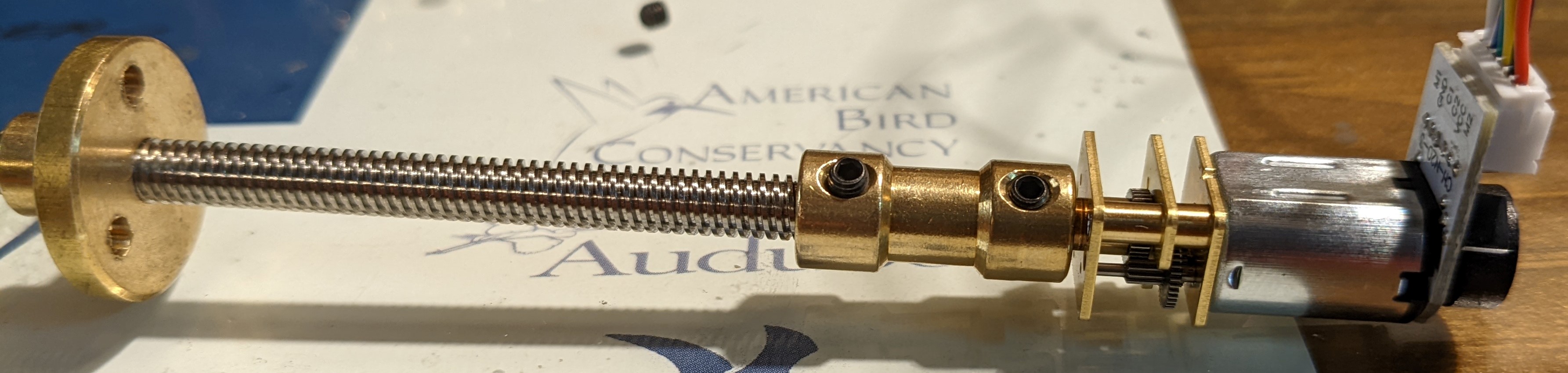

Alright, I got parts! Pretty cool to see it all put together. These motors are TINY!
First test. No way I can get the motor to move via pressure on the nut. So the device should not need any current to stay in place.
