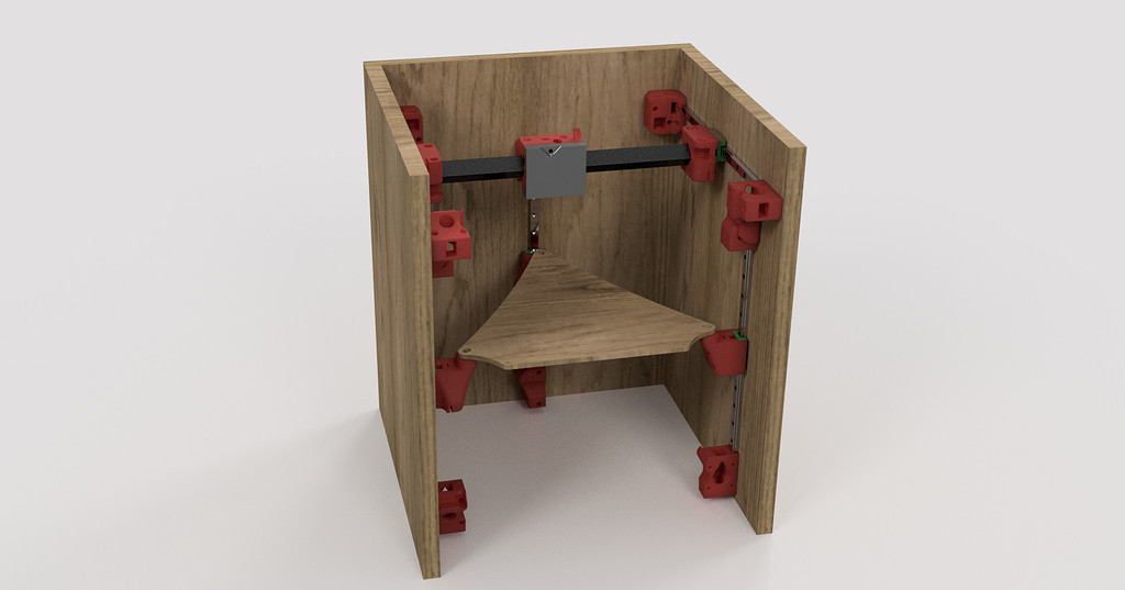

I don’t think I’d care for one with wood panels… Also, like the Rat Rig, lots of plastic components; I want to be able to print high temp plastics confidently so I’d rather not use printed structural components. I should have listed that, I guess I’ll go back and edit that in!

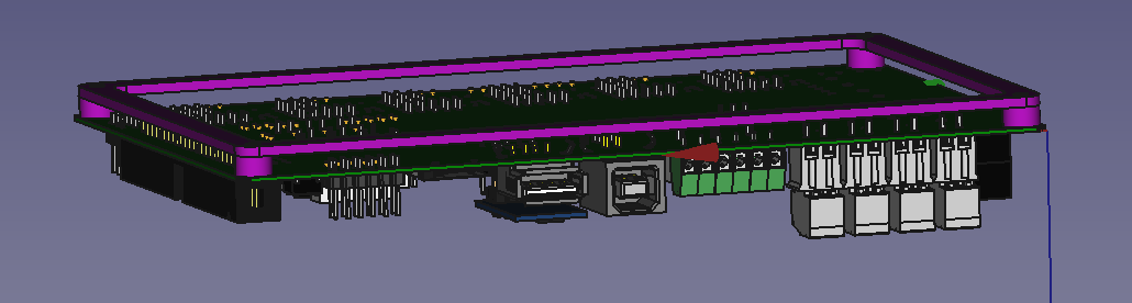

I’m thinking about how to make the frame also hold a duct for a fan to blow over the stepper drivers to keep them cool, but I haven’t figured that out yet, so for now I just printed the frame as shown.
