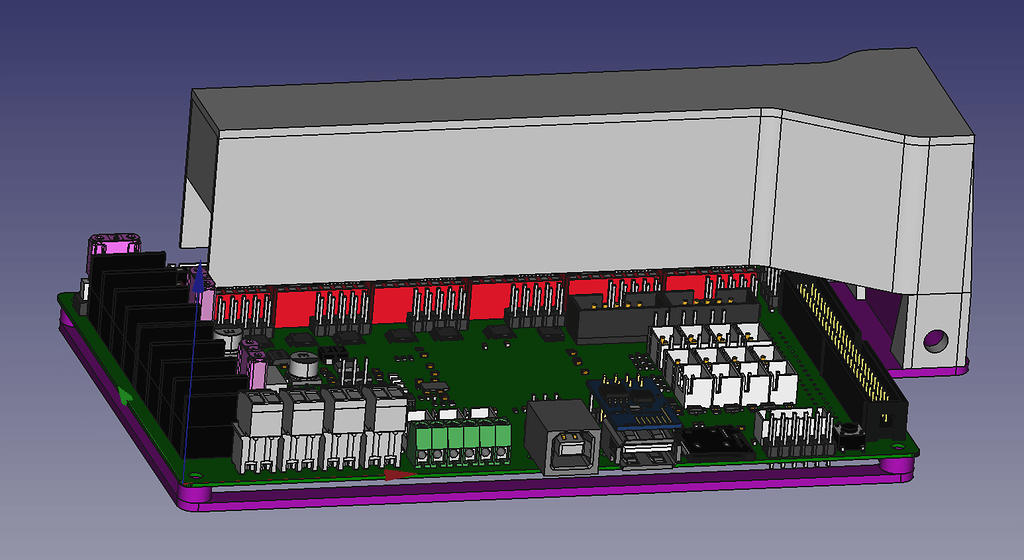

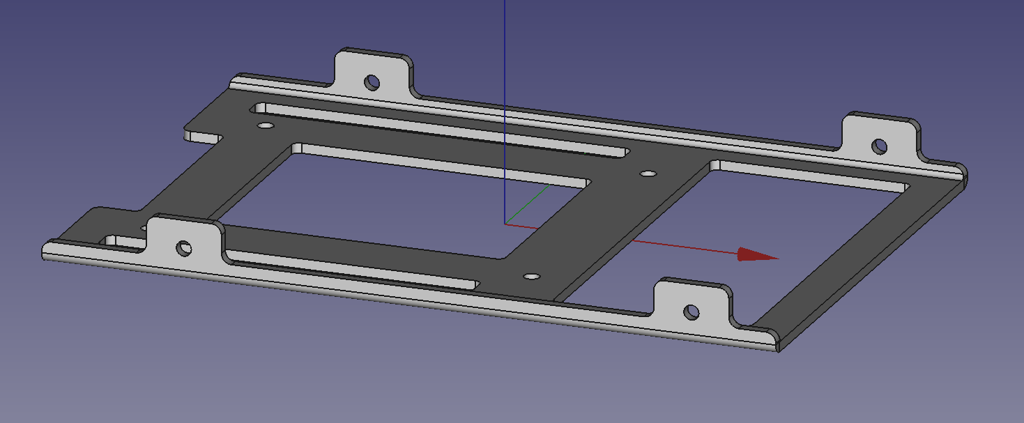

I’m trying out a fan duct design I made for the GTR board. It’s a mounting bracket and fan duct in two parts. The base is an integrated spacer and fan base, and above it is a duct. Together, they are designed to hold any 10x40 axial fan. Modeled around the board:
The hole at the right takes an M5 bolt.
There is meant to be enough space below the duct for free airflow and to avoid impinging on any wiring. I should be able to wire the board and then install the duct over it.
I haven’t modeled the fan itself, but it goes in this opening, here shown without the board.
The duct gets narrower as it goes away from the fan, and there is space at the bottom for air to flow out, with the idea that there shouldn’t be too much impedance, and fresh air hits all of the step sticks on the way out.
The triangular tangs at the bottom both hold the duct in position over the board and, at the bottom, capture the corners of the fan. I hope. Also it’s 39.8mm wide, with the idea that bolting it together will hold the fan in place. I’ll see how well that works. I could imaging the duct taking a couple iterations to work just right.
Nothing about this set is specific to the SK-Tank. It’s really just modeled around the BTT GTR board.
It is all designed to print without supports. The duct prints upside down.
It’s modeled in the realthunder branch of FreeCAD, and I plan to release the files once I test the print.
If you want control over the airflow at all 4 driver chips instead of a fully open bottom close it off, add holes above the chips and use a centrifugal fan for better buildup of air pressure in the duct.
The long open channel often results in far more airflow in the front or back of the channel and little in the middle.
It’s six chips, and I designed it for the fan that shipped with the kit. These are TMC drivers so they shouldn’t run terribly hot. Might not be obvious from the picture but the channel cross section gets narrower as it crosses all the steppers. I haven’t tested running it to see what airflow is actually like yet. But the delivered axial fan is understood to be good enough in practice, I’m just adapting to the new driver board.
It could be argued that I should close it at the end rather than taper only partially, but excess impedance is a bad idea for an axial fan.

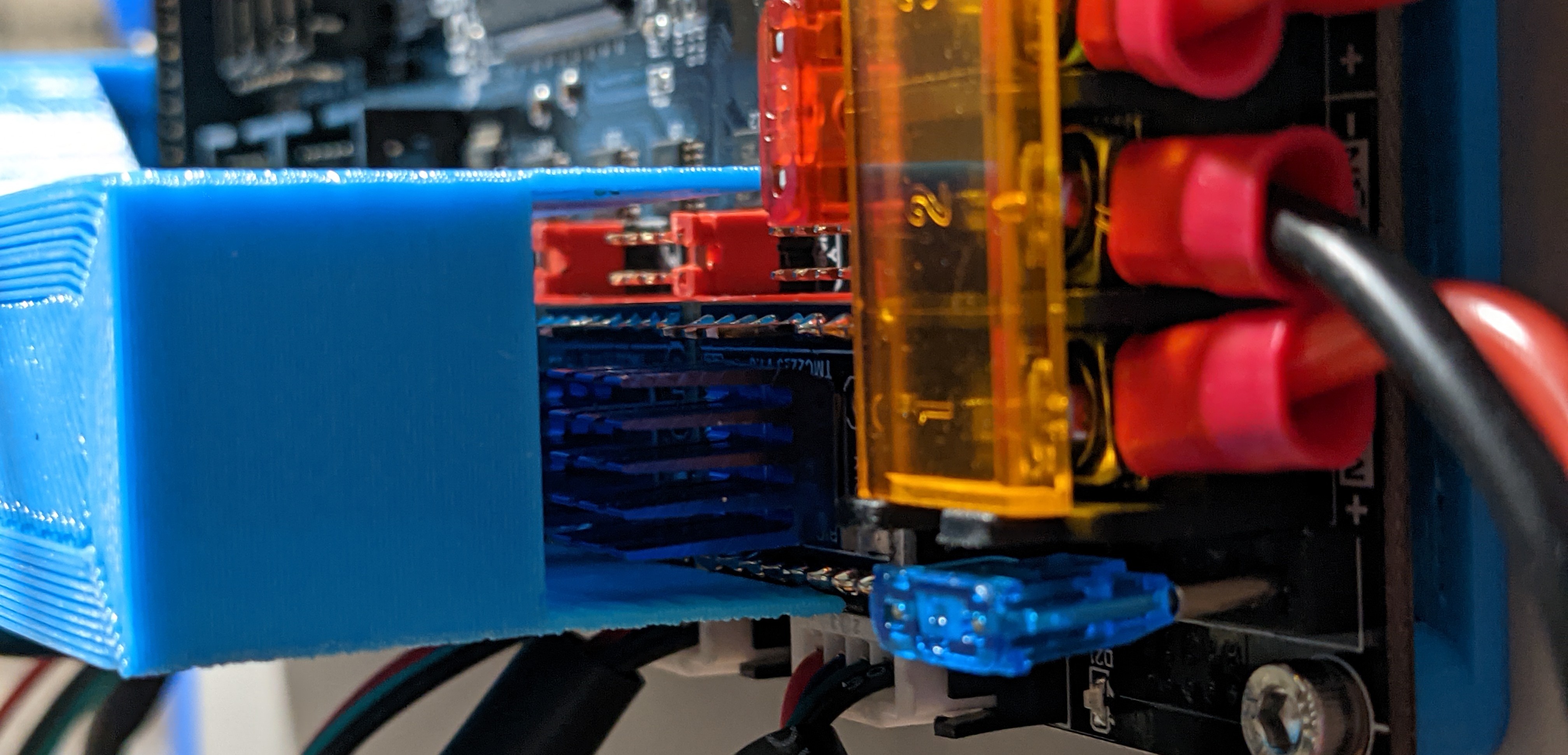

Did a quick airflow test, and airflow seems sufficient that I’ll probably run the fan below full speed. If I want it to be maximally quiet, I could figure out whether I can control it based on a thermistor or 18b20 I guess.
Here’s the small end, installed. It is 40x40mm at the fan end, but gradually tapers down inside to just big enough for airflow through the heat sink.

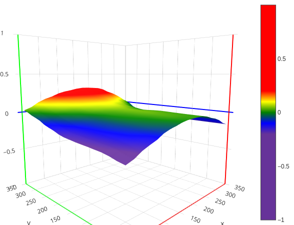

Here’s the bed mesh visualizer output:
newplot
Really complex curvature. This doesn’t look like, say, a twisted frame.

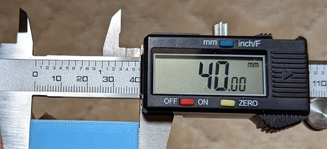

I went slow on the PETG calibration cube; only I think 60mm/s at .25mm layers. Because one of my kids has learned Cura, I switched from prusa-slicer to Cura to get a profile set up there for the PLA testing. I chose .2mm layers because it was in one of the default filament profiles, and I decided to go crazy and run at 200mm/s to start, because I wasn’t changing enough variables at the same time already. My youngest went to look at it zipping around and asked whether the printer had drunk too much caffeine. :relaxed:
Measuring the resulting print:
I’ve seen worse!
I got 39.92 mm on the other horizontal axis, and Z varies a little due, I presume, to the bed mesh compensation. All within acceptable limits at this point.

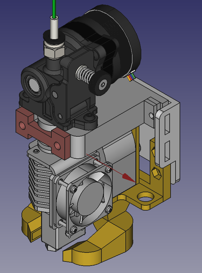

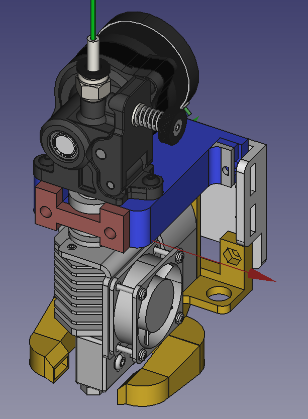

I’ve been designing a mount to put the orbiter extruder on the printer, using the BP6 heat sink instead of the E3D version, and using the 2040 radial fan tucked behind the hot end.
I think the hard part is the cooling duct. I finally got a cooling duct modeled that looks like it has a chance of printing with only rectangular, bed-attached support. A previous version really needed tree supports, but I couldn’t get cura to make the trees extend everywhere they were actually needed.
This design will let me remove the heater block from the heat sink just by loosening two easily-accessible screws. I have replaced the M3 grub screws with normal M3 screws long enough to just barely stick out past the fins. I didn’t bother modeling that part.
The orientation of the 2040 fan here forced me to put the inductive probe on the right side of the head.
I could move the bed back where it was designed to be by moving the filament path closer to the carriage; the orbiter here is entirely above that path. But that would force me to find another solution for the part cooling ductwork. Perhaps I could lay it down flat. But I think I’d like to try this first.
If it works, I’ll publish the files.
The hardest part (I suspect), the duct, printed successfully. 13 grams in total. And when I pointed my heat gun at the intakes of the ducts to get rid of PETG frizz, I put a finger between the nozzles and definitely felt hot air coming out, so the impedance shouldn’t be too bad; cooling ought to work.
I’m now printing the other two pieces, but am also confident enough to post the files in the current shape.
The README has printing and installation instructions.
I have assembled it except for the fan, and the heat block. 240g for the plastic, stepper, heat sink, throat, nuts. Could be worse!
When I installed it, I found that the volcano model or the BP6 model i was working from didn’t match what I had, such that the bottom of the duct was approximately co-planar in XY with the tip of the nozzle. That won’t work!
Additionally, two of the holes I was going to use to attach the duct to the carriage are blocked by the linear rail from attaching in the back and aren’t necessary anyway.
So I cut down the mounting bracket and raised the ductwork. That will also shave a few grams off the final print.
It moved lots of air, so that part isn’t a problem.
Of course, with this now installed on the printer, I can’t use this printer to re-print its own part, so I’ll print this on the other printer. :grin:
Edit: I took a rasp to the bottom of the original duct and it works fine as is. I’m still printing with the original, but expect to eventually replace it with the improved model.
