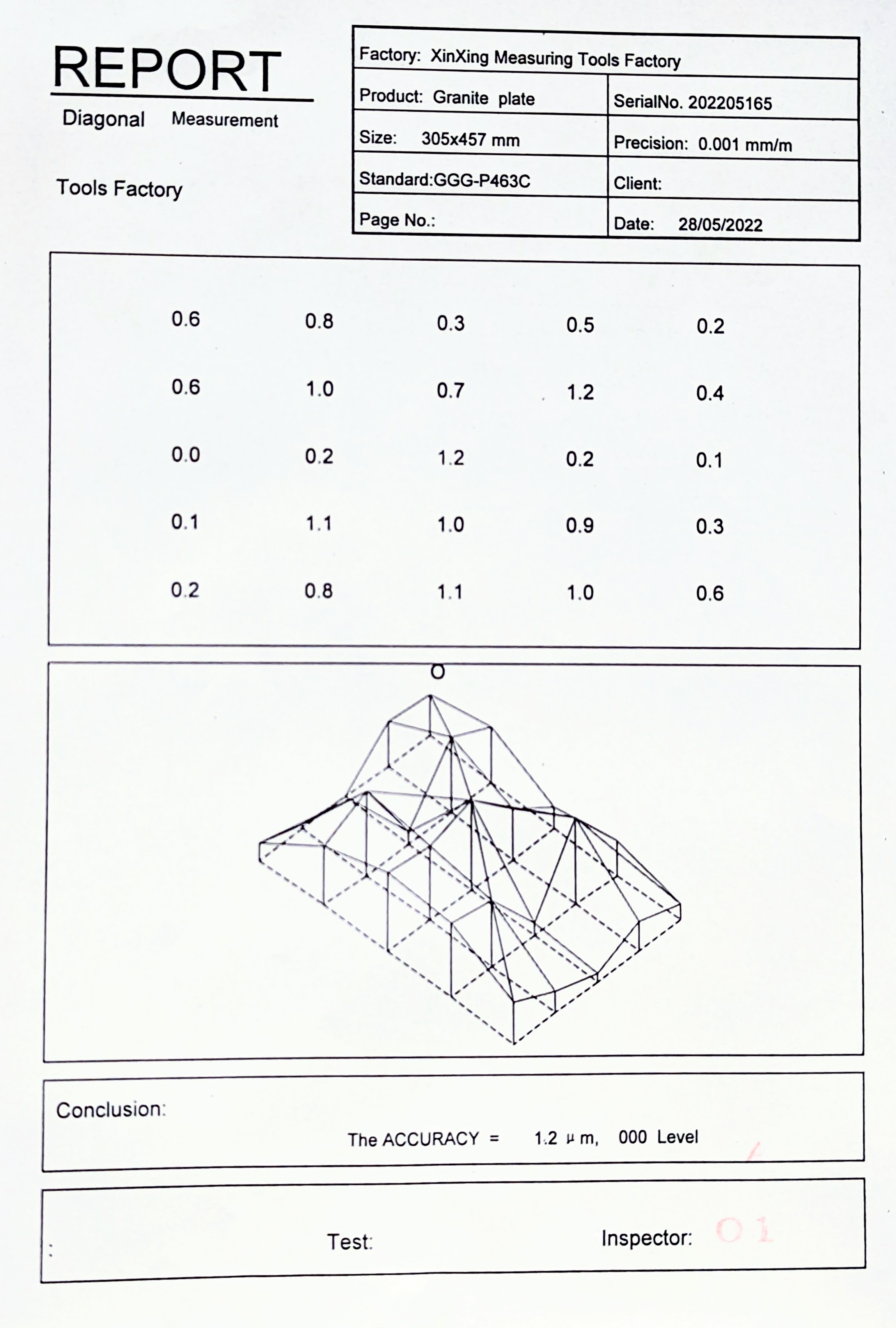

When I ordered it, it said it was in stock. A few days later, they notified me that it was not actually in stock, oops. A few days shy of half a year later, it has shipped to me and I have a UPS tracking number.
This is long after I realized that I don’t need it for this purpose, but on the other hand I do actually want a bigger surface plate in my basement machine shop. So, OK I guess?
It came with a report claiming 1.2 microns unilateral variance. I’m guessing from laser interferometry; not sure how else you would get it this cheap.
If that’s an accurate and representation of the surface, then it would be within the definition of a Grade A surface plate. But 25 samples on a 12x18 surface plate doesn’t sound like much to me, so while it’s good enough for my purposes, I don’t think that (e.g.) Starett has anything to be afraid of. :relaxed:
What’s really fascinating to me is that it looks like they could have claimed better. It’s not relative to the bottom. Unilateral flatness is just the minimum distance between two parallel planes such that all the surface points lie between them. If their test points were representative, it seems clear that they didn’t optimize the planes for minimum reported unilateral flatness.
Anyway, good enough for this hobbyist! :relaxed:
