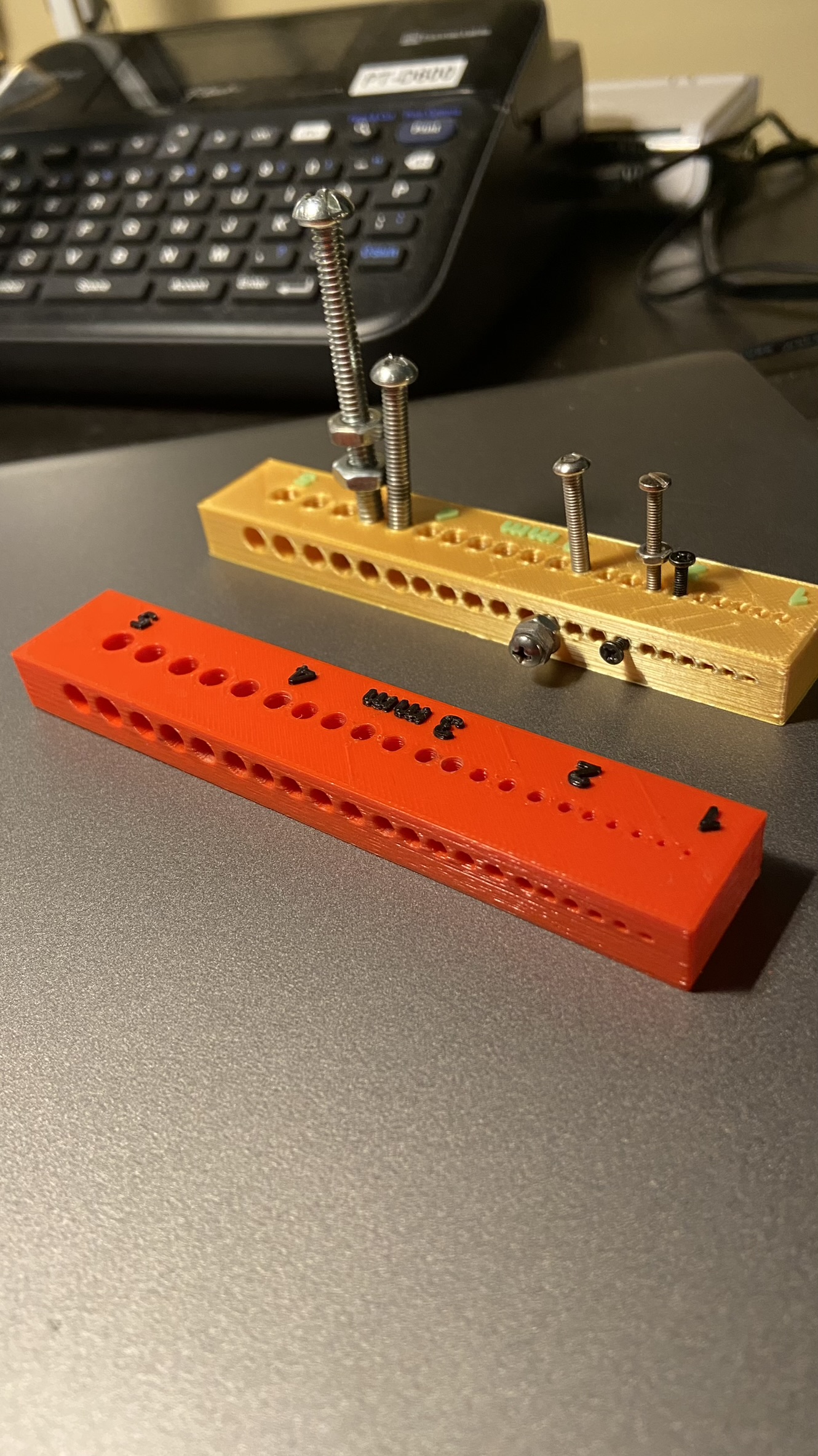

When I first got my Prusa Mk3S and began using FreeCad for small mechanisms, I realized that hole diameters were off a bit. I noticed that vertical (z axis) holes were slightly better than “cross axis holes” (X and Y axes), so I printed this proof block to test fit various machine threads, both metric and imperial:
The block has both vertical and cross-axis holes from 1 mm to 5 mm, every 0.2 mm. For each thread size, it simplified picking FreeCad diameters for (1) loose clearance, (2) tight clearance, (3) easy self tap by the machine screw, and (4) tight tap (run a tap through before assembly). This block should be printed with the same nozzle and extrusion diameters as the target print. For my purposes I use a 0.4 mm nozzle and 0.2 layer height. .stl attached:
Holes-Block with Holes.stl (1.3 MB)

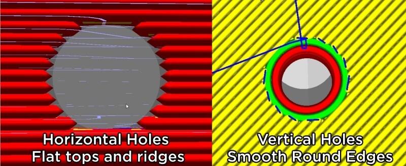

As you probably know, the variations you see between vertical holes and horizontal holes are because the slicer has to start and stop perimeters on the horizontal holes and so there is the extrusions rounded ends to compensate for AND your retraction capabilities also come into play as the pressure in the nozzle will be released as the extruder is stopped and moved to the next position.
On vertical holes there is a continuous extrusion motion and then a very slight move to the next perimeter.
And for accurate holes you always want to print the inside perimeters first. The reason being the first perimeter will be the most accurate and hopefully get a little bit of time to cool and solidify before the adjacent perimeter is put down. That 2nd perimeter will put pressure on the side of the previous perimeter as the rounded extrusion’s gaps are filled with the plastic from the next perimeter.
