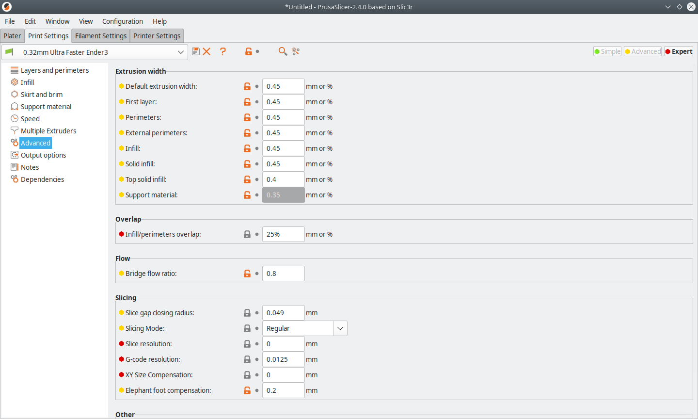

Here’s how I set my Prusa Slicer settings for my Ender 3. I’ve been setting my own extruder preferences for years since I was not happy with Slic3r defaults when just setting the hotend extruder diameter. I use .45mm because FFF extruders work well when there is pressure at the nozzle end and you don’t get much pressure built up when you try to extrude a .4mm line out of a .4mm hole.

FYI, these settings are for an Ender3 with Hatchbox PLA which I calibrated to produce engineering quality results for PPE manufacturing during the early months of the pandemic. A local nurse was providing 3D printed PPE to local hospitals(including her own) while they had none. I had 3 3D printers operating almost 12 hours/day for about 2 months.
Note that extrusion width less than nozzle hole diameter will consistently provide terrible results. Extrusion width should generally be meaningfully larger than nozzle hole diameter.

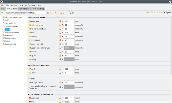

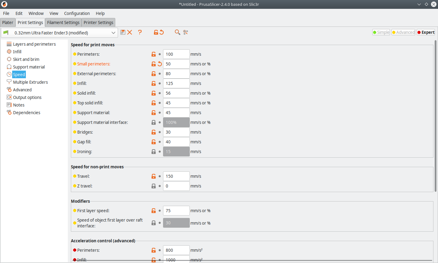

If you look at the Print Setting->Speed you will see a setting for Small perimeters and while I had mine set to 30mm/s the default is 15mm/s and I too once used percentages for many settings but found things were not linear as filament density varied(due to color pigments) and elasticity and viscocity varied enough that I have saved config settings for different color filament even from the same vendor.
Sounds like you are happy with under extruding and using extrusion widths well below the nozzle diameter. If you’re getting acceptable prints that’s great, we can just provide the why that’s not done in the industry and some of the reasons why. Keep on making stuff.
