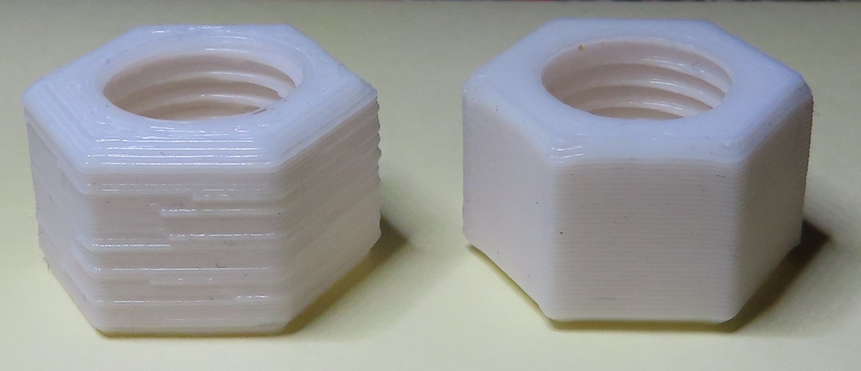

I agree - copying someone else’s settings may not be the best idea… I was dismayed at the fact that - after following Doug’s advice, my prints of parts that I have printed before are actually coming out looking pretty awful compared to parts that I have printed before, and the/inner outer diameter issue has not gone away - even though my single perimeter prints are now spot on. The parts are coming out with zits and blobs everywhere even though I am retracting 5 mm on every layer change.
Then I looked at the box of (new) filament that I had been using - PLA+ not PLA (bought on-line assuming its PLA), The manufacturer of this PLA+ recommends a higher extrusion temperature 220-235 degrees C and platter heating - 75 degrees C.
I have not tested this, but the pigments are likely to have an effect on the extrusion properties of the filaments. The white in white filament is Titanium Dioxide, black is probably carbon black. these additives are likely to have effect on the extrusion properties too - which means that you have to have a different filament profile for every different color of filament even if it’s the same material and nominal dimension.
As mentioned before, these things don’t normally affect figurines, etc… but when you want your 3D printed threads to fit - say - a standard bolt, then you are constantly wondering where that extra 0.01 of a mm came from. I can compensate for holes in FreeCAD easily enough, but threads…

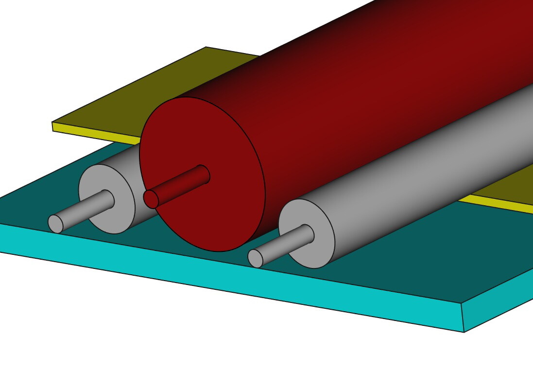

Not well annotated but the above is what I am building… The big cylinder (red) is 100 mm in diameter and is supported by 4 evenly spaced 96 mm PLA hubs (original post) inside the cylinder which take a 12 mm shaft. You may now understand that the holes in the hubs need to be precisely 12 mm and precisely centered, and the OD of the hubs need to be round and precisely 96 mm in diameter.
The large cylinder is driven by a 3/4HP motor and a pulley arrangement that reduces the speed but increases the torque. I can confirm that this arrangement is working well. There is not a great deal of heating.
The work (yellow) is fed underneath the sanding drum and only a fraction of a mm is sanded off at each pass. But without the support of either a conveyor or some in/outfeed rollers it’s difficult to stop the work from being pulled under and shooting out the other side. Also, if the work is not fed in evenly the sanded surface will come out rippled.
Therefore, I am currently building the in-feed and out-feed rollers. They consist of 2 lengths of 50 mm PVC pipe covered in rubber with a 12 mm threaded rod axle through perhaps 4 or 5 PLA printed hubs evenly spaced within each PVC pipe. The rollers will be driven by geared DC motors.
The advantage of the feed and outfeed rollers over a conveyor belt (like the ones that commercial machines have) is that the rollers will hold the thin veneers flat as they pass under the sanding cylinder.
I know what you are thinking. Only the most foolish of Makers would tackle such a job, but I think (well, hope) that it will work… I am hoping to build on the success of the sanding cylinder, and if it fails, I can always use the rubber coated PVC in/out feed rollers as the driving mechanism for a conventional conveyor belt. When done, the whole machine should only have cost me 3 times as much as commercially available machine ;-). But I will have had 10 X as much fun building it.

Things were getting out of hand so I went back to Slic3r - specified 0.3 mm layer heights, and told it that the Filament Multiplier is 0.8 as previously calibrated - I left the different printing widths at either auto or default.
It seems that the print quality using the “sane default” extrusion widths that Slic3r calculates (Picture Right) is much better than the print quality using the 0.45 mm extrusion widths I was specifying in Prusa (Picture Left). I guess that the Prussa defaults would be equally good. As I said, I learnt a lot.
Here is something from the Slic3r website on how they calculate the default/auto extrusion widths.
Slic3r Manual – Flow Math
The one on the left is not calibrated / tuned properly as no way is that an acceptable result. Something or somethings are not right. For one, a 0.8 ( 80% ) for the extrusion multiplier is crazy out of spec which is another indication something is not right. The extruder multiplier is typically fine tuning in the hundredths and thousandths of a percentage point or maybe 1% at most. Had you noticed for one of my filament settings in the config bundles the filament diameter was 1.77 instead of 1.75? That too is part of the calculations involved in making a consistent plastic track of plastic.
Also, I would never print at .3mm with a .4mm nozzle unless it was for testing purposes and/or the object wasn’t needed precision elements like holes, etc. I did it for the PPE since they were for visor/face shields to fit onto the head(flex fit) and punch hole clear sheets split across 3 or 4 pins on the visor. .2mm layer height or less for anything needed accuracy and for strength I will sometimes tilt the object so the layer lines are not in the shear plane.

It’s the only way I could get the 0.45 mm widths to print on spec on the single perimeter calibrators. I don’t remember now what my layer height setting was when I printed the calibrators, I THINK it was 0.4 or even 0.45 - maybe the printer/slicer can’t cope with 0.45 width and height?
Doug, note that 0.3mm is my layer height not the layer width. 7 days ago you sent us a screen shot of your extrusion width settings (0.45 mm for the most part). What are your layer height settings when you use those width settings? A couple of days later you said that you have set the layer height as low as 0.2 mm. Slic3r defaults to a layer height of 0.3mm (the reason I used it) and if I remember right Prusa recommends anything between 0.1 and 0.35 for a 0.4 mm nozzle.

a .4mm nozzle diameter can ONLY print UPTO 80% its diameter for the layer height.
So a .4mm nozzle can not print a .4mm, or worst a .45mm layer.
Again, I stick with .2mm layer heights most of the time and anything above that will get you less quality but faster prints and surely one would not pick low quality modes to do calibrations.
If you want a rule of thumb with .4mm nozzle
.1mm layer height for high detail/fine detail prints, longer overall print time
.2mm layer height for normal/good detail, avg overall print time
.3mm layer height for low detail/coarse detail prints, faster overall print time
.32mm MAX layer height( 80% of .4mm nozzle diameter )
