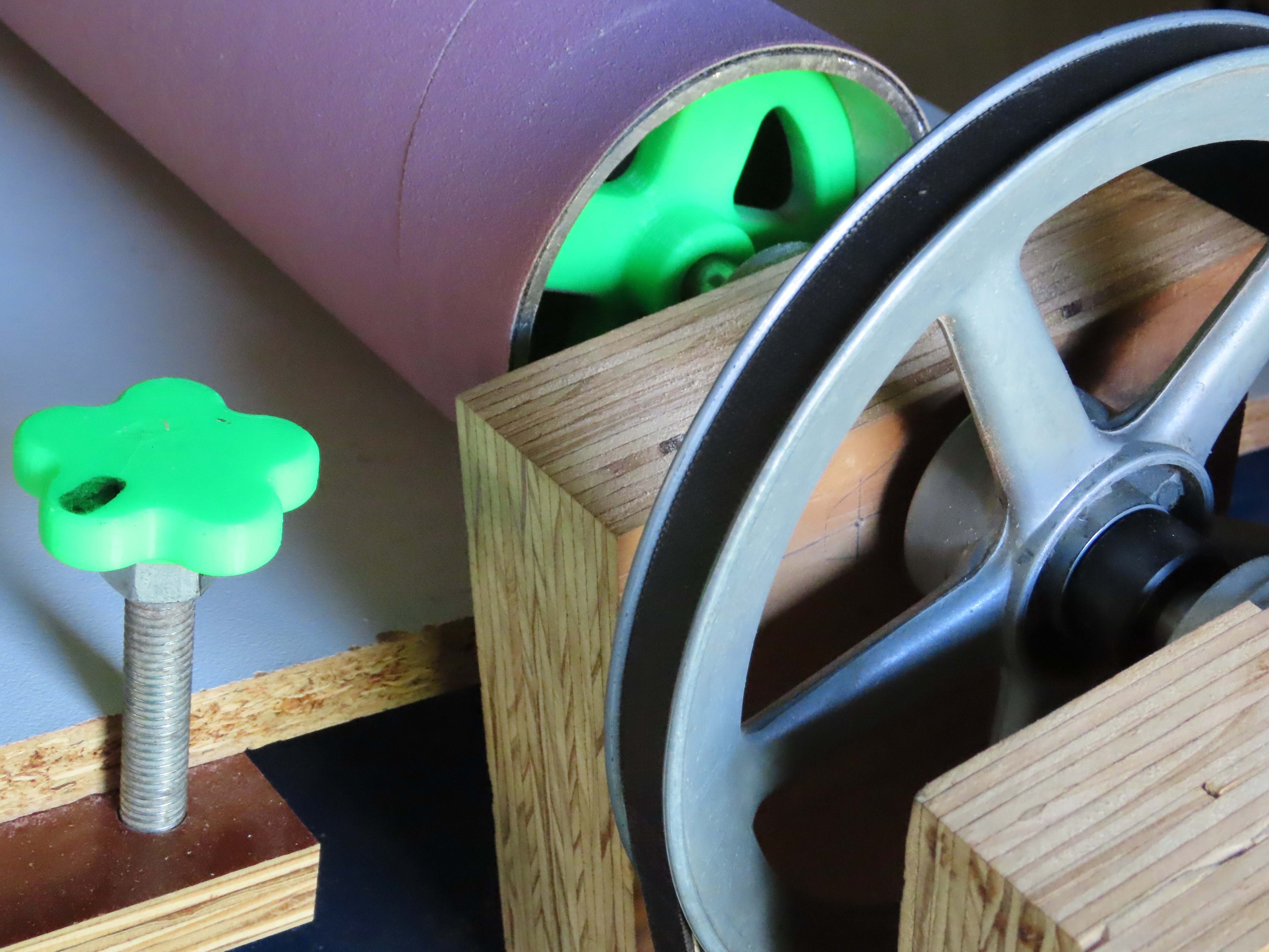

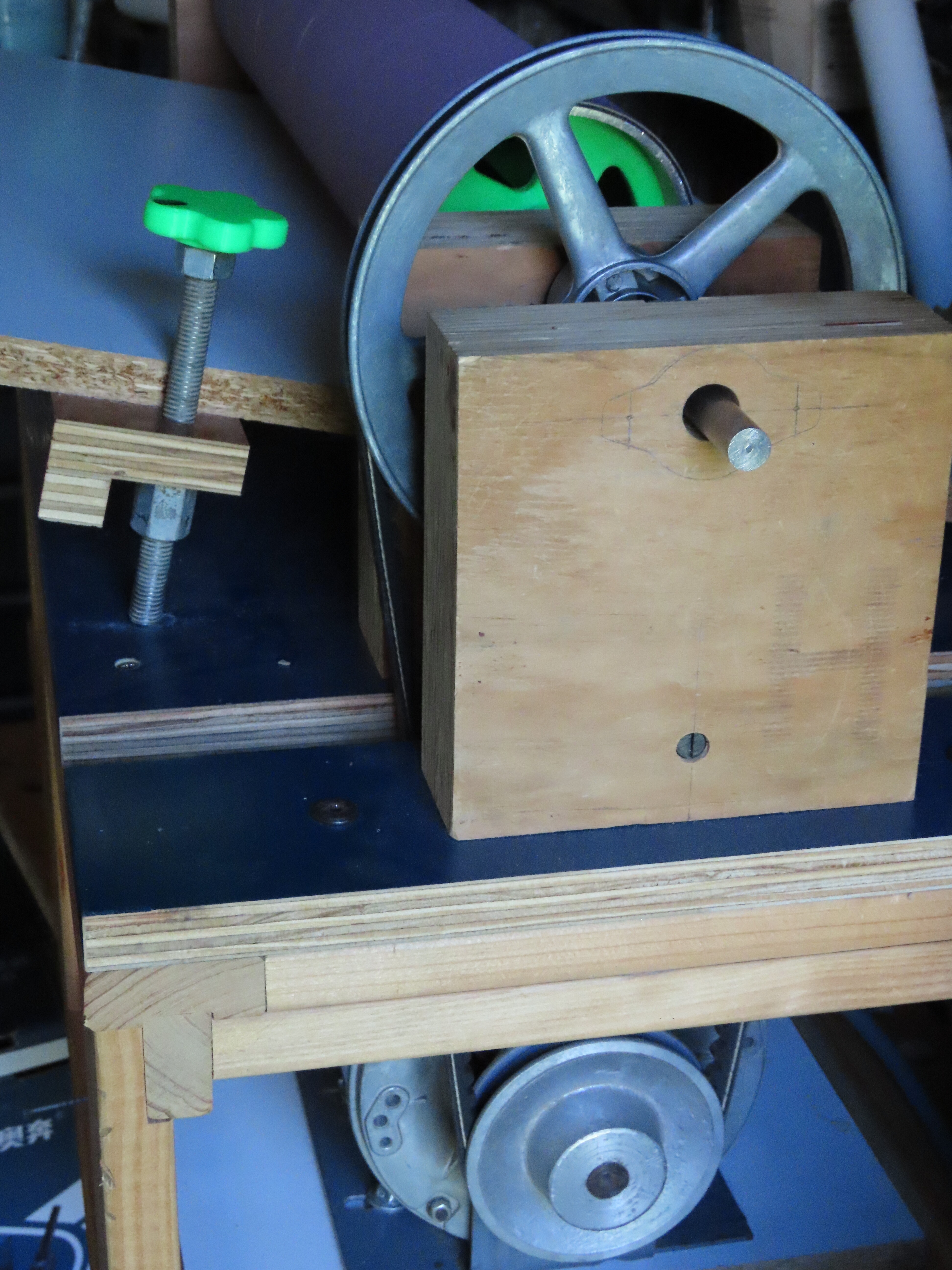

It seems that my project has sparked your interest (I appreciate it) - I hope that these pictures make things clearer - Note the 12mm smooth steel axle going through flanged bearings (hidden from view, inside the laminated timber blocks) and the Green PLA 3D printed hubs. There are four of these, spread evenly inside the cylinder.
I tried a few different designs for the hub locks, and settled on grub screws, but I am not entirely pleased with that. For the infeed and outfeed rollers I would like to try threaded hubs with lock nuts. Mainly because I have 2m of M12 all thread in my workshop that I would like to use for something. I intend to make some spacers and have the M12 axle run on bearings as well.

The sanding drum has a 12 mm steel rod axle and runs on flanged bearings
I am using M12 all thread for the in/outfeed rollers because that’s what I have lying around in my workshop… It too will run on bearings after fitting spacers. There are other reasons why I want to use the M12 all thread and threaded hubs.
Using a drill press to increase the diameter of the hole in the hubs those holes acentric and introduced wobble. I don’t expect that this will be a problem when using the tap to increase the tolerance of the M12 thread.

PS: @mcdanlj I finished the thickness sander and it works a treat! I now have enough 2 mm wood veneer (sanded from 3-4 mm) to make several ukuleles and lutes. The sander relies on several 3D printed parts with low tolerances on diameter and other dimensions.

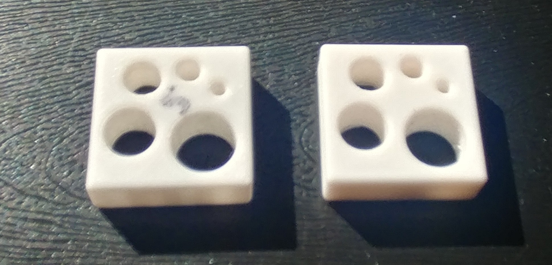

Update on calibration experiment CURA vs Slic3r.
Summary of results:
In order to tests the hypothesis that the diameter of holes in 3D printed parts are more accurate when the GCODE is generated using Cura, I 3D printed two calibrators. The only difference between them was the slicing software used to produce the GCODE (Cura, vs Slic3r).
The X-Y accuracy of a rectangular printed part was slightly better when sliced with Cura, but the accuracy of the diameters of 2-10 mm holes was not appreciably different between the two slicers. The 2 and 10 mm holes were more accurately printed the 4, 6 and 8 mm holes were appreciably undersized . The latter result suggests that registration tolerances require a finer resolution than what my 3D printer fitted with a 0.4mm nozzle is producing with the current settings.
Detailed Description of Experiment and Results:
As an experiment I used FreeCAD to draw a 25 x 25 x 8 mm rectangular prism with 5 holes : 2, 4, 6, 8, and 10 mm (pictured), and exported the design to STL using FreeCAD’s inbuilt export facility.
I then used both Slic3r and CURA separately to produce separate GCODE files to print on a Tevo Tarantula Cartesian printer. The print and filament settings were the same in CURA as they were in Slic3r (see below). The Filament was used was the same in both prints (Tevor PLA+). The two parts were printed on the same day one after the other. In other words everything was the same between the two prints except the slicer used to produce the GCODE.
The dimensions on the printed parts was measured with Vernier callipers and the chuck end of a drill was used to check for fit in the holes in the calibrator thing.
Results
Part Nominal Dimensions 25 x 25 x 8 Result with Cura 24.95 x 25.05 x 8.18 Result with Slic3r 24.84 x 24.87 x 8.11 (Cura appears to be slightly better in XY accuracy)
The other results are summarised below:

Yes and you will also have noted that I did not even try to measure the 2 mm hole - I guess I could have done it photographically with a ruler placed alongside the holes for scale. I felt this was overkill…
I was most surprised that the 2mm and the 10mm holes were in fact accurate (well oversized) enough for the respective drills to fit through but the 4 6 and 8 mm holes were slightly undersized. This occurred with both sets of GCODE. This not only debunked my original hypothesis but now leads me to believe that printing with a 0.4 mm nozzle does not produce sufficient resolution to produce parts with the accuracy and precision that I sometimes need.
