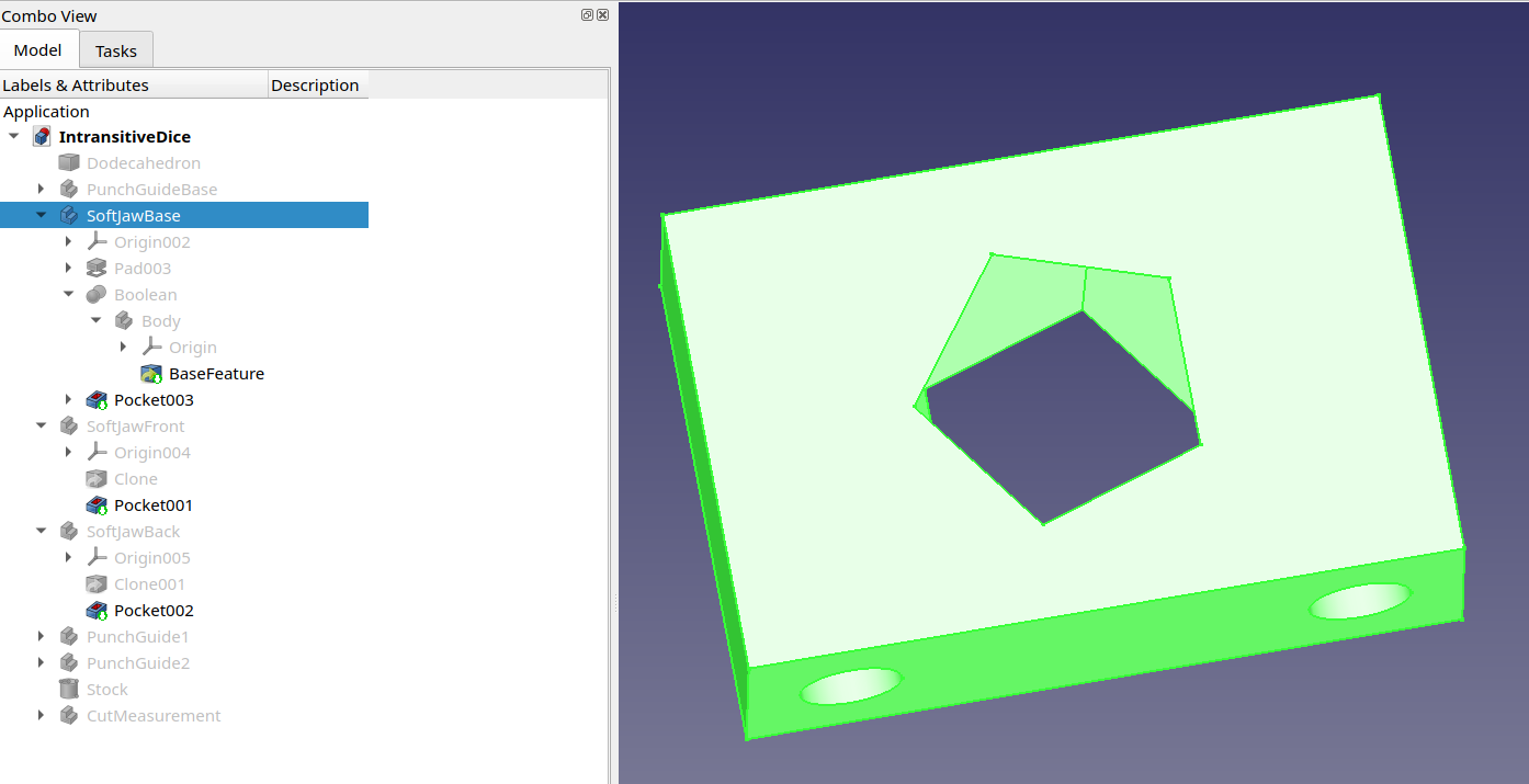

This is kind of like the soft jaws that I made for my dodecahedral dice, for which I used the Part Design workbench.
I created a block, and did a boolean operation to subtract a die from the block.
Then I made two copies of that block and used a face pocket to cut them back:
IntransitiveDice.FCStd (636.4 KB)
There are other objects in that file; it’s what I used for all my intransitive dodecahedral dice calculations. But if you look at those three objects in the tree, it might help you. The difference between custom soft jaws with alignment pins (though in the end I didn’t use the alignment pins) and a mold is not super relevant here.

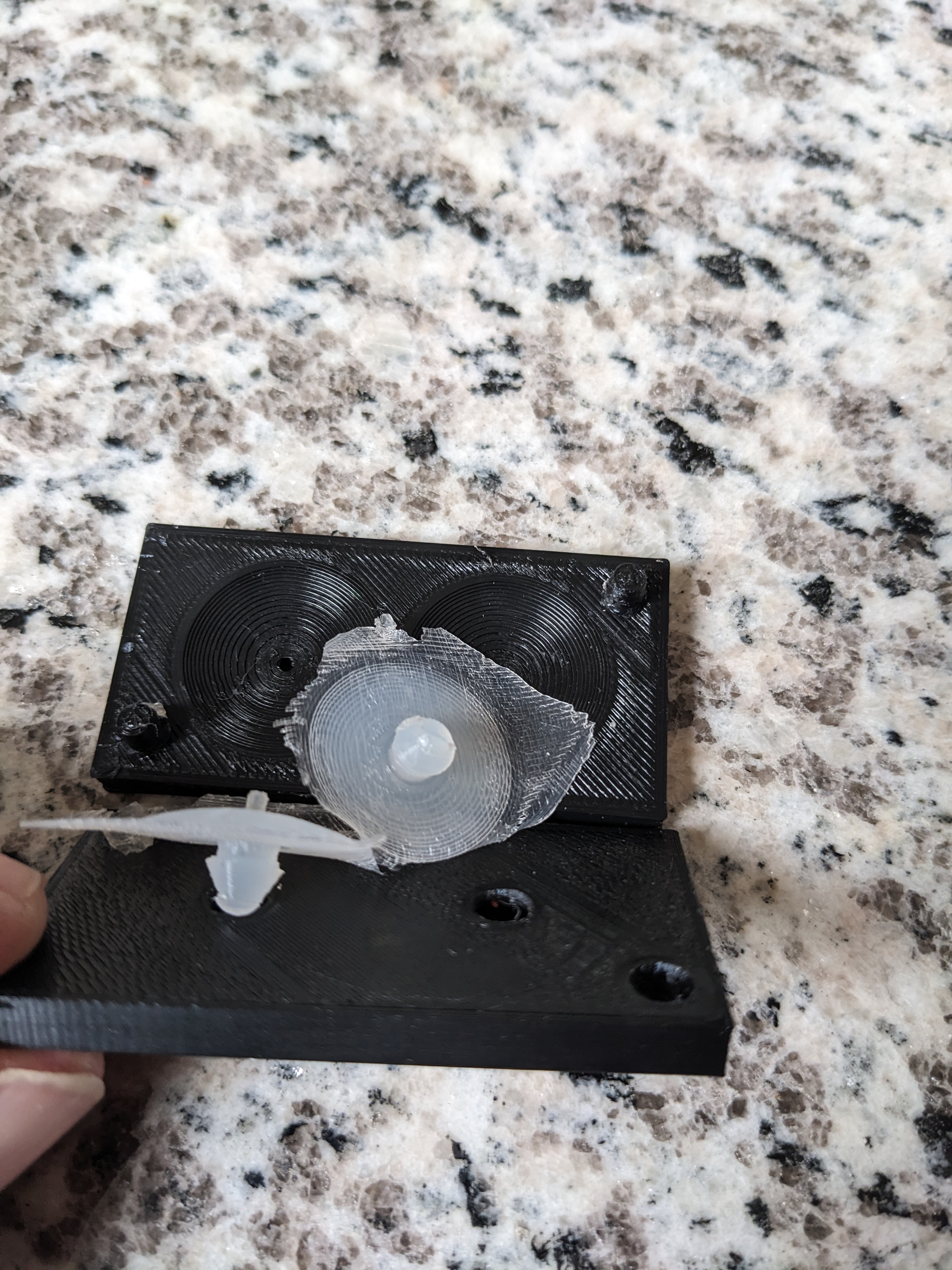

this is how it rolled. Now to print the parts and see if I can extract the silicone valves from it.
Update: I uploaded a new file since I forgot to trim the heighth of each mold half from 10mm to 6mm. No use wasting time and plastic right?

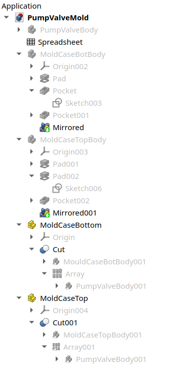

So finally playing with this while watching a print…
There was talk years ago about making Links usable within Part Design Bodies but it looks like that doesn’t work. And right now, you can’t have any step in the design tree for a Part Design Body that has a discontiguous shape.
I think the best option is to actually use the Part workbench for the final steps. Use Part Design to design parts. But then use Part and Draft to put them together.
I used “Mold” instead of “Mould” so I could keep my two tabs in FreeCAD separate. Please feel free to rename them if you prefer that spelling.
PumpValveMold.FCStd (57.5 KB)

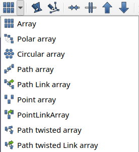

General workflow: Create a link of the valve, then use Draft Array to make two of them 24mm apart. Create a Part to hold one of the final mold halves. Link one of the mold half base parts. Select the link to the base Part Design Body, then select the array, then boolean cut, then drag the Cut object into the Part. Create another Part to hold the other final mold half. Create a ink to its associated base Part Design Body. Create a link to the Array that is now inside the first Cut. Select first the link to the second base mold half, then to the new link to the Array, then Boolean Cut, then drag the Cut object into the second part.
I hope I remembered all the steps.
Edit: Using my flow, the vent holes could be added to the base Part Design Body and they would flow into the Part with the Boolean.

Looking at your file it appears that you got over the issue with multiple pumpvalve objects by creating arrays of them. It seemed tedious but it was probably because I was reading a doc on how it works and following. And I see how you positioned the 2 pumpValves in the array so there wasn’t any translations needed when dropped into the case bodies.
Also liked how you made the case with it’s guide pins/holes and vent holes as their own body’s and then created another body for doing the cutting of the pumpValves.

Yup. And Draft has a bunch of other really powerful tools like that.
Those path arrays can follow an arbitrary wire, even a b-spline. I haven’t checked whether you can compose wires from sketches in different planes to do 3D arrays though.

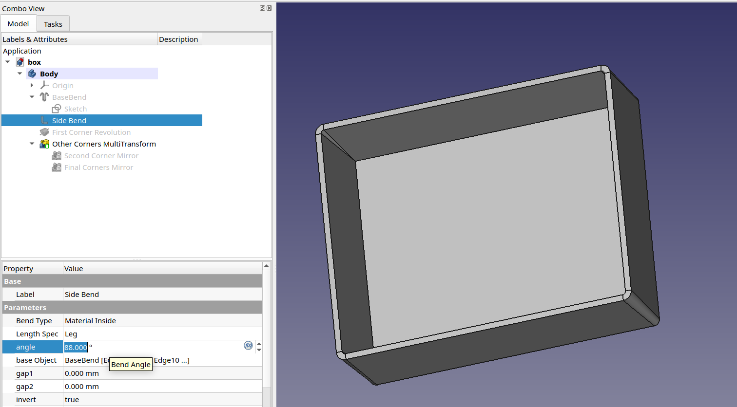

I found a cute trick for making box shapes with draft angles built in was to use the sheet metal workbench, then fill in the corners. SheetMetal workbench for plastic boxes - FreeCAD Forum
This might be helpful for modeling metal boxes or similar shapes.

There was some other ‘alternate’ use of Sheetmetal wb I saw a bit ago but can’t recall.
Looks nice and like the angled wall effect.
