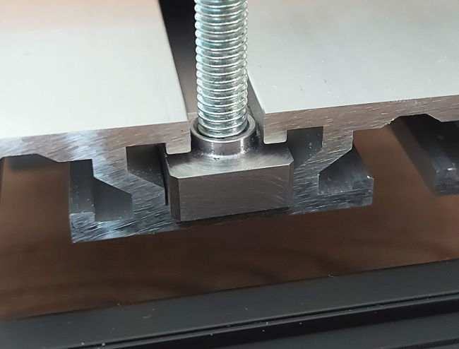

Just learning at the moment with GRBL and Carbon Create. But first thing to sort were proper T-nuts as using bolts just grated with me:
The dimensions for the T-nuts are 14.4mm across, the square nut is 6mm high and has an 8mm diameter boss protruding 2mm from the top. The nut is threaded 6x1mm. They are threaded the whole way through the nut. If you want to see how the T-nuts are made with manual machines.

Me too! I made some custom t-nuts for both of my 3D printers. For my corexy, I made a long t-nut with two holes that allows for my gantry to expand without binding the linear rails; for my cantilever printer I made one that was similar but larger for a piece of T-slot that I didn’t have the right size of t-nut to fit.
Interesting that you threaded them full through. The t-nuts for my mill have the threads cut almost all the way through so that the posts screw to the bottom of the t-nut but don’t bind against the bottom of the t-slot. Have you thought about peening the bottoms of your t-nut holes to protect the insides of the slots?
I assume you cut them on a mill, I wouldn’t think the 3018 would be stiff enough. Looks like a mill in the pictures?
Yes, machined on a Sieg SX2.7 and a Warco 240B - small hobbyist machines, but very heavy duty compared to the 3018. I threaded them all the way through as I’m just used to that with my normal machines, however, they have cast iron tables. Centre punching the bottom edge might be a good idea.

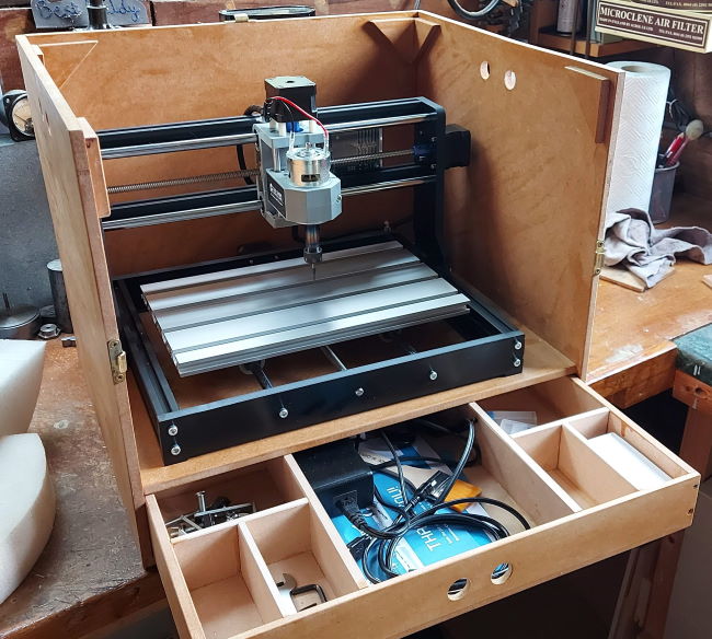

My workshop is not that big and I don’t use the CNC that much and so I just had to make a storage box
The best bit is the machine works great in the box, making it even easier to pull out, use, put away.
