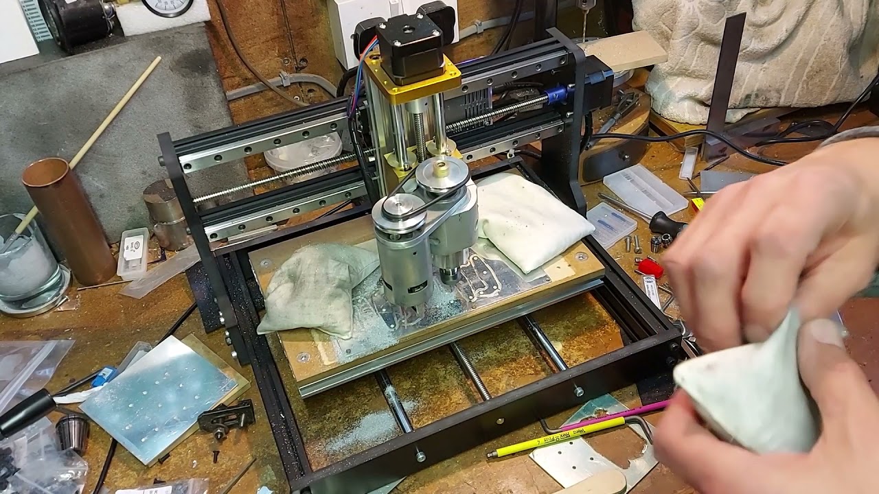

I’m now using 2mm milling cutter store aluminium bits, running at around 4000rpm, 0.1mm depth of cut, 200mm/min plungerate and 120mm/min feedrate.
Machining aluminium sheet is only possible using sandbags for damping.
Actually, sand and cast iron bags. I really like the cast iron (swarf/dust) bags as they are that bit heavier, but the cloth bags do get grubby. The downside is the table weighs more and so the steppers now have to generate more torque to accelerate it, F=ma

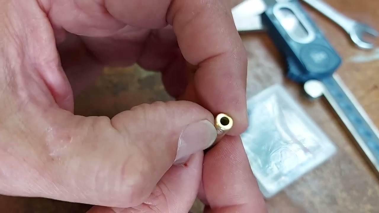

Just made a sprung D-bit to see if that would allow me to engrave brass
It appears to work quite well with brass. I will try some other materials.

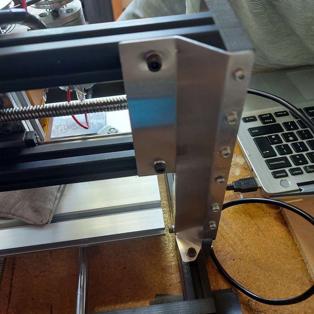

I’ve now made up some stiffening brackets using 1mm aluminium sheet, this is probably one of the most significant upgrades you can make.
These triangulate between the chassis, upright post and the upper cross beams. They also join the upper cross beams.
Simple to make and a significant upgrade.

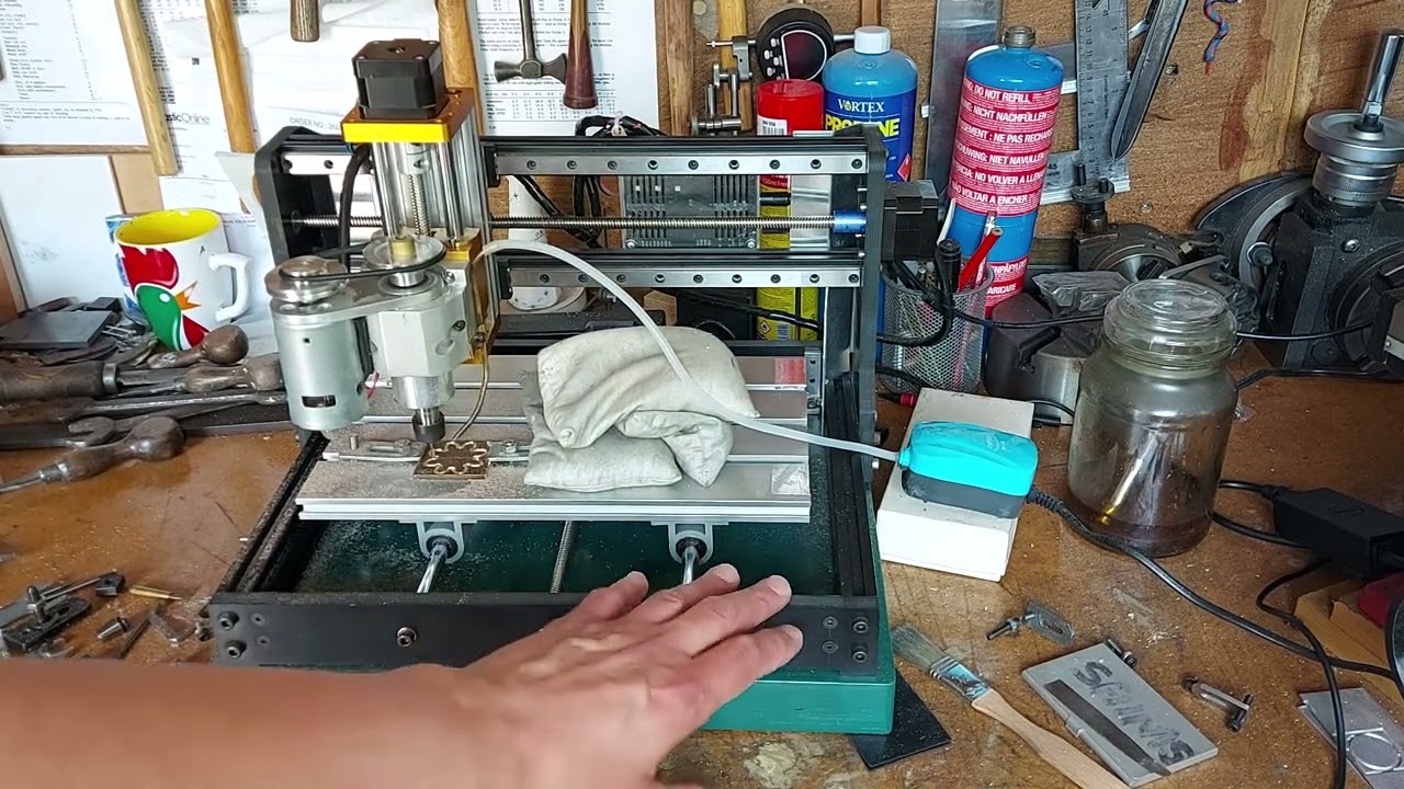

A quick video walk around of the machine that is now able to machine brass.
I’m very pleased with where this has go to, but this is not a cheap machine anymore with the upgrades and hours involved in improving each aspect. On the very positive side I have learnt a lot.

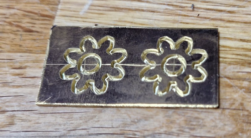

I cut these two gears in the week. The one on the right was first and then I set it up to cut the one on the left and walked away…
As you can see it jumped between the centre hole and the gear outline. So, this afternoon I watched it. The issue was the acceleration and max speed for the movement was set very high, beyond the capability of the 3108. I had been reducing the cutting speed to 60mm/s and hence was getting great results in brass. However, the movement between was hitting the acceleration limits of the machine and it was jumping.
I have powered the spindle separately and that might have helped the machine overall, but not sure. Limiting the speed and acceleration within GRBL has had a massive impact.
