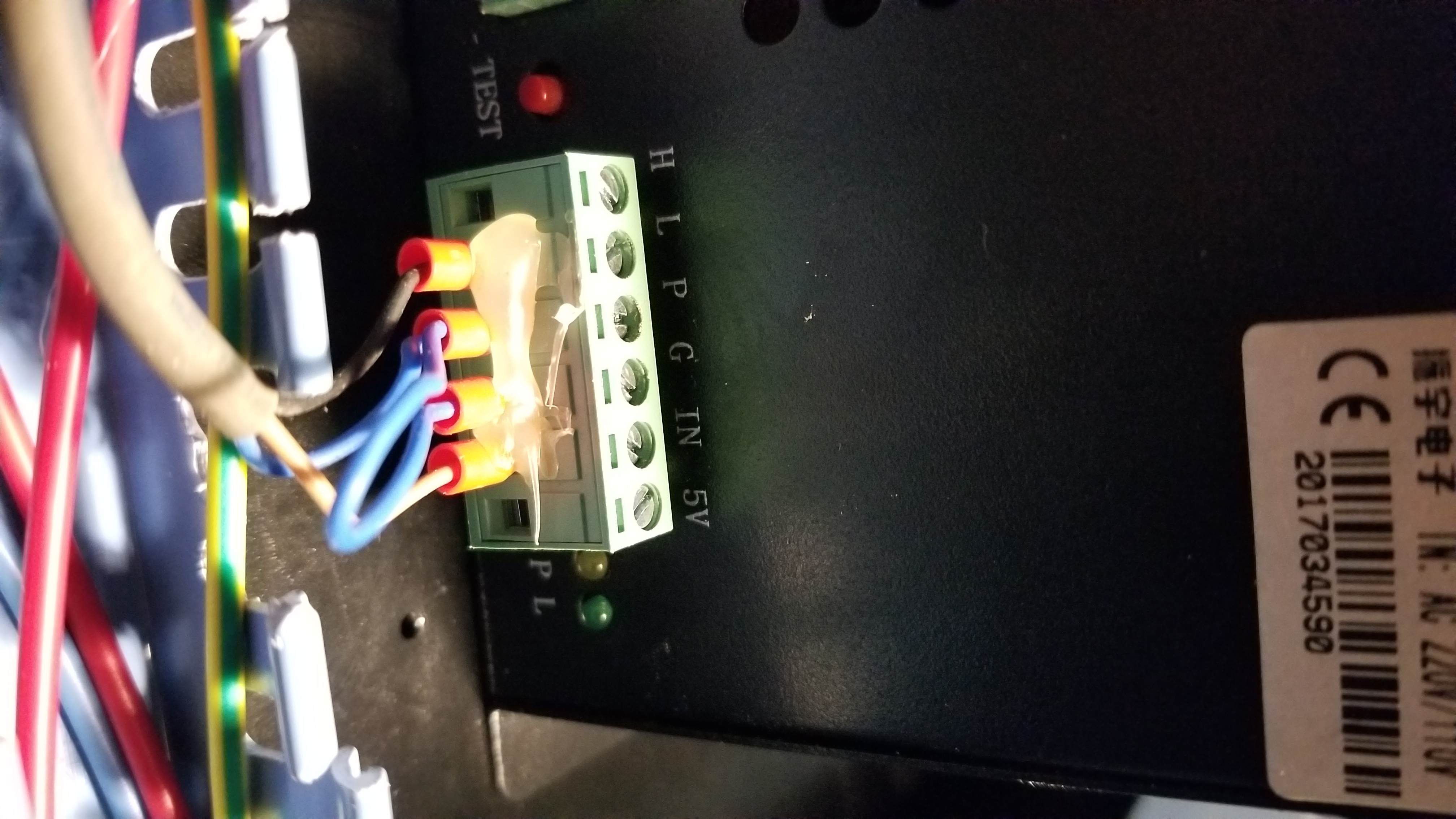

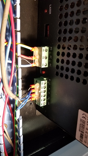

Here is my issue… the laser will not fire using the pulse key on the digital panel. I checked the Laser Power Supply (LPS) and found the following. With all connectors plugged in the “P” led on the LPS is lit. Pressing the test button on the LPS makes the “L” led comes on but the red “Laser” led does not come on and no laser is emitted from the tube.
I unplugged the control board connector from the LPS, obviously, the “P” led went off. Pressing the test button on the LPS makes both the “P” and the “L” leds come on, the red “Laser” led comes on, and the laser is emitted from the tube.
My initial thought is the water protection (WP) sensor is bad. I traced the wires from the WP sensor to the board to be sure they were labeled on the control board properly. They are. I disconnected the WP sensor connection and jumped a wire from the WP port to the ground on the control panel. I plugged the control board connector back into the LPS and tested the test button on the LPS. No change was noted. I checked the pulse button on the control panel and no change there either.
My LPS is MYJG-60W. Here is a link to one just like it.
Any help would be greatly appreciated. I am not sure where to go from here.

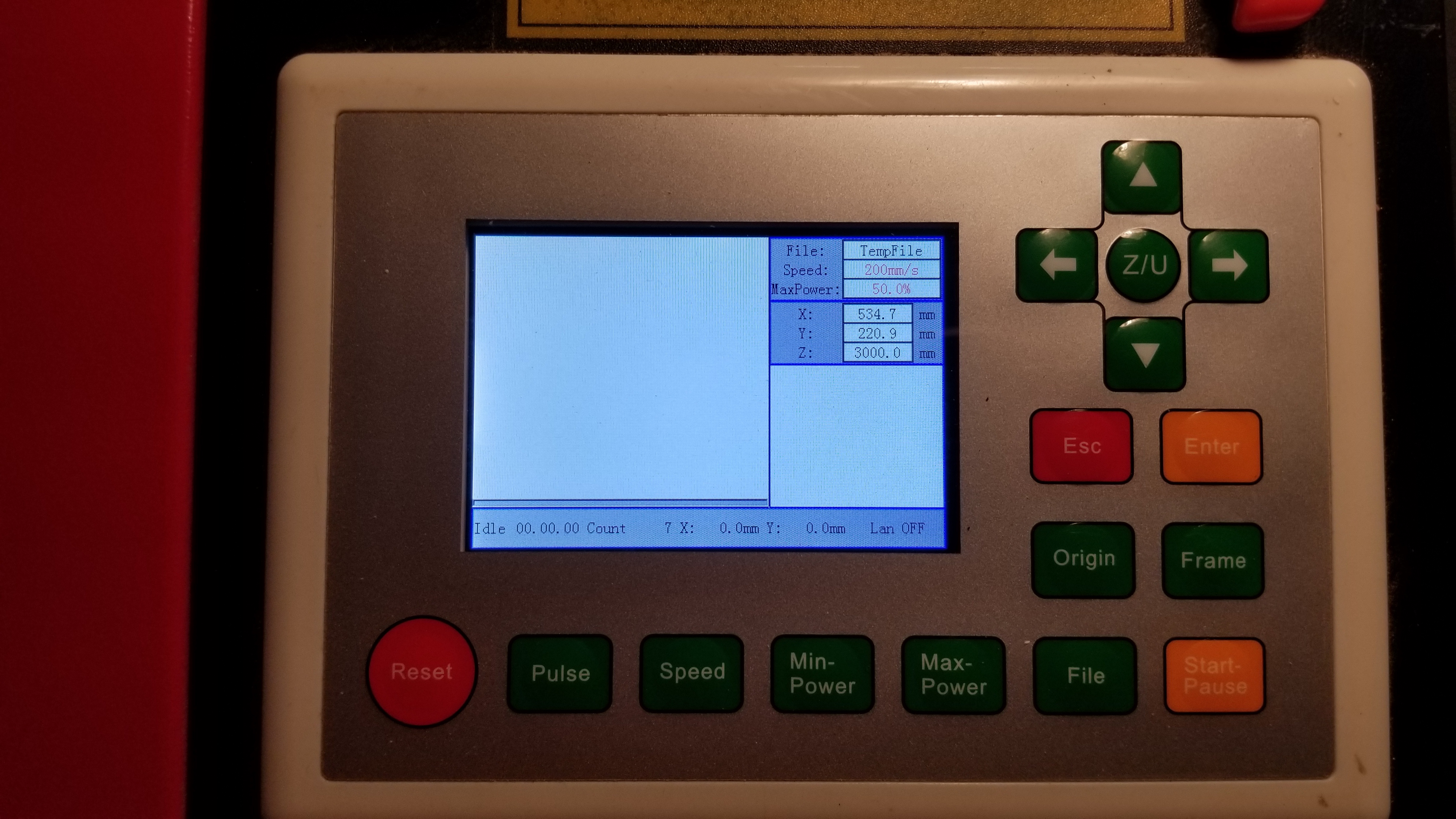

Please post these pictures:

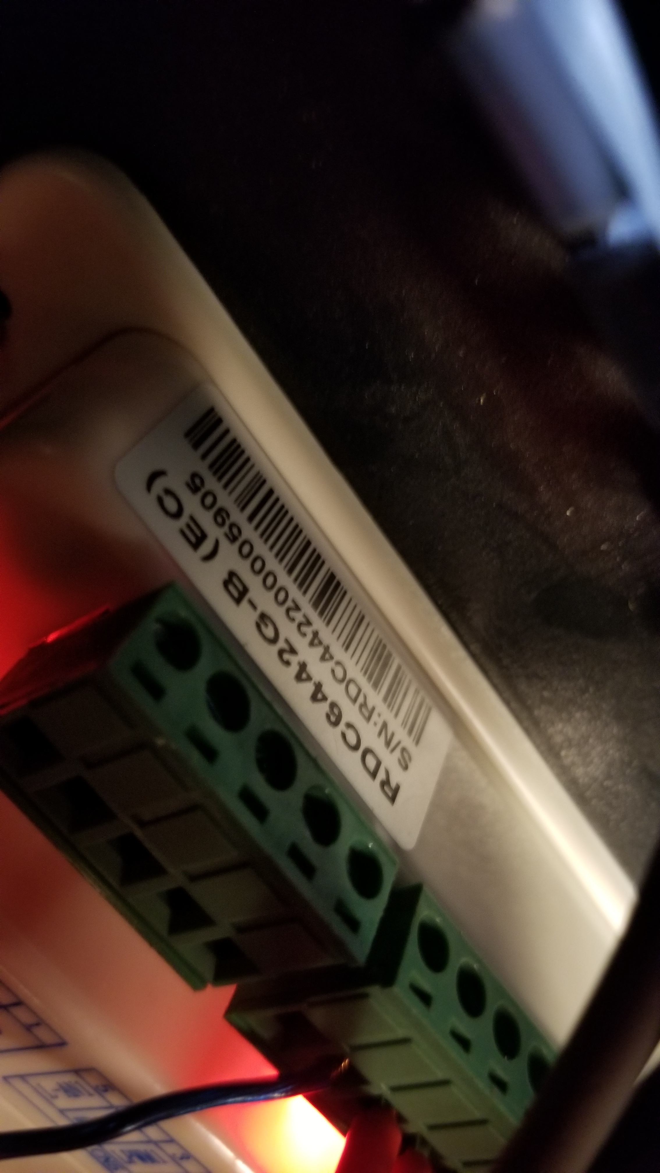

  • The connector end of the LPS
  • Control panel
  • Model # of the controller

I suspect that something is wrong with the power control on the IN pin of the LPS.
The LPS power is controlled by a 0-5V signal on the IN pin. Digital control panels typically send a PWM signal that is proportional to the power level set on the panel. i.e if the panel is set to 50% the signal on IN is 50% DF.
Troubleshooting
  1. When #12 above is true what is the digital power setting on the control panel?
  2. When #12 is true what is the voltage on the IN pin?
You can measure the voltage on IN with a DVM
OR
You can tie the IN pin to 5V which will simulate MAX power. Then try the control panels “Test” button again. Verify that the laser does or does not fire.

Summary so far…
It seems the laser power supply is working properly in that it operates with the test button down on the supply.
That is: if the answer to question #15 & 16 is yes.
Note: internal to the LPS when the local test button is pushed the P [WP] and L signal inputs are simulated so all of the control inputs are essentially bypassed. That is why the “L” LED comes on. I believe the L signal should also come on when you push the Pulse button on the panel.
  • The above seems to hint that the start of this failure is somehow related to the water sensor.
  • That said all indications are that the enable signal P is OK
  • However the L signal is not asserted when the Pulse button is pushed.
  • We will do some further verification tests below.

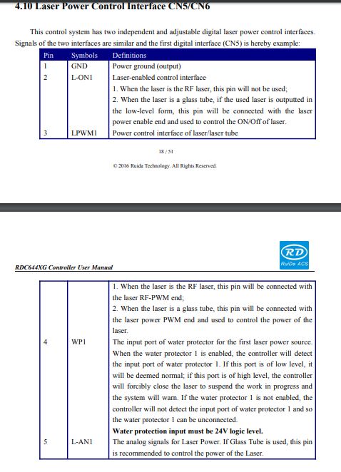

Research on Ruida control of LPS

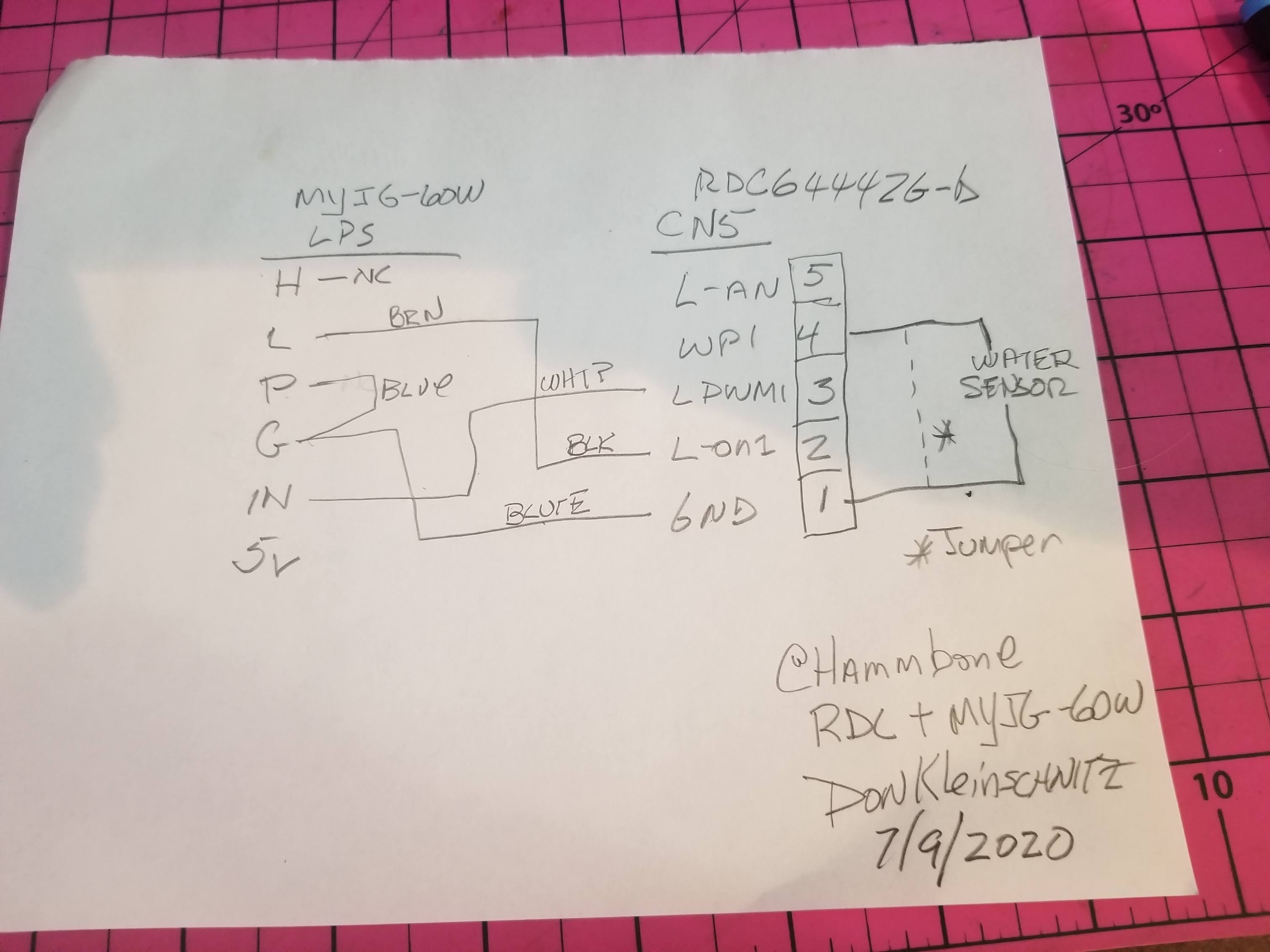

@Hammbone it sure seems that the L signal is not being asserted on your machine.
Should have asked earlier…
29. Does the laser fire when running a job vs the Pulse button?
Research suggests to me that:
  • The P [WP] control on the LPS is not connected nor used by the controller. Your pictures show that your P signal is jumpered to G. Unless there is an internal LPS problem P is likely not the culprit.
  • The controller controls the LPS using only the L and IN ports on the supply.
  • The WP input of the controller uses a 24VDC level
  • I expect that:
    ** Power Level is controlled with the PWM signal LPWM1 which is connected to IN
    ** All Laser fire is accomplished using the L signal. This is true for normal imaging and the pulse button.
  • Coolant sensing is done directly by the controller which in turn inhibits the assertion of the L signal if:
    ** water flow is not sensed
    ** a chiller (if connected) error occurs.
  • Theoretically, the controller could also lower the power level on the IN pin.

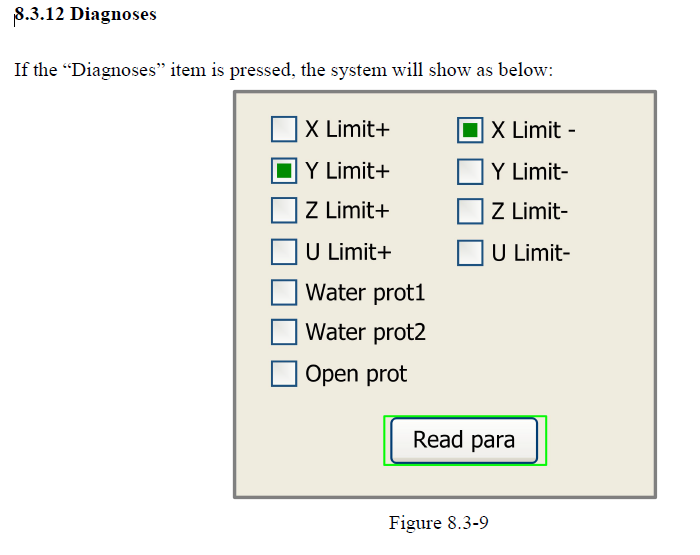

In the manual, it seems you can use the Diagnosis function to read what the controller thinks the state of the WP signals are?
I would try that to see if that gives us a clue.

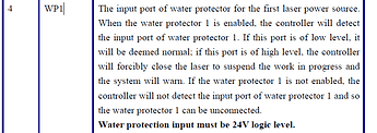

WP Enablement
This section of the manual says “when water protector 1 is enabled”.
In section 9 of the manual
Water protection enables: When the water protection enabled, the controller must connect the wiring,
otherwise the machine will not emit laser. If disabled, no need to connect the water protect wiring,
the controller will not test.
I would reccomend you look at the WP enablement setting and diagnostic for clues.

My estimate of your wiring:
Signal defintions from the manual:

Interesting Results;
note: I am assuming that the collected voltages are NOT negative as indicated by the -.
Static Tests: this looks good. Note that the IN signal = “0” meaning that the controller reduces power to 0 when the system is idle even though L is not asserted.
Dynamic Tests: looks strange, L is not asserted (=5V). This should be low assuming the Pulse button is supposed to fire the laser?
These results suggest that the controller does not assert the L signal with the Pulse button or the controller is not properly asserting the L signal.
This suggests that L is not being asserted when a job is running and there is a problem at the controller level. Note that power (IN = 2.5) has changed from the static test and is properly asserted.
Yet, this suggests that the LPS is not working because placing L at ground should fire the laser!
The previous L test is invalid
As seen above the IN pin is held at 0 during idle times. Therefore the test of manually grounding the L may not be a valid test of L as the IN pin is at 0, i.e. no power. This is further supported by the fact that grounding the L turns on the L LED but the laser does not fire. It’s actually firing at 0 power. Therefore we need to ensure that the IN pin is not 0v when we manually test L.
But why would the controller change the IN pin to 2.5V when inhibiting the L pin?? The controller may assert a power value independent of coolant condition?

Is it possible that the WPI is expecting 24V vs ground (specs say ground) to show good coolant???
I would disable the Water Protect sensing in the settings and see if this temporarily fixes the problem.
32. Has the water sensor checked bad??
33. Check the WP1 pin on the controller is it truely ground? With power off I would measure continuity (ohms) to ground.

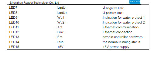

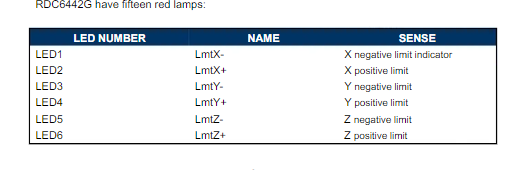

Found a manual with more info on LED’s: https://www.academia.edu/37288820/Users_Manual_of_Ruida_RDC644XG_Control_System
  1. Is LED 9 on?
  2. Some hints on web searches suggest that interlocks can stop the Laser from firing are any open?
  3. Can you list what LED’s are illuminated?

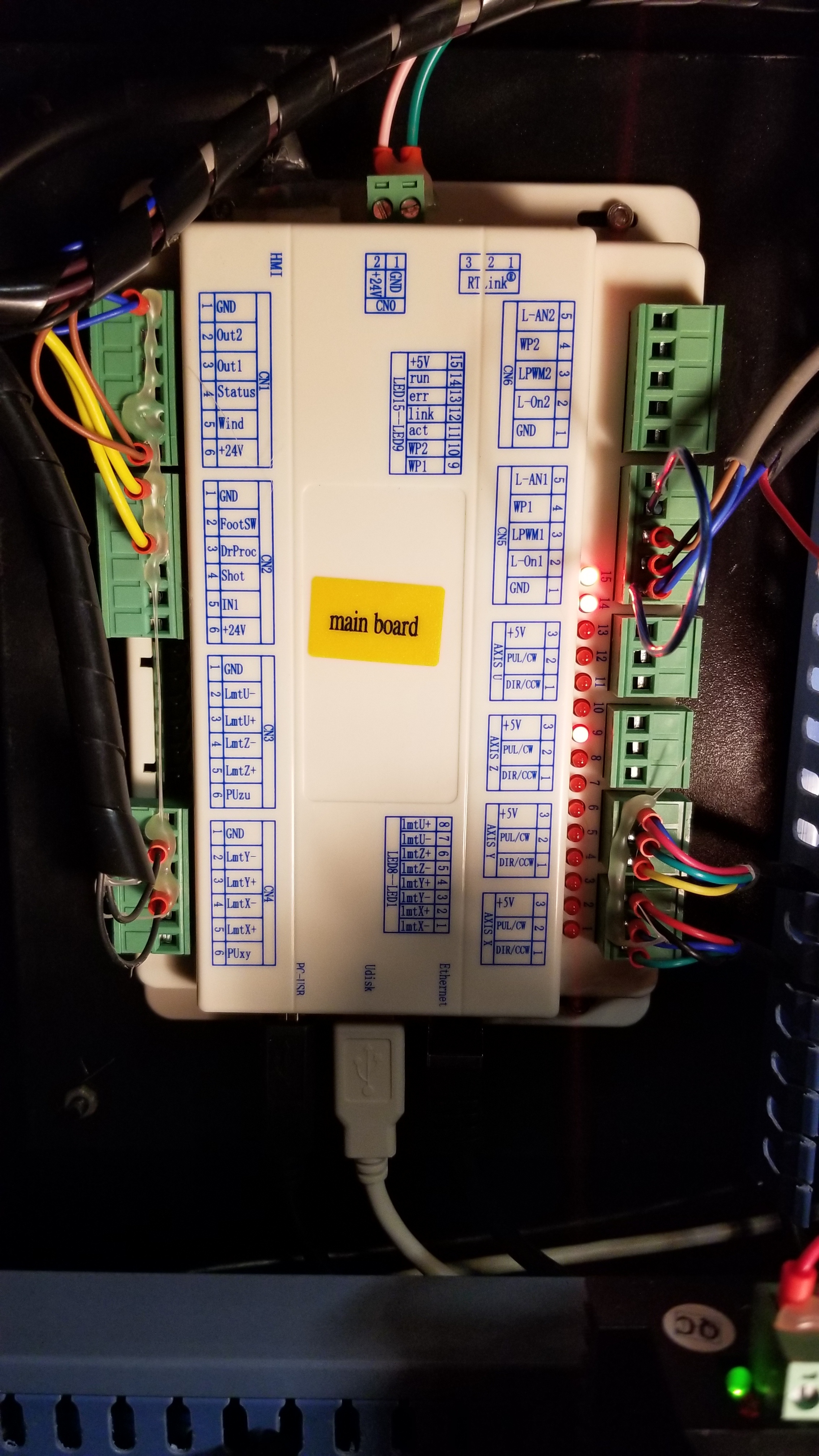

From the previous controller picture above I am guessing these are on:
LED 15: 5V
LED 14: Run
LED 9 : WP1 indicator (does this mean good or bad water flow?)
38: When you pull off jumper does LED9 go out? EDIT: looks like LED 9 on means WP is ok)
EDIT: the WP LED being on, the LPS working suggests it not WP that is keeping this thing dead. Starts me wondering what else is telling the controller not to fire. Such as door interlocks?

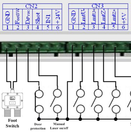

@Hammbone,
I found this drawing in manual and noticed that in your machine on CN2 there is a Yellow wire on this pin.
Also notice that you have a similar yellow wire on grnd. This suggests to me that this is the interlock circuit.
  1. Have to ask a stupid question, are you closing the interlocks when doing these tests :thinking:?
    However, I would think the controller would throw an error if the interlocks are open.
It also shows a Shot function on pin 4. You could try grounding that pin and see if the laser fires with Pulse.

I should have also included the “L” LED on the LPS does not light up with the pulse button. Only with the test button on the LPS itself.

So far we have learned:
Ruida Controller
  • LED 9: ON state indicates a good WP circuit.
  • LED-14: blinking is normal running condition
  • CN2-3: a low true interlock circuit
  • CN2-4: enables the laser to fire with the LPS test button
  • CN5-2: [L-On1] is a low true signal connected to the LPS-L pin
  • CN5-3: [LPWM1] is connected to the LPS-IN and controls power with a PWM signal.
  • CN5- 4: a low true signal used to detect good water flow
  • Water protection: can be disabled from the driving software: RDworks, LightObject
LPS
  • L: PWM controlled by the Ruida during a job and when pushing the Pulse button. To test the L pins ability to fire the laser, tie IN to 5V and then briefly touch L to ground.
  • P: the P is bypassed to ground at the LPS. The Ruida implements the interlocks and coolant protection by not asserting the L signal when these circuits are open
  • IN: when idle, IN is 0v i.e. no power. IN is set to the panel power PWM value when the Pulse button is pushed.
  • Local test button: will test laser supply is the IN pin it tied to 5V or CN5-4 is tied to grnd.

  1. Are the controller and LPS grounds at the same level, no resistance between them.
  2. What does the 24VDC read?
