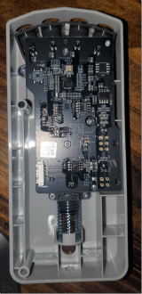

Wow. It looks like Bambu is using unencrypted FTP for shipping stuff around. Here’s a blog entry that starts to tear into the hardware and firmware a bit.
Even if I was OK with their cavalier attitude to open source and intellectual property, I’d be wary of using their stuff for printing anything I didn’t want to be public.

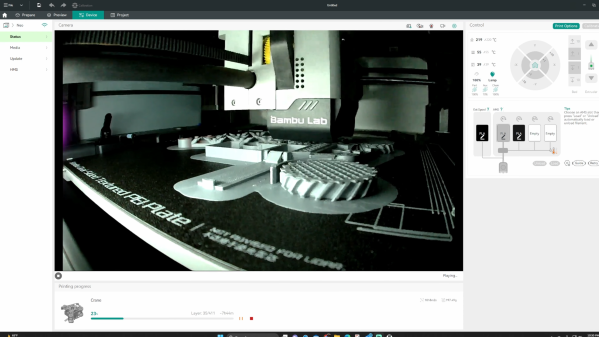

FWIW, I’m running the Bambu Studio slicer on Fedora with no fuss other than one of my machines failing to load the network plugin for some unknown reason.
Interesting since I’d went to Bambu Labs site and checked their Bambu Studio downloads and it only stated Windows and Mac. A review from last year said they they were only releasing a Windows version and was hopeful a Mac version would follow. Are you maybe running Orca as opposed to Bambu Studio?
There is a linux based slicer for the Bambu machine and it’s called Orca. It is a fork of Bambu Studio which is a fork of Prusa Slicer with bits of Super Slicer and Prusa Slicer is a fork of Slic3r. I did not see a packaged binary of Bambu Studio for Linux and only saw them list Windows and Mac versions. Orca has all supported.
If you go to the GitHub repo for Bambu Studio and look in the release assets there’s a Linux build.
