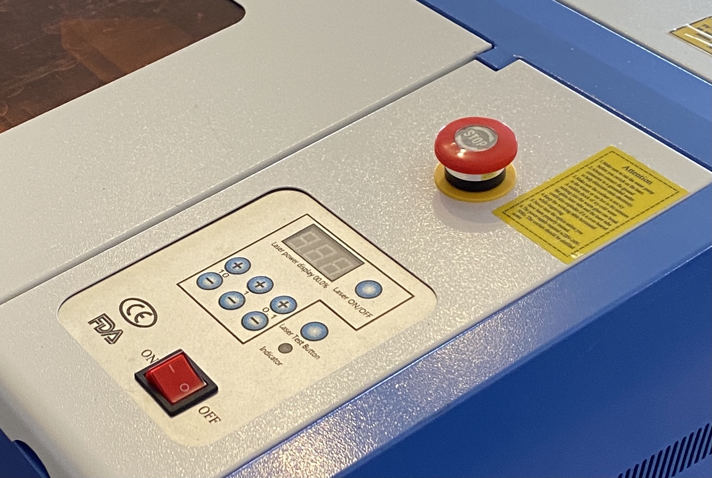

I am guessing you have a digital panel and no laser current meter on the machine?
Post picture of your control panel pls.
LPS stands for Laser Power Supply.
And yes, im assuming you have a digital panel, 0.01 probably won’t produce anything.
Try small increases of 1, if you get to 10 on your display and still nothing then you’ve still got a problem

Pic attached. I’ll try again at higher powers tonight hopefully this is the issue.
