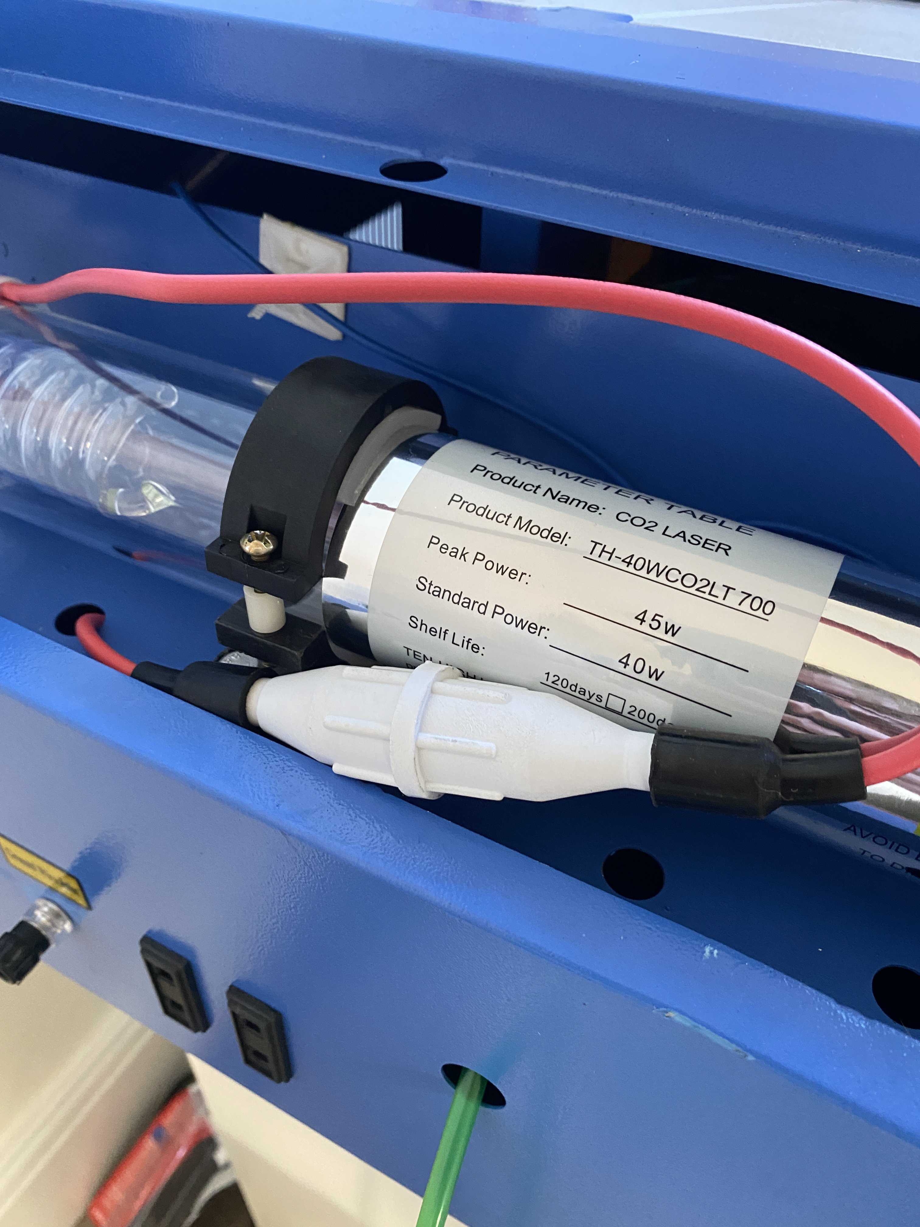

You may, what are the specs on the tube.
old one is 600mm and no mention of power, new one is 700mm and 40w (peak)
I have one of these being printed to accommodate the longer tube.
I don’t intend on running the laser at full power so thinking it should be fine. I heard the power unit is the same but not sure how true that is
If its 40W you should be ok. Worse case you will notice you cant get to full power.
I highly recommend adding an MA meter do you can tell what the tube is doing.
I’ll get on with getting an ma meter. Turns out the machine has a removable panel for a longer tube. I’ve got an end cover being printed as we speak. Will get it all together and tested this week!
Just make sure that you don’t end up the shortest path to ground for the 20,000V in that high voltage wire now that it’s not entirely enclosed in a metal cabinet. :slight_smile:
A plastic enclosure for the anode end is not a good idea.
Its cover should be grounded. That LPS can easily pierce the plastic if a ground … like you … were to get to near it.
I see, there’s me thinking plastic was the ideal material owing to it being an insulator. Not sure what to do now then.
Could I add an earth inside the plastic tube? Like, a metal bolt close to the cathode with a wire to the machines earth?

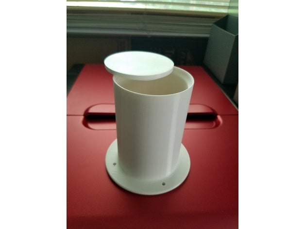

I think I remember someone making a tube extension from a metal coffee can one time.

Found the one made from a large soup can. By @TechBravoTN
