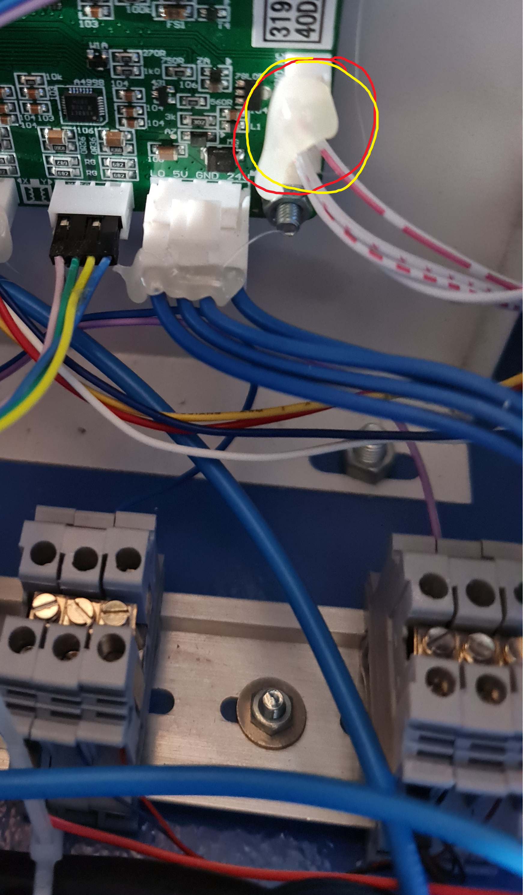

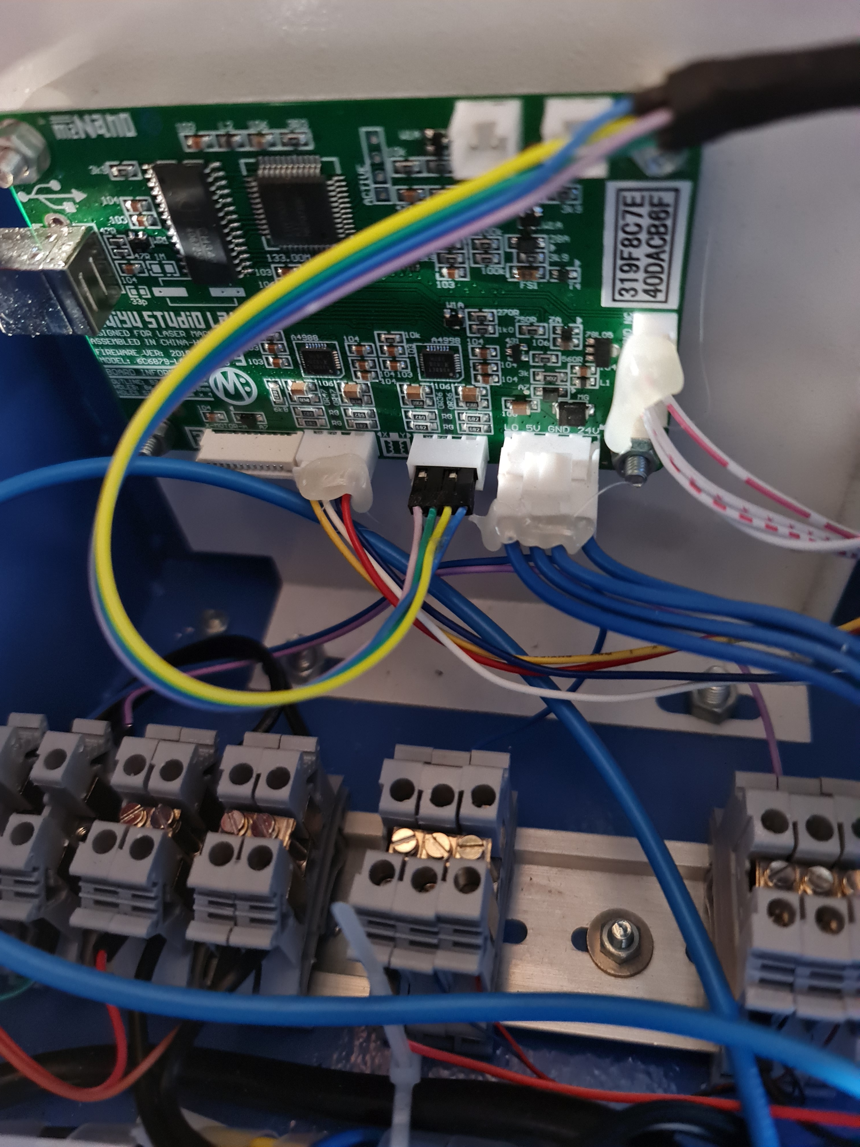

Does anyone happen to have pictures of the connectors (on the board) as I have a feeling an issue I am having with homing is to do with one of the connectors on this. I had a wire which was dangling and an empty connection slot; assumed the two went together but now not so sure.
Nano M2…
thank you for the picture. The cable block I am referencing is the one on the right - which I believe controls the limit switches.
There are two wires which go into 1 connection and I had one wire out of the block and an empty slot in the right hand GRND slot so I put it in there. Just wondered what the normal set up for that connector is as I think it has a direct impact on my issue
Do you want a picture closer to those connectors? Problem is, all the wires are the same colour :thinking:
If you could get one that would be amazing! I know right, it doesn’t help too much them all being the same colour! But if I can se ehow its set up I can work it backwards and see if I put this cable in the right place or not
