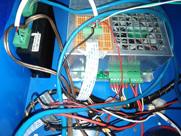

In the meantime, I’ve started planning the layout of the current components in the electronics side of the laser…It’s not pretty at the moment, no excuses except the we’ll get it running then tidy it up properly excuse. When the makerspace originally got the laser, it was set up for operation with an Ardunio via parallel port to a PC that ran Linuxcnc. In installing the Raspberry Pi and the Protoneer CNC hat, some circuitry was added to sort out the voltage levels from the opt-coupler end stops (second photo). THis will be replaced with a PCB we’ve have made. The stepper drivers are standalone DM542s.

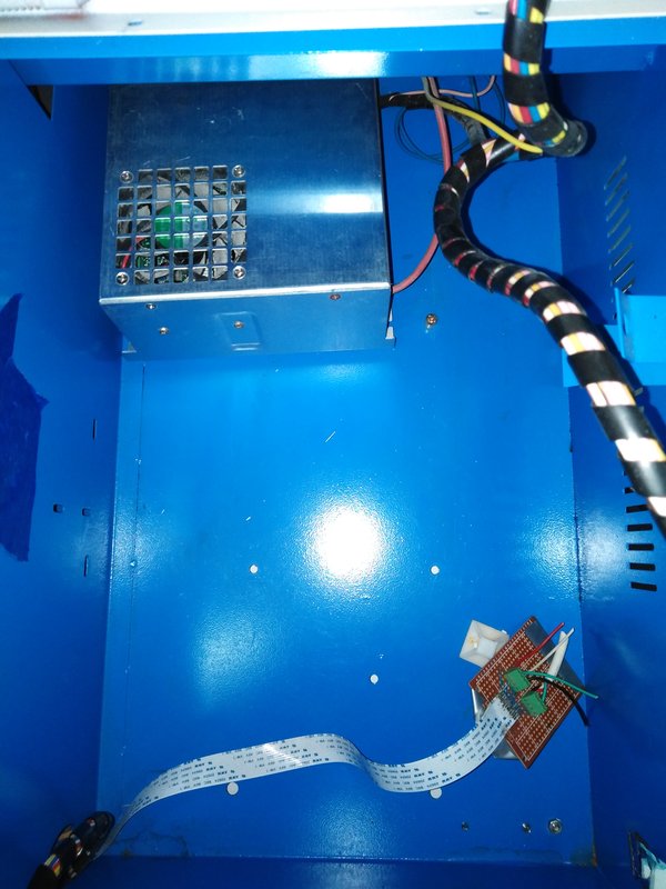

FFC cables arrived today.
Still not sure if they shold be A or B style. I’ll find out tonight when I visit Hobart Makers to dismantle the K40 for a rebuild.
EDIT Looks like it’s the A type i.e. not crossed over. So i got the wrong one. :slightly_frowning_face:*

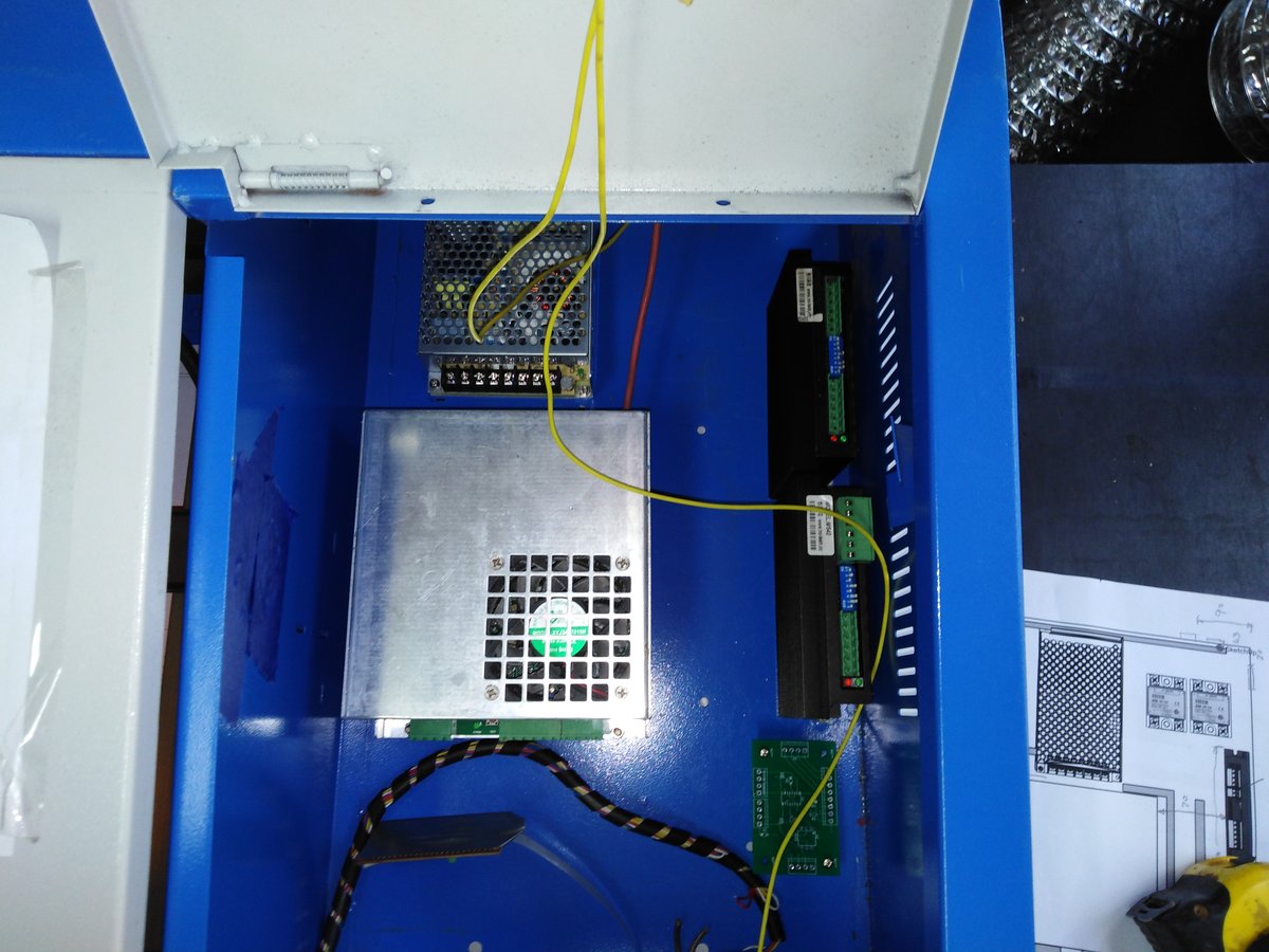

As of last night, it’s a lot tidier in there. Nothing like a clean slate.
The LPS is being moved 40mm to the left of it’s default position to make room for the two DM542 stepper drives against the right hand wall of the cabinet.
The 24V/5V new supply will sti behind the LPS.
Make sure the LPS has plenty of airflow!

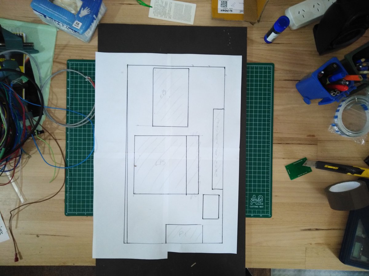

Here’s the planned layout for the K40 update.
The blue are represents the space at the right hand side of the laser cabinet i.e. where the electronics are. The LPS is left off for clarity - it goes in the blank spot in the middle. The red/pink lines are where the wires will run. Red is for mains AC power and is run down the left hand side and around the back so as to separate from any low voltages. The green square is the PCB that handles the opto end stop voltage level change, the brown block is a terminal strip for 24/12/5v from the additional power supply. Two SSRs for air assist and exhaust fan.
There will be 3 IEC connectors on the back panel to provide power for air assist, pump and exhaust. Pump will be permanently powered. Mains power switch will be moved from the front panel to the rear side of the cabinet.
Found a little Oops when I did the cutting and drilling today. Turns out ‘someone’ had the depth of the cabinet at 576mm but it’s actually 500mm. Power supply fits where shown but there’s no room for the fan
Fixable, just means drilling few mores holes and mounting the power supply at 90 degrees to that shown
One solution might be to mount the fan outside the case (still blowing in).
Spoiler: The someone was me :face_with_raised_eyebrow:
Got chance to do some work on the K40 today. Got the power supplies and stepper drivers mounted. I’ll start making up the wiring loom tonight/tomorrow.
That’s way to neat to work …lol!
Heavy duty (22AWG), 4 core, shielded microphone cable for the stepper motors. A lighter gauge (28AWG) 4 core, audio cable for the control signals from Raspberry Pi to stepper drivers. All DC (5/12/24) power cables are 17AWG, not really necessary but what I had available. Mains wiring to outlets and to power supplies is from standard, 3 core flex.
All stepper driver and Raspberry Pi wires will be terminated with bootlace ferrules, similar to those used to connect the standard laser power supply. Mains wiring will be female spade connectors, these may end up being soldered instead.
