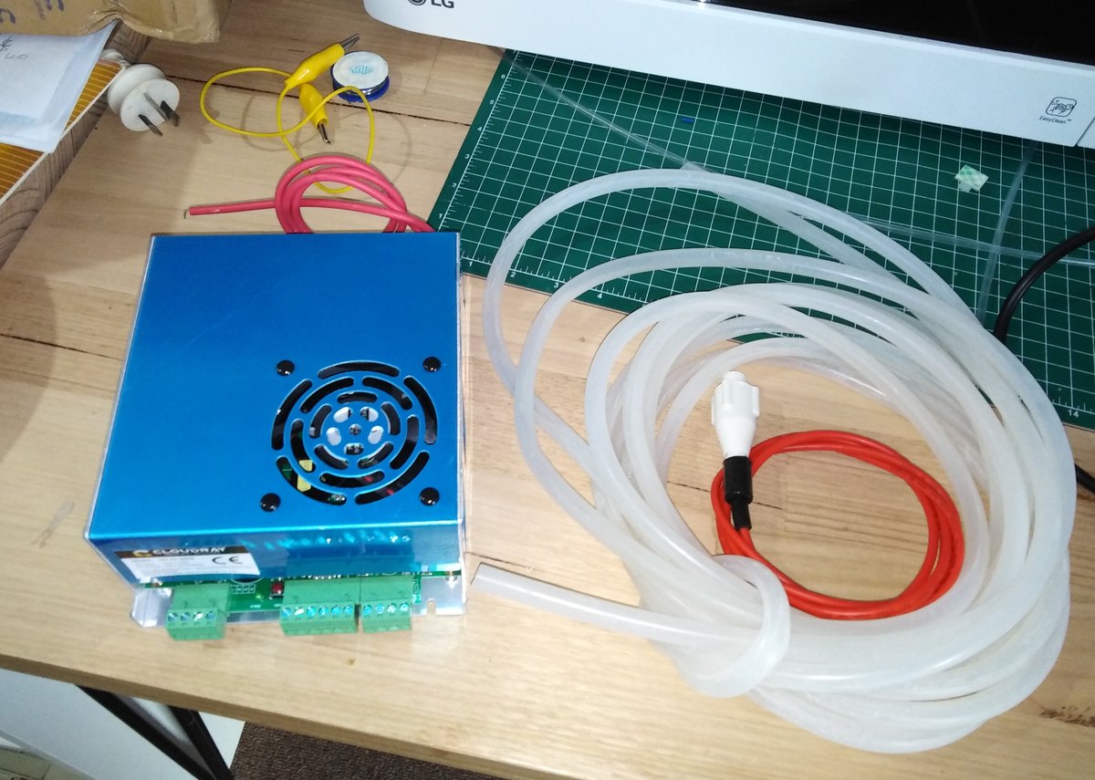

Parts are slowly starting to trickle in. Today I got the new power supply and some silicone tubing. These are from Cloudray so my new laser tube can’t be far away

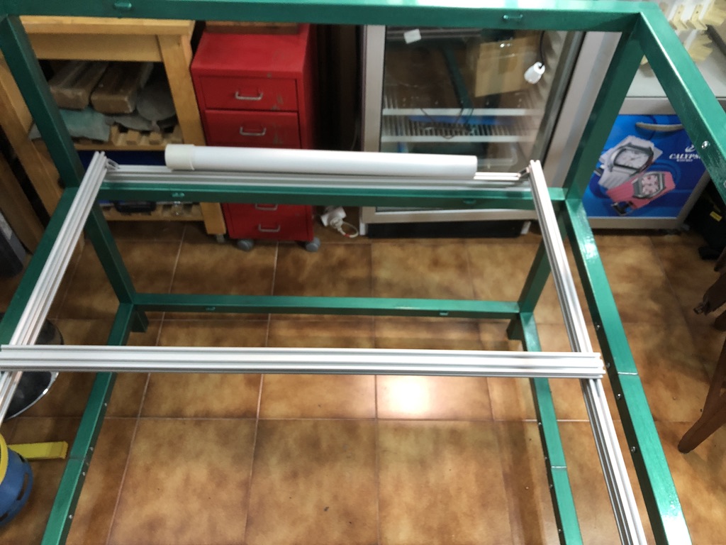

ok misunderstood. Im rebuilding mine at the moment in to a metre by 1.2 metre cage, it will be an open style laser with protection where needed, Already just done one at 800 x 670 cutting area, this will be at least 900 /1m cutting area plus a built in rotary underneath and 10 watt diode on top.shelf.
Early stages, built the external frame now sorting out the internal frame and tube. Plastic pipe is an representative tube. Useful to get the frame just right… Everything will run on flat superfast/smooth linear rails, cost a small bomb but worth every penny.
Thats the idea anyway! Probably take the tube up to a 50 or 60 when the original 40 dies.
