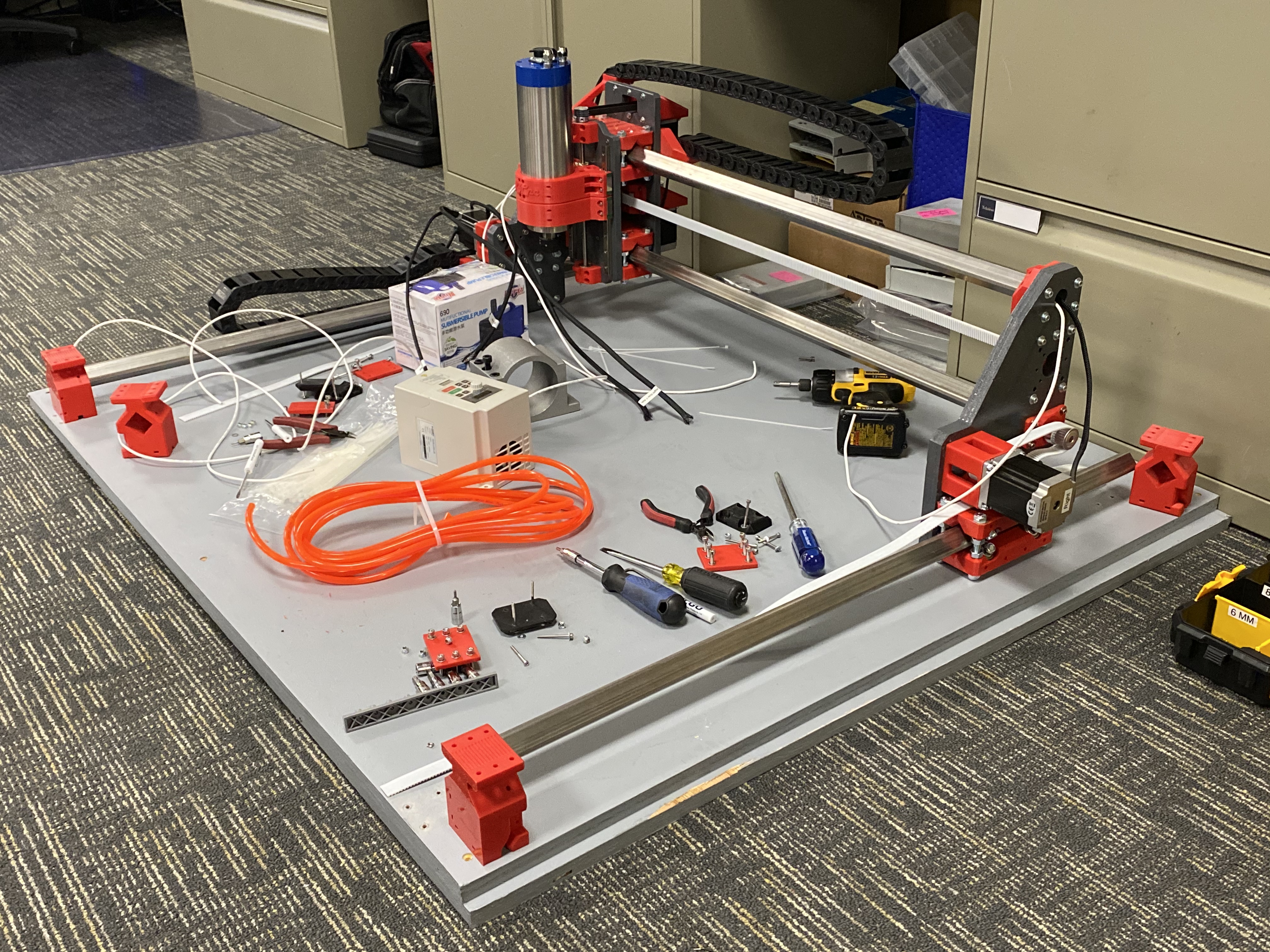

I’m thinking I might run the water lines for the spindle in the cable chain along with the wiring. Not sure what else to do with it. I like the clean look.
I ran my 8 mm tubing right through the cable chain too. It can be a tight fit depending upon how big a cable track you got. But it’s definitely worth it in my opinion. Nothing to catch start shooting water everywhere :slight_smile:
I’m lame. My cable chain isn’t large enough for the tubing, so I’m planning to use cable ties to train it to follow along the outside of the cable chain.

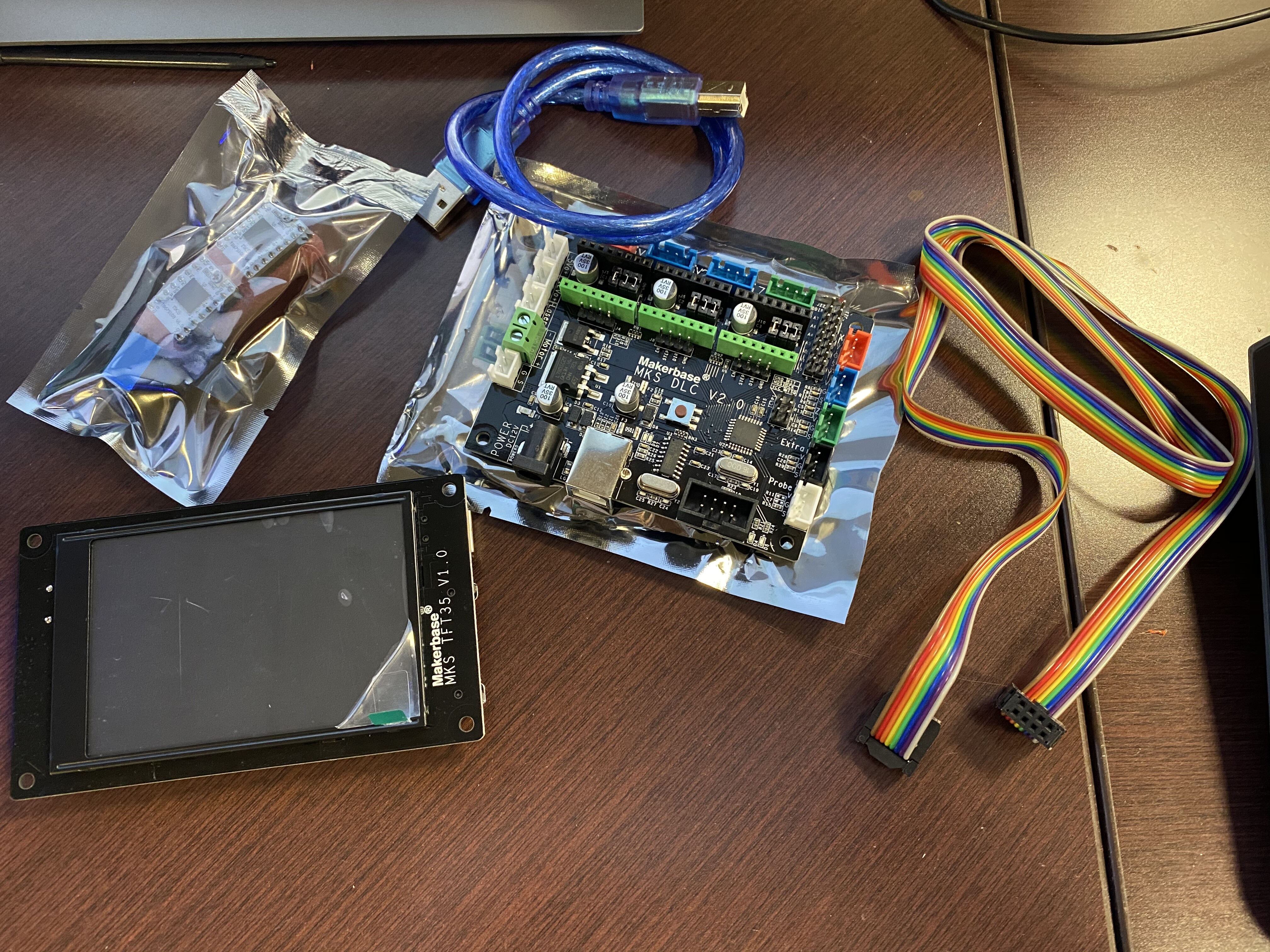

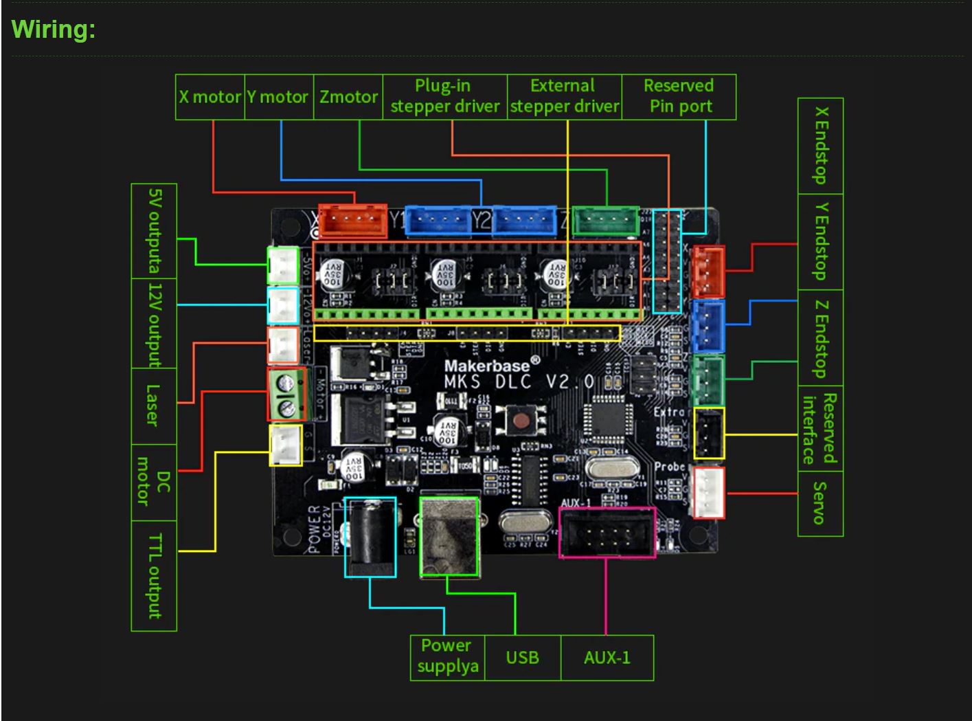

I got my MKS DLC V2.0 board today. Is it weird that they only send 2 of the drivers for all the boards they sell? I would think I need 1 more driver for Z axis?
I kind of forgot I was using the external steppers. I shouldn’t need these right? I’m just plugging into where it shows external stepper driver pins:

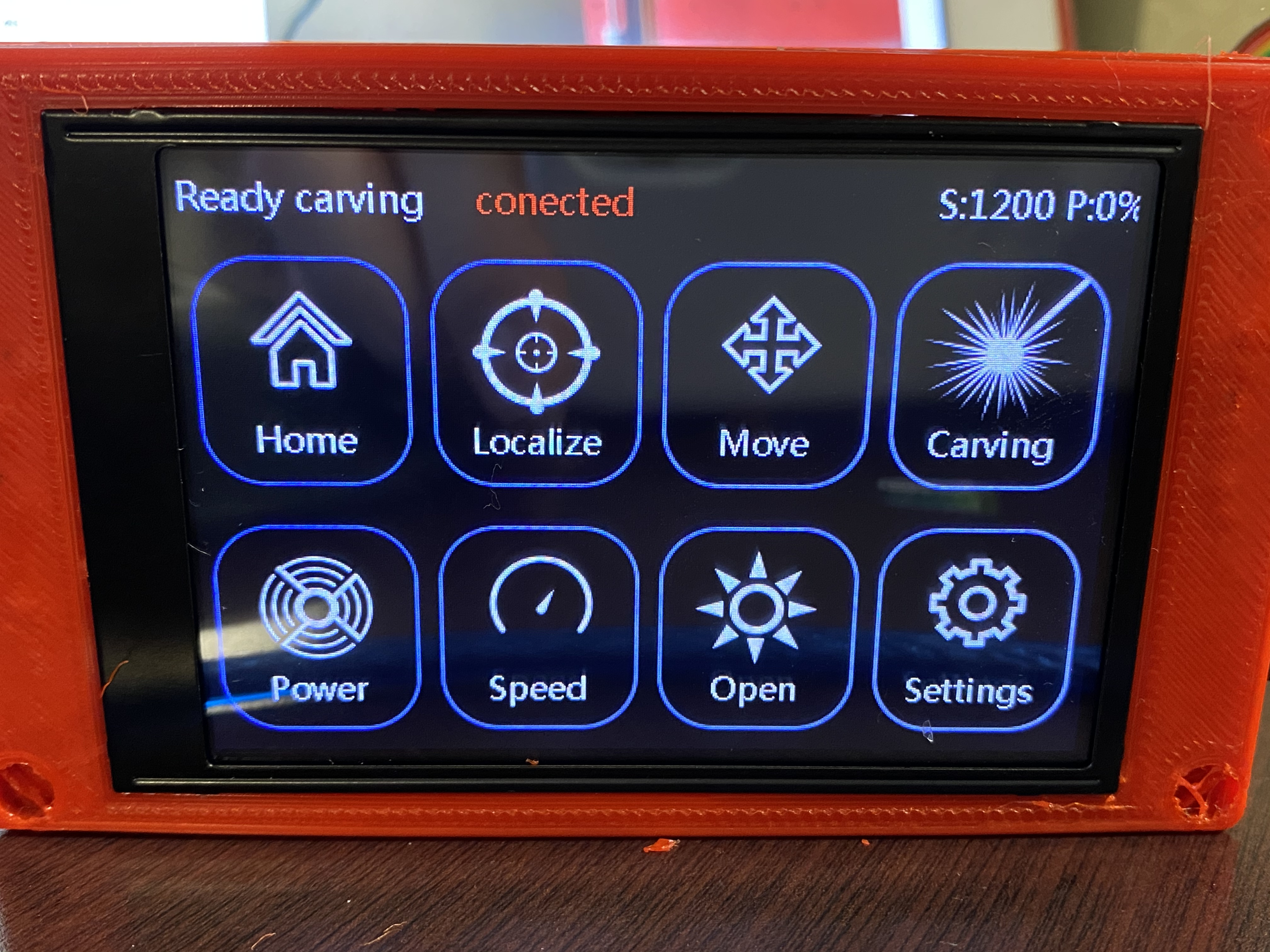

I was able to get grbl version 1.1g loaded on it via OpenBuilds Control. @Eclsnowman pointed me in the right direction to update the firmware. I think this is the latest version.
I might need to find a case or design one that will hold the board and display.

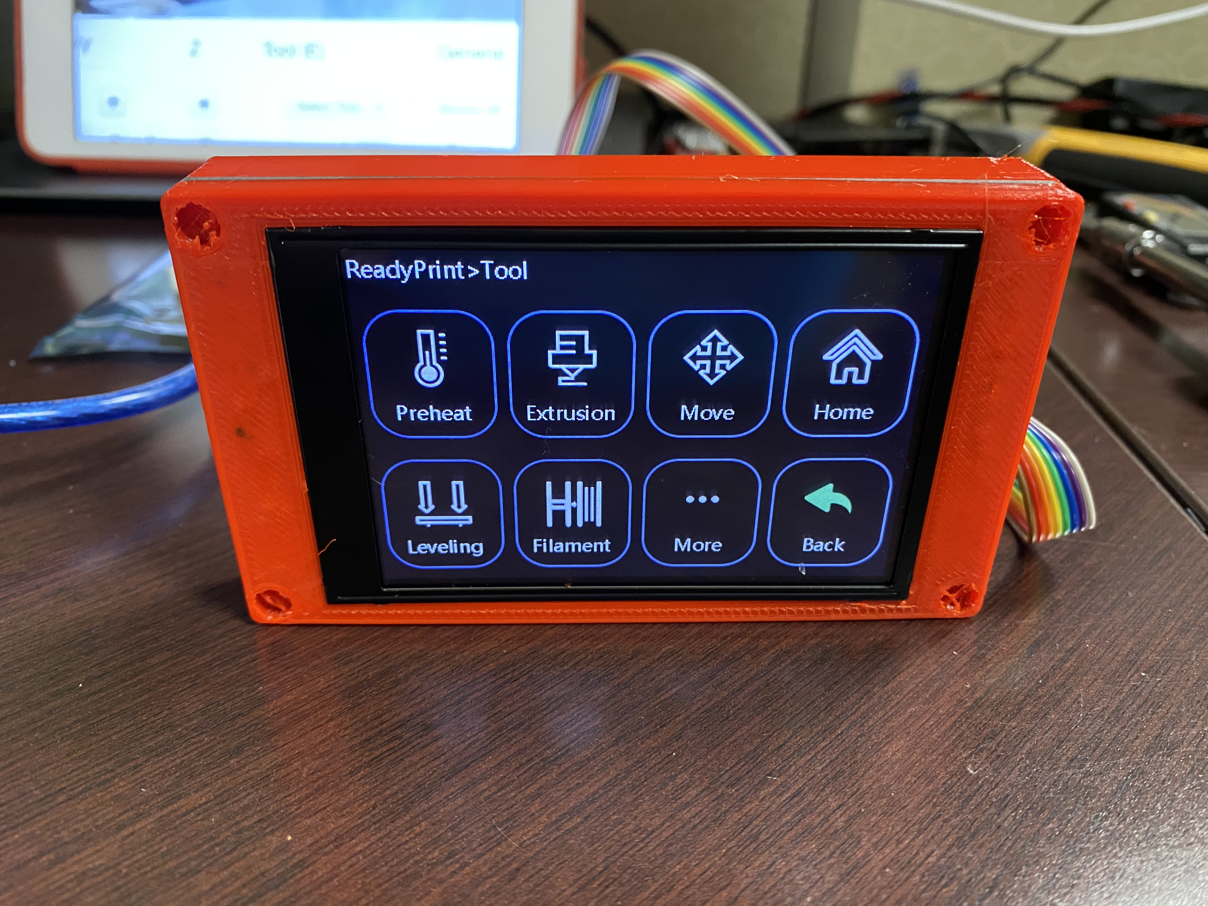

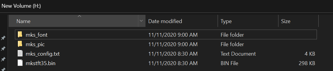

I think for running the CNC, you want to use this particular firmware for the screen. It has screens set up more specifically for CNC applications.
Thanks. I will try it out tomorrow.

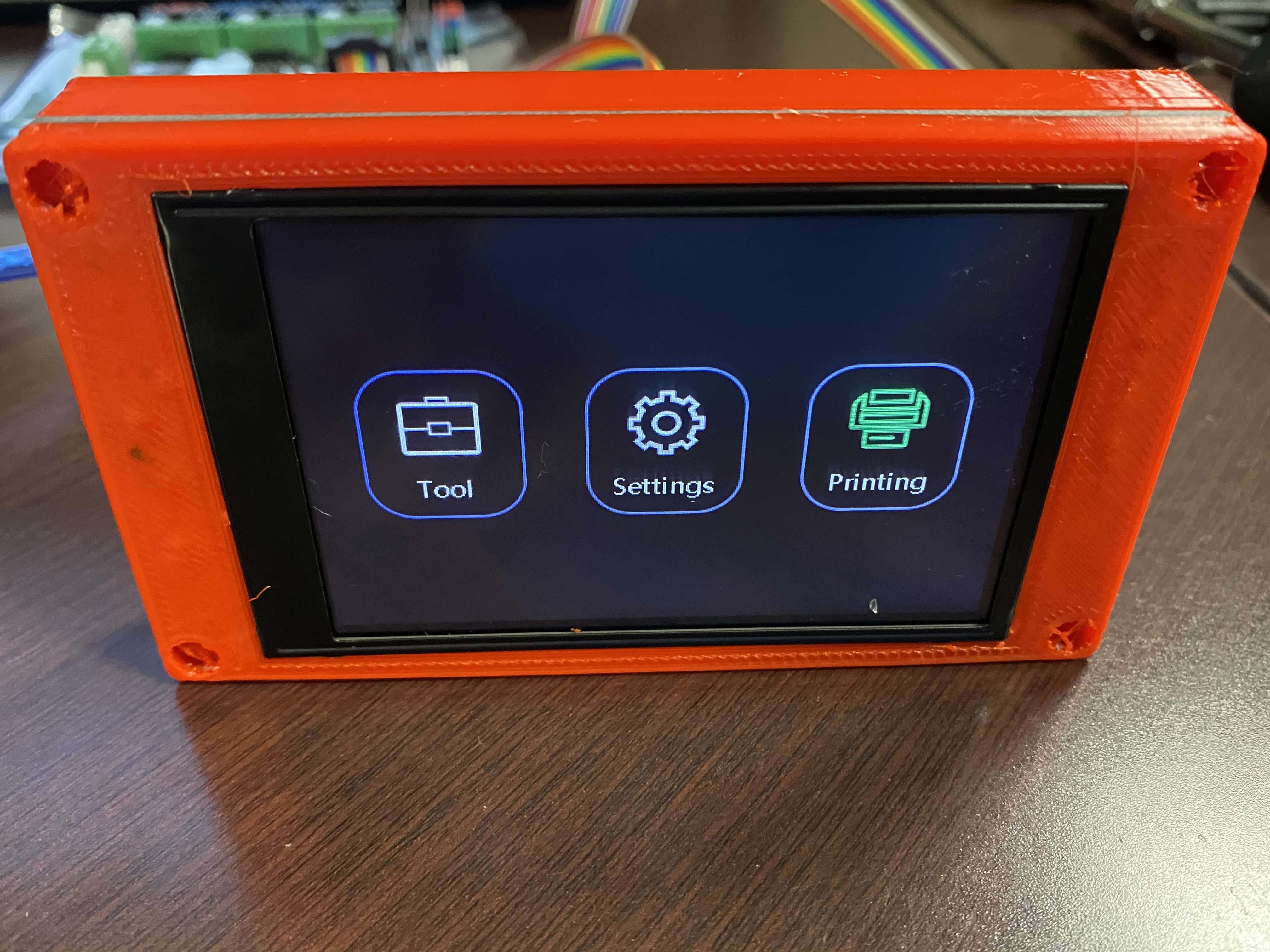

With these files loaded on the SD card, I plug in my MKS DLC V2.0 via USB for power and the TFT shows the booting screen and then Makerbase logo. It doesn’t try to update the firmware.
I tried it again with a 16GB SD card.
The instructions look like they have an editing mistake though, they suggest the “24” variant for all sizes which can’t be right…
I don’t see anything wrong in your screenshot :confused:
Oh yeah, I see that now. Looked right over that.

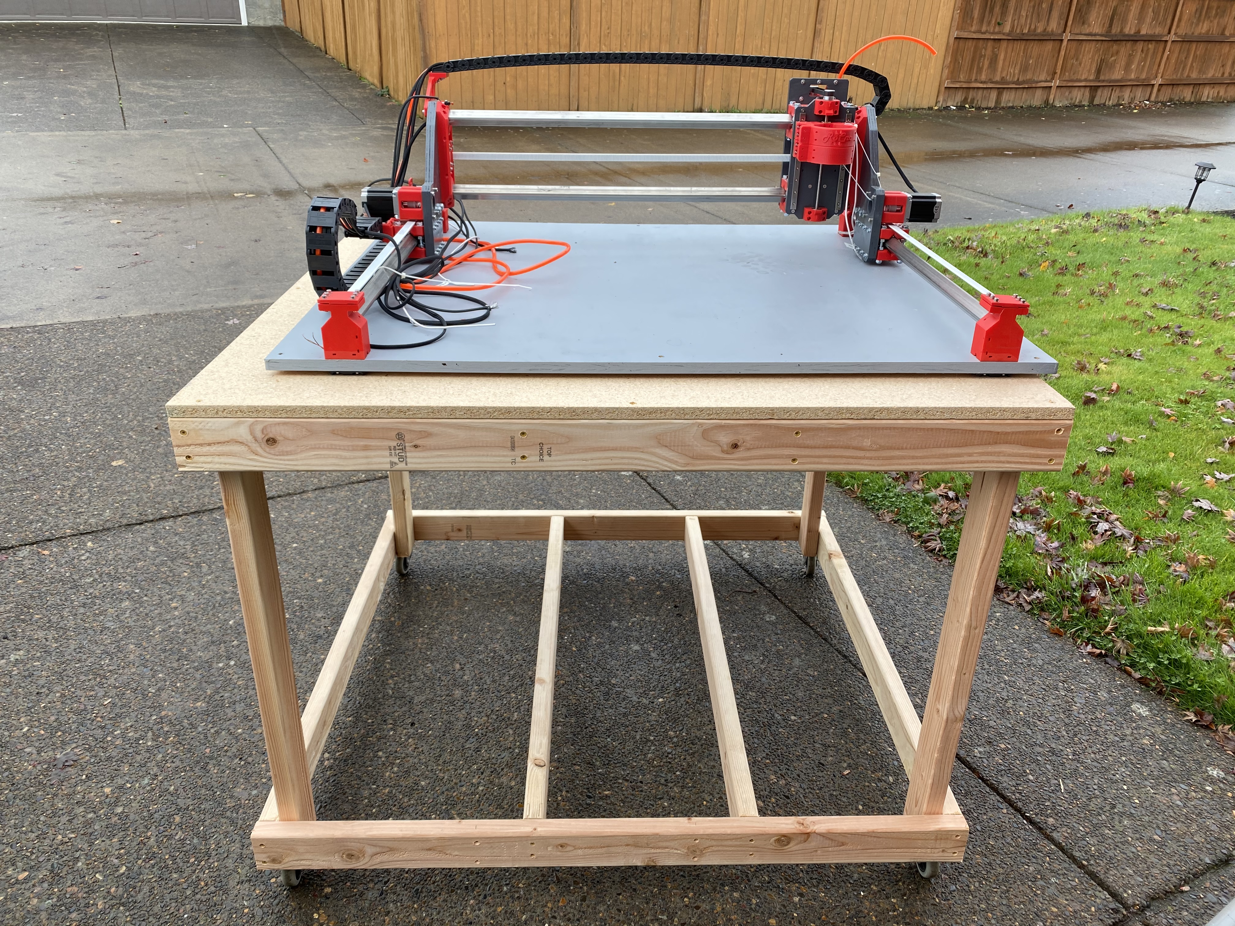

Making some progress on my enclosure. Might have made it too tall at 40 inches. I forgot about the height of the wheels.
