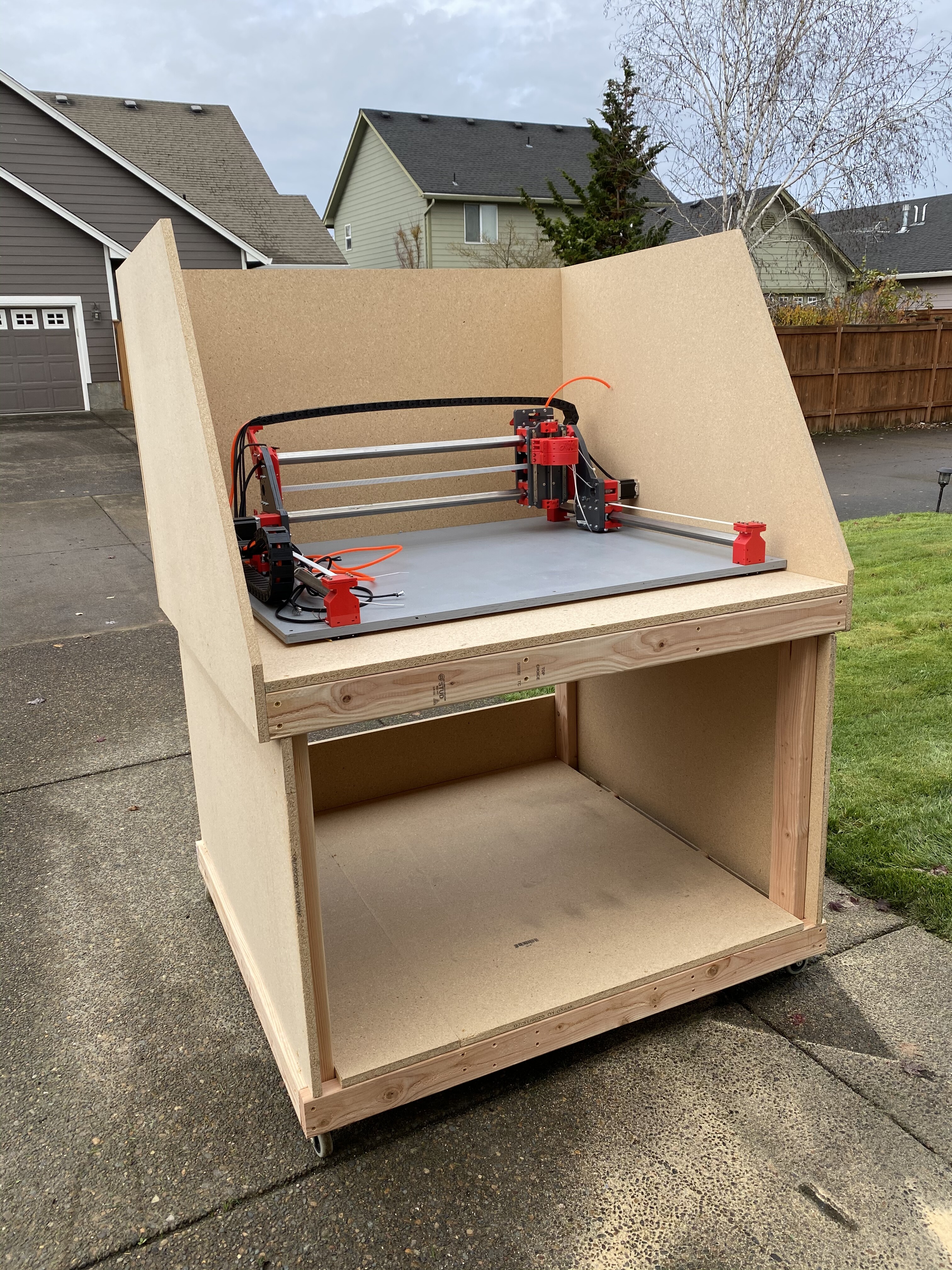

I was at first dismayed with how tall I made the table for my OX, but shortly after I started using it I changed my mind and was super glad I made it tall. Zero bending over to look at things closely. 2¢
You might want to think about a built in lift so it can sit more solid when running.
I will need to find something for it to rest. Although with a few sheets of 3/4" particle board it has added quite a bit of weight to it. I see I don’t have enough particle board still. Unfortunately it’s wider than a sheet of particle board so it is taking more than normal.
I just need the top and front and should be close to having it enclosed. I’m going to cut a hole in the front and put in some plexiglass. I need to find some plexiglass still.

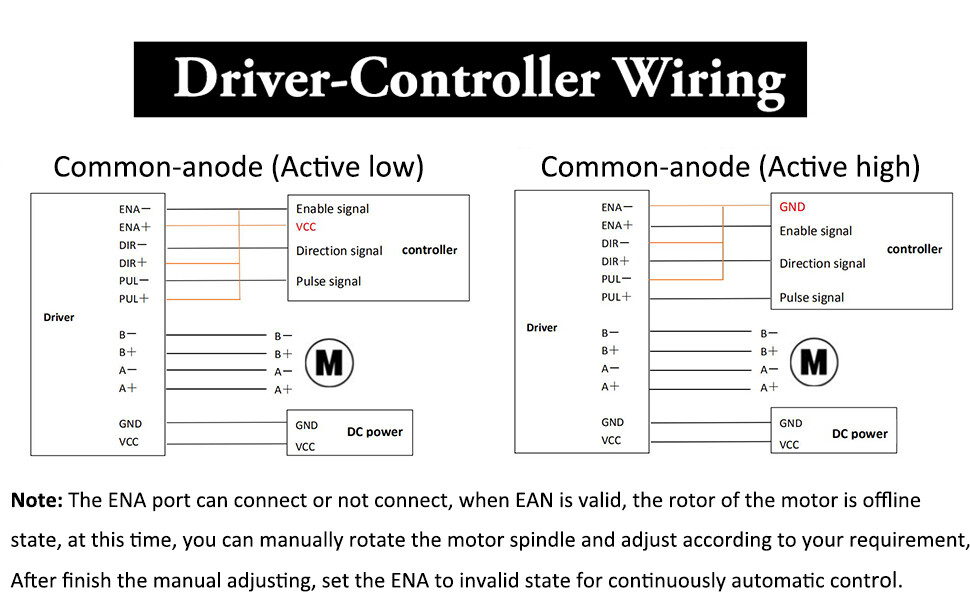

I’m assuming I should be wiring this “Active high”?
I have an alarm and power light on the TB stepper driver.
I noticed on the display I don’t have the option to move the Z Axis.
It was getting late but I don’t have any movement yet with it wired “active high” 2A. I’m also not sure about the subdivision. I have it set to 16 currently.
I’d go with “Active low” as they call it here. Obviously don’t connect VCC to the enasble signal as they have kind of drawn it.
But they call both positive supplies “VCC” which is very very wrong. Use logic level for the signal, and separate motor supply for the motor. The two should be independent. You don’t want to put 24V or so into logic ports on your board. :slight_smile:
16 “subdivision” microstepping is fine. Below 8 will probably sound like it is grinding itself to death. The more microsteps (the larger the “subdivision”) the lower the torque, all other things being equal. If you have problems with motor torque, you could consider going to 36V for the motors.
Yeah, with the way they have it shown you might get confused and send 24 volts into the ground pin of your DLC board which is not advisable :slight_smile:
Instead you want to use the enable signal on the DLC for that driver. 4wires: Step, direction, enable, gnd.
It looks like from the pictures the signal order on the board is left to right = enable, step, dir, gnd:
That’s the logic level controls from the DLC shown in a box in the upper right of that diagram external driver diagram you provided.
Then in the middle section you see the wiring from the external driver to the stepper motor obviously.
Below that you see the power in and Gnd from the power supply.
That’s why it’s broken up into three sections, it’s the wiring to the three different components that the external driver needs to connect to. Don’t cross the streams :slight_smile:
Does this look right?
TB6600 DLC
Enable - Enable
Enable + Ground
Direction - Direction
Direction + Ground
Pulse - Step
Pulse + Ground
Personally I think the active high layout is how I would do it. But again I haven’t used this board or driver combination before, and I am no electrical guru.
So for that:
TB6600 = DLC
Enable- = DLC Ground
Enable+ = DLC Enable
Direction- = DLC Ground
Direction+ = DLC Direction
Pulse - = DLC Ground
Pulse + = DLC Step
That is how I have it wired but I don’t have any movement for Z axis.
When powered on the TB6600 had the red power light and green alarm light on. Normal activity? I’ve verified the A and B motors are correct using the ohms meter.

Looking over the Cohesion3D site using the TB6600 for a laser rotary axis on thier board, they have it setup 5+ to all the + pins, and the “-” side to the pins.
Link: https://cohesion3d.freshdesk.com/support/solutions/articles/5000744633-wiring-a-z-table-and-rotary-step-by-step-instructions
So for that setup:
TB6600 = DLC
Enable- = DLC Enable
Enable+ = 5+ from DLC Board
Direction- = DLC Direction
Direction+ = 5+ from DLC Board
Pulse - = DLC Step
Pulse + = 5+ from DLC Board

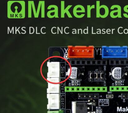

For supplying the 5V:
Thank you both! I have a moving Z axis. Yay!!
Can I loop the 5 volts through all 4 stepper drivers?
You can share the same 5V supply for all 4 stepper drivers, yes.
You are basically just driving an LED for each of the 12 lines. Each of the three lines to each of the four stepper drivers is “opto-isolated” meaning that you are driving an LED inside a package, and the high-voltage (motor) side then uses a photodiode to tell whether the LED is lit. The LED is turned on by connecting the port to GND, and the current is limited by the resistor of the opto-isolator to a level that doesn’t hurt the chip. So all that 5V power supply is doing is lighting up as many as 12 LEDs at once.
