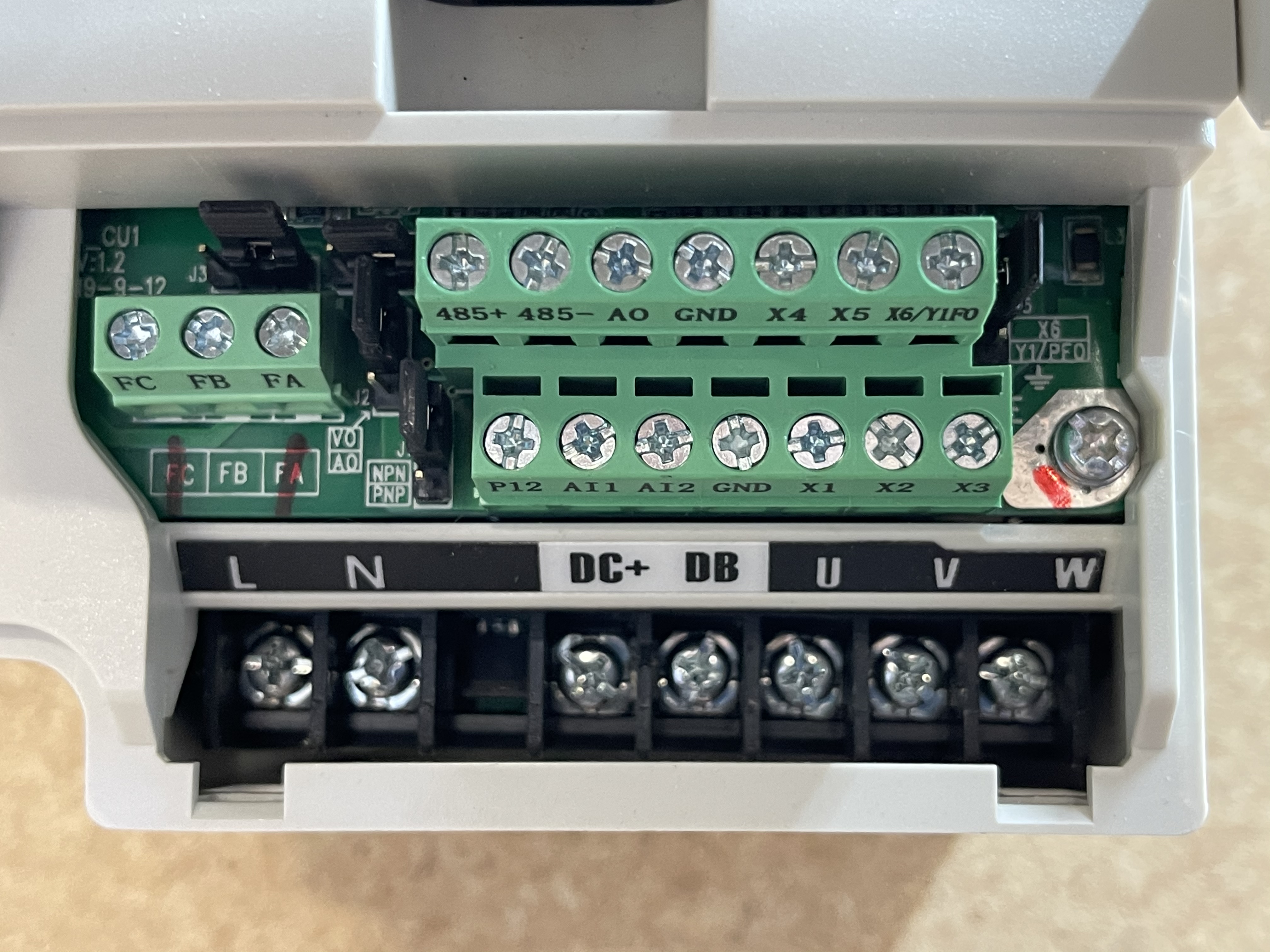

I need to wire this up to 220V. I’d like to get it right the first time. :exploding_head:I don’t normally wire anything up to 220V. I will have a ground, neutral, and two hots right? Where do I lay all of those 4 wires down here? What size wire will I and breaker will I need?

The wiring from the inverter to the spindle seems to be shown below:

I don’t see a terminal labeled “PE” in your picture, but the big screw on the right side of the circuit board with the red mark next to it looks like it is meant for the PE connection. (I would have expected it to have been a screw terminal on the bottom row but I guess they cheaped out on that.) Don’t just screw a wire into that; use a crimped ring (or spade) terminal. You’ll have two terminals because you’ll also be running a wire to the ground connection on your spindle from the same screw.
Use ferrules for all the other wires that go into both styles of connector otherwise to protect against wires breaking.

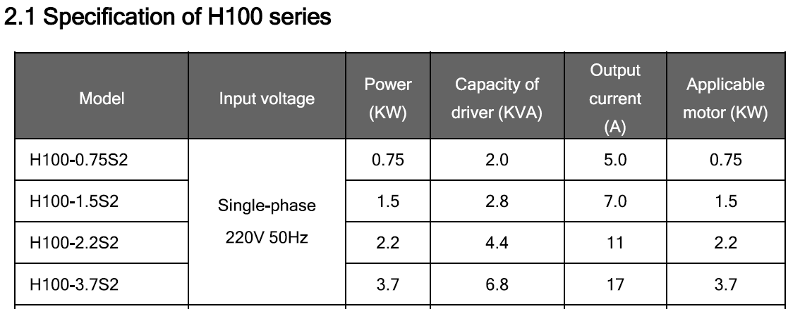

Looks like the output current is 17A. (Not sure on the model I have at the moment)

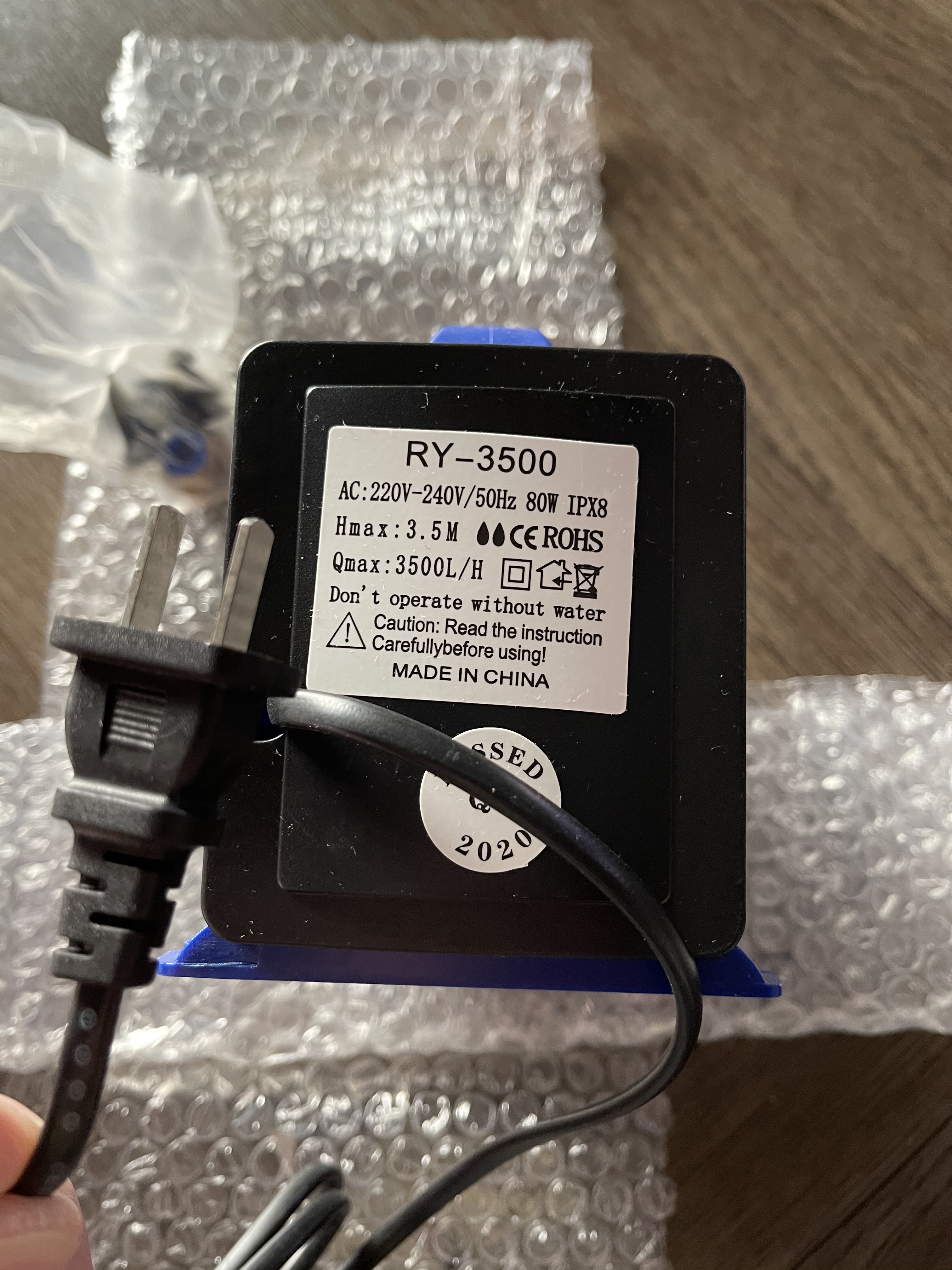

Well crap I was thinking the water pump was just a standard 110V pump but it is 220V.

Your aliexpress link was to the 2.2kW unit and there it says 10A. Here it says 11A. Either way 20A is going to give you plenty of headroom.

This can’t really be 220 volts can it?
Well, it’s clearly the wrong plug for 240V in the US. The question is whether it can run on 120V or simply has the wrong plug. Have you asked the vendor? I’ve had multiple good experiences asking questions of vendors on aliexpress. But I’d just put the right plug for 240V on it. I’d use a NEMA 2-15; it’s cheap. That’s what I used for the CW-3000. Here’s a reference to some standard plug types:

Incidentally, “Don’t operate without water” is better English than the label “Forbidden to anhydrous boot” on my CW-3000, but slightly less funny! :wink:
I did ask the question with the seller but it’s the weekend there. Don’t tell anyone I ran it on 110V’s for about 5 seconds without water… :innocent:
I will get that plug and outlet you referenced. I get really nervous hooking up a 220 volt outlet that would accept any standard 110V plug.
I think it would be a really, really bad idea to wire 240V to a 120V outlet. It’s against code for good reason. It’s nuts that they shipped it with that unless it really runs fine on 120V as well, which it might. It might support a lower head but you probably don’t need 3.5 meters of lift anyway; if it can support one meter or so of lift on 120V you are probably OK. That said, running it on 240V behind the e-stop for your spindle give you an easy way to stop everything if you spring a leak, limiting damage. So I’d definitely go for 240V anyway.

Although it is only rated for 10A. It looks like my H100-2.2S2 has an output current of 11A. I like being able to lay down all the wires and then passing them back out to the water pump and inverter/spindle. Should I search for a 15A emergency stop?
