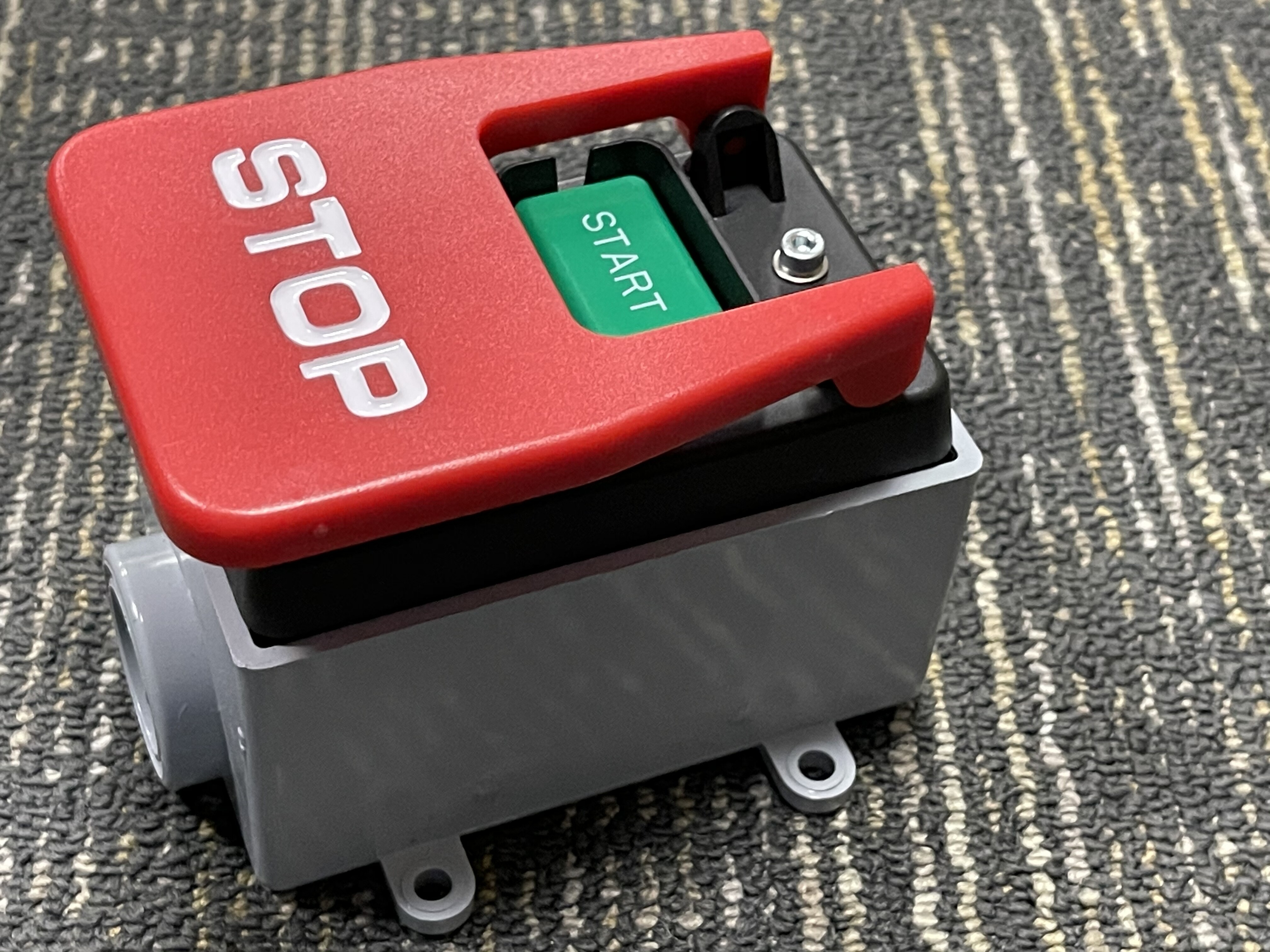

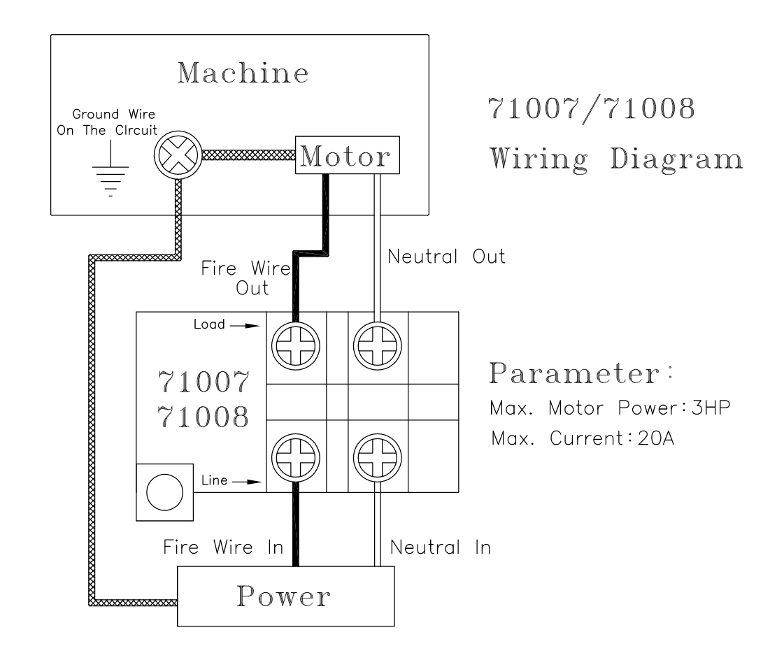

That looks like a great choice; clearly meant to make it easy to press stop and only press go intentionally. It’s meant to fit into standard deep outlet boxes but if I understand right doesn’t need to be put in a box at all if you don’t want to? That would be convenient!
I don’t see specifications saying that it’s dual-pole, but at least the wiring diagram looks like it should be since they run both hot and neutral (which in your case would be L1 and L2, both hot) through switch terminals, and if it were only single pole they would be just on hot and not connecting neutral to the switch.
Almost ready to try this out this weekend. This feels like it’s made with quality parts. It has some weight to it. I was able to get it mounted on my surface mount box with some extra spacers between the switch and outlet box:

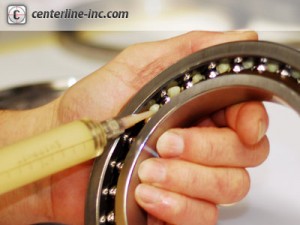

Spindle in the preservation and transportation, high-speed grease inside the bearing state will change, customers should be running at low speed for 30 minutes. 3000 rpm and then follow the poor increase, run 20 minutes each.
Wow, those break-in instructions are something special. “follow the poor increase” indeed. Here’s some other instructions that look like they might be useful.
I’m seeing a lot of references saying that after transport, you should always do a grease distribution process like this. I didn’t know that while spinning up my spindle. But they say that a bearing “crashing” into a glob of grease at high speed can cause bearing/race damage. Some say to run it alternatively forward and backward at each speed.
I think I have something to do before I do any more cuts with my new spindle! :relaxed:

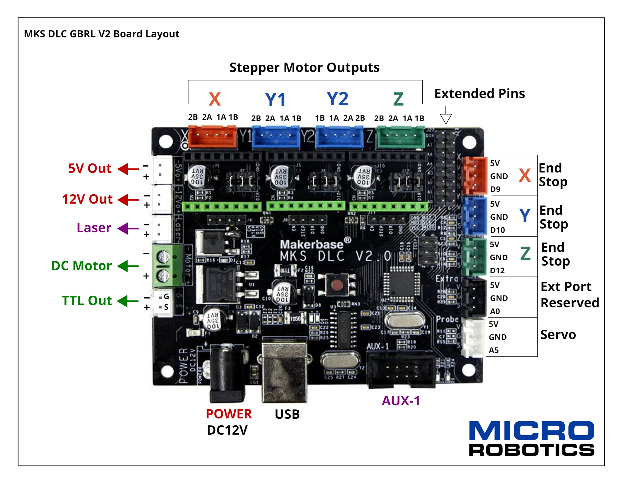

What settings do I need setup for limit switches. I’m using the no, nc, and common end stops. Looking at the diagram below they have D9, D10, and D12 for X,Y, and Z.
I don’t believe I’m hooking up anything to the 5V pin. What needs to be done in Openbuilds and/or GRBL to enable these end stops?
Ignore the 5V line, yes. You can choose a NO or a NC configuration, you just need to use the same configuration for all the end stops. Connect to common and to either NO or NC. I’ve seen people argue both ways. Regardless, the $5 parameters tells grbl whether you chose NO or NC. If it doesn’t work, invert it… :relaxed:

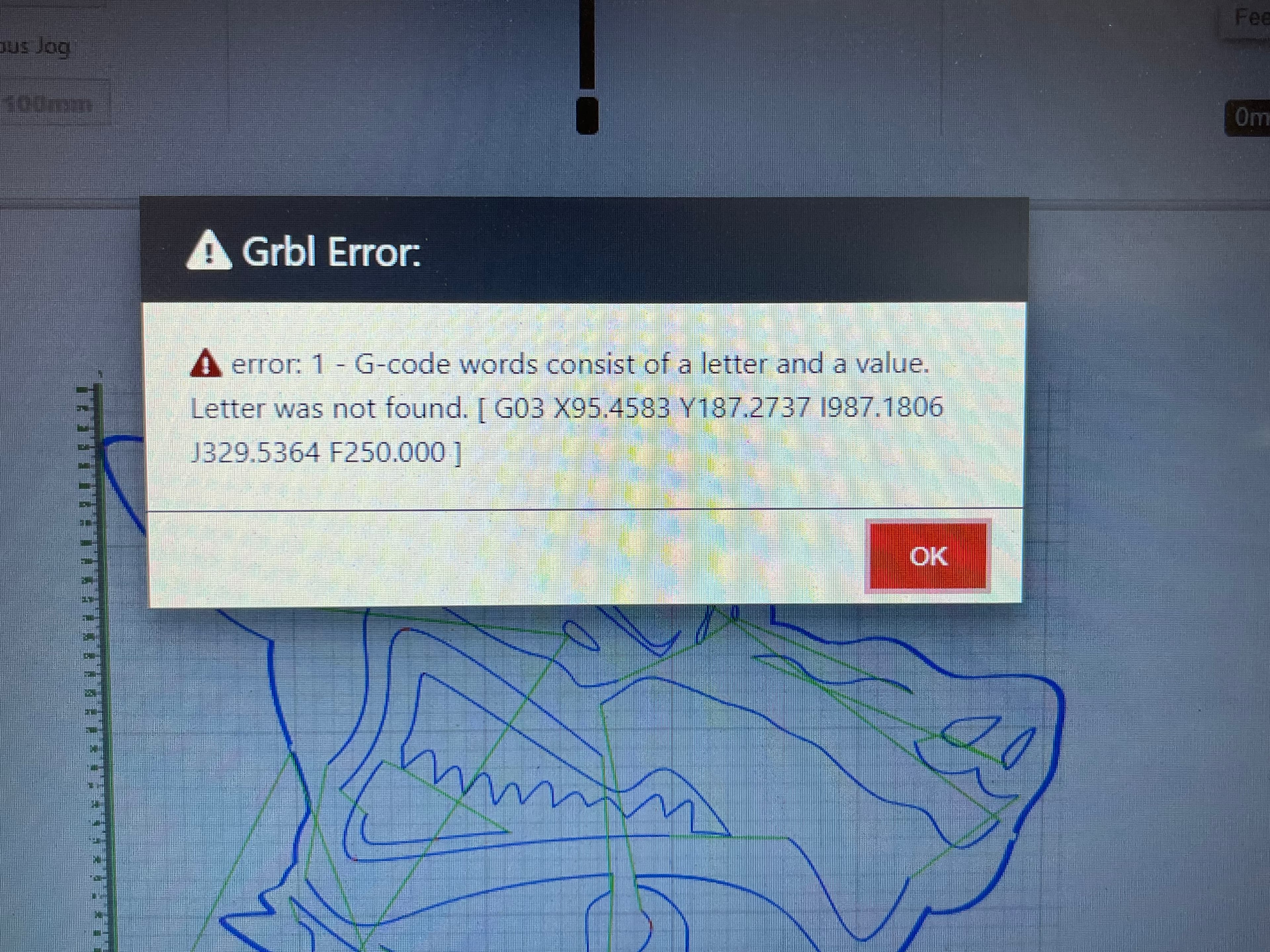

OpenBuilds Control: I seem to get this error often:
At least it wasn’t a total failure. It just didn’t cut the part out:
I occasionally had errors with Candle that didn’t happen when I used UGS, and what you display rings a bell. Never tried OpenBuilds Control.
Are you creating this in the open build software, or doing it in another software and post processing it for Grbl?
