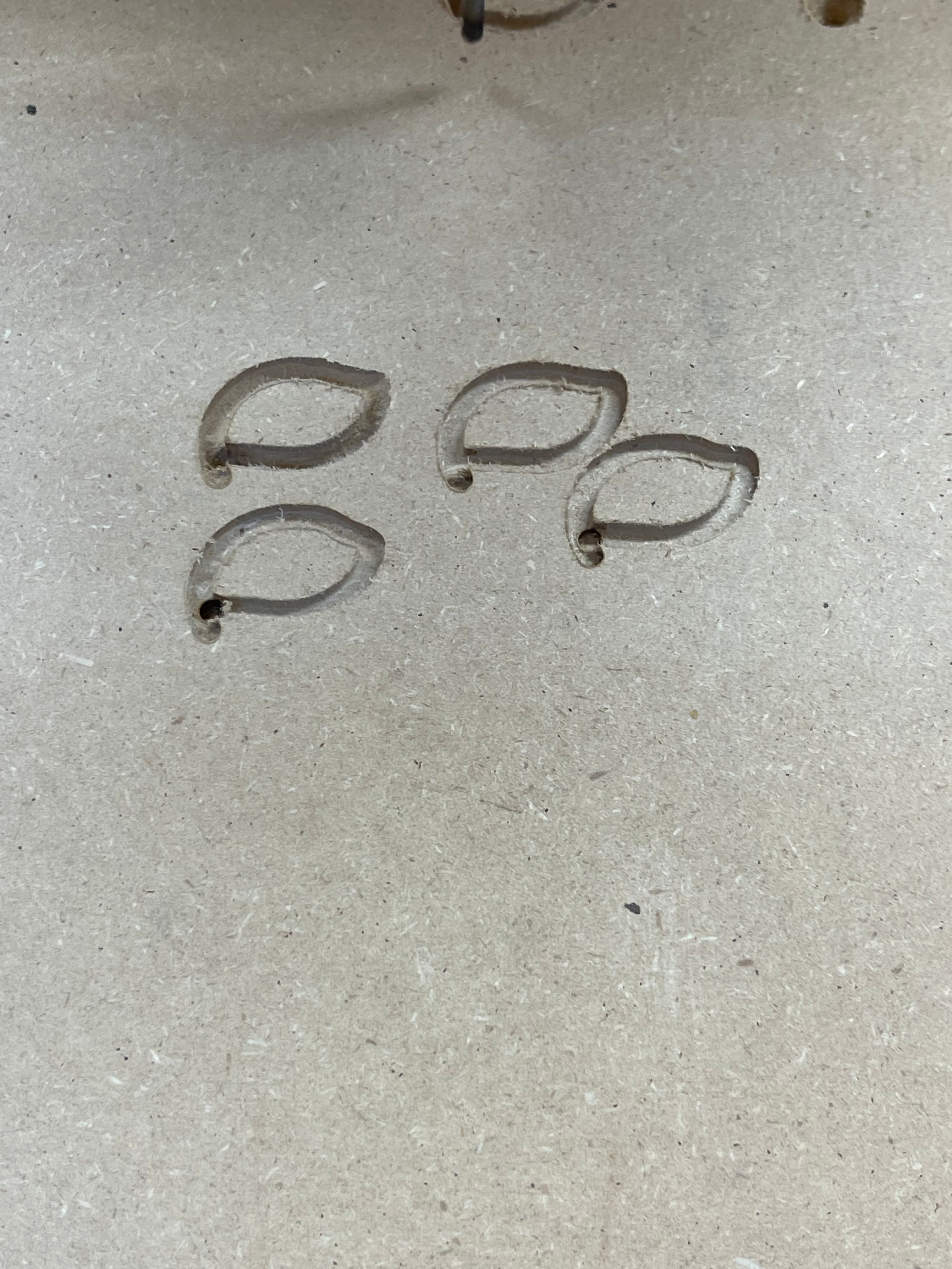

I used Estlcam software and then exported it as a .nc file. I then imported it into OpenBuilds Control.
Is the etslcam setup properly for Grbl exports? Looks like googling that error code it has to do with improper formatting for Grbl. Does Grbl take G03 arc codes properly… Or formatted in that way?

Still making ovals instead of circles. I’m stumped!
Does it do the same thing if you air cut? Use it as a crazy plotter and draw with a sharpie? If you feed at half the speed, does it change shape at all?
Yes it does it mid air. You can see it stop halfway through the circle and then finish the rest.

Yes it does the same thing at 100mm/s. Just makes lemons.

I feel like the issue is with Estlcam. Once I made the change to the arc option it all went to hell. But with the gcode imported into OpenBuilds Control it shows it making a circle but it is definitely not cutting one mid air. I’ve thought about swapping one of the TB6600 to see if that helps.
Unlikely to be Estlcam especially if the sender shows a circle.
The fact that the circles all look the same and there is relatively smooth travel in each axis makes me doubt the stepper drivers are at fault.
This is why I keep recommending testing UGS. It is really common for gcode senders to not merely send gcode, but also translate between dialects. It is my understanding that UGS does a good job of this.
Lots of 8-bit firmware doesn’t even implement arc (G2 and G3) at all. Converting them to segments bloats the gcode but if it is done in the sender, then the sender can make a difference by managing the queue well. It can be the difference between stalling and running smooth.
once I saw that this problem showed up once the CAM software was changed to generate arcs(G2/G3) it sure sounds like the firmware isn’t implementing the arcs correctly. This would explain why the simulators or even the sender might show a circle and the execution by the machine is different. Michael makes a good point of another issue could also be way too many segments flooding the firmware buffer.
You can look at the gcode to see if it’s sending G2/G3 gcode or lots of segments. And just turn off the arc support in the CAM and run the gcode in the air to validate it is the arc command. You can also lookup if the version of GRBL supports arcs. IIRC GRBL 1.1f does but you should verify.
